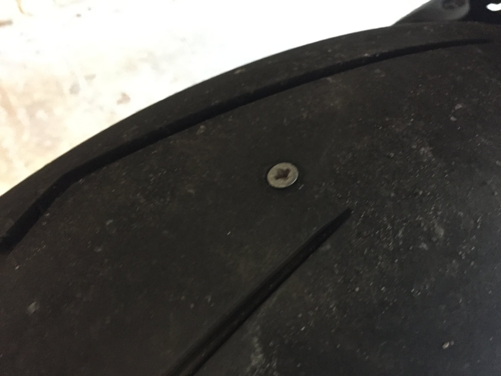

  1. Perhaps the last sunny day of year. New Super Corsas with 200 miles on them.
    Fireblade rides pulls alongside whilst waiting at the lights and lets me know what he can see a screw in my rear tyre....

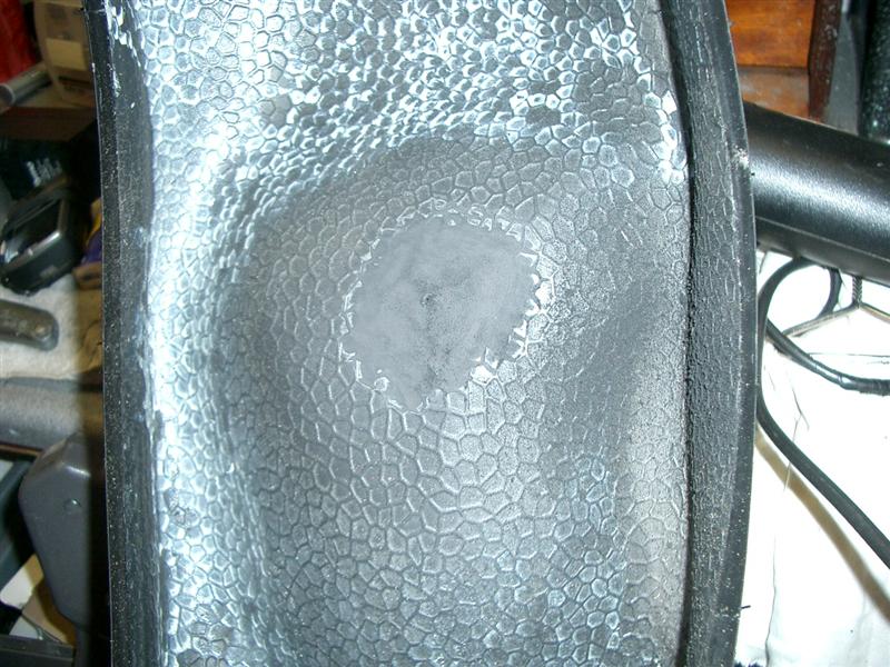

  18. One I did earlier, my mate had to use some emergency tyre seal to get him home, there wasn't a lot in the tyre when I took it off.

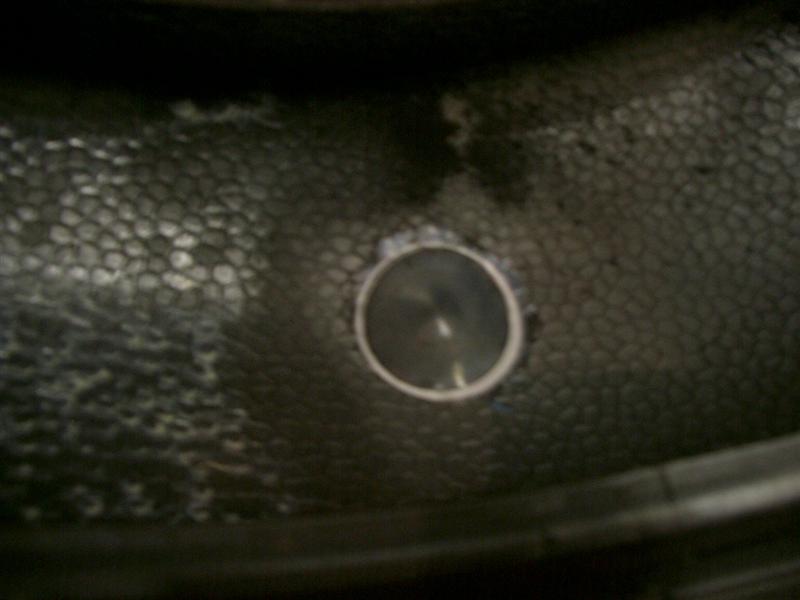

    I then smoothed off the surface with a powerfile so the mushroom head would glue better :-

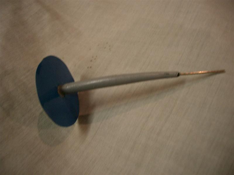

    Mushroom patch I fitted, wire at rhs goes through the hole from inside of tyre, peel the blue plastic backing off, cover with rubber solution, leave till tacky and pull the whole thing through tyre into position.
    Not the most in focus pic of the finished job, but you get the idea, done this lots of times now and my mate did about another 4,000 miles on this tyre, better than throwing it away.
