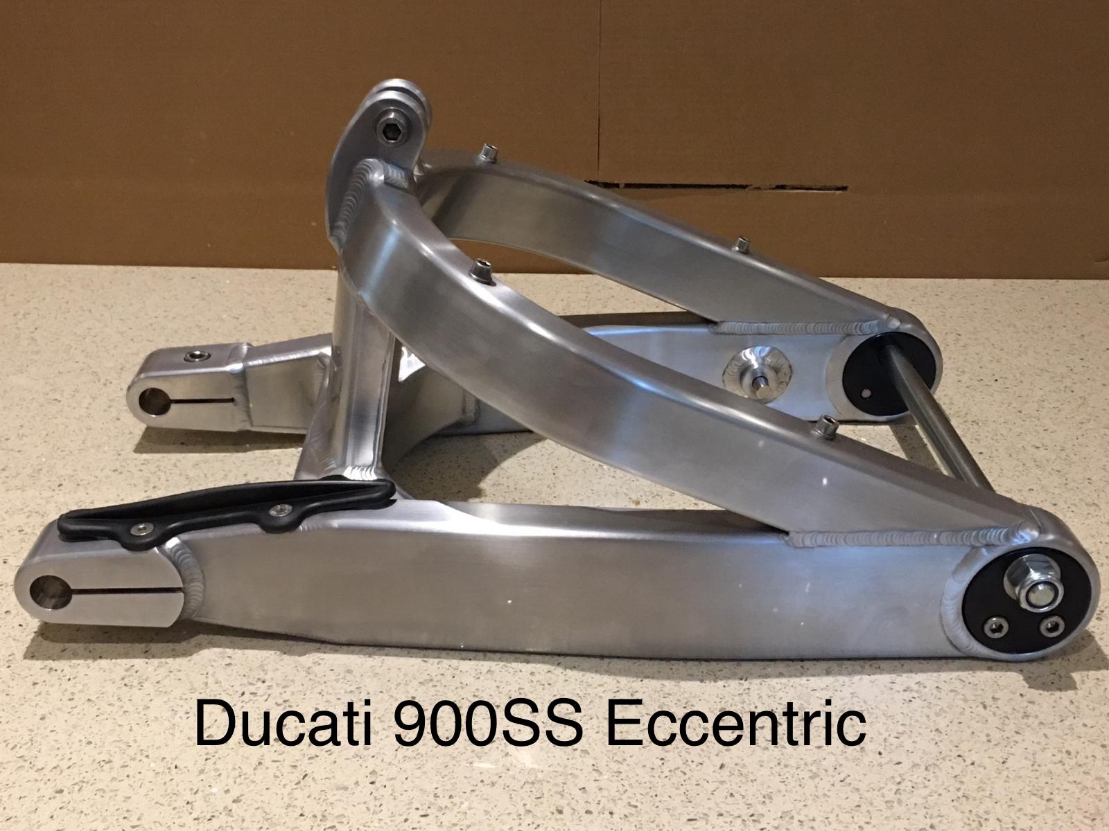

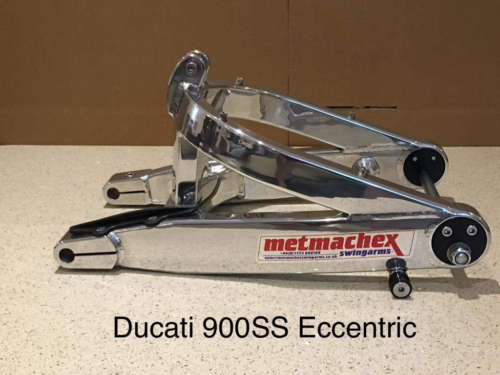

  10. Thanks for the tip Edge_of_Town. Now, brushed or shiny...

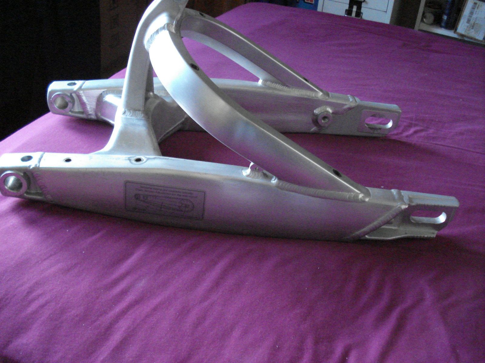

  11. I'm seriously considering it but would probably go for brushed rather than bling. Too much polishing required, prefer the understated. If you do get yours please report back with fitting experience. What year is your SS ie?

  13. SHINY................all day SHINY .............
