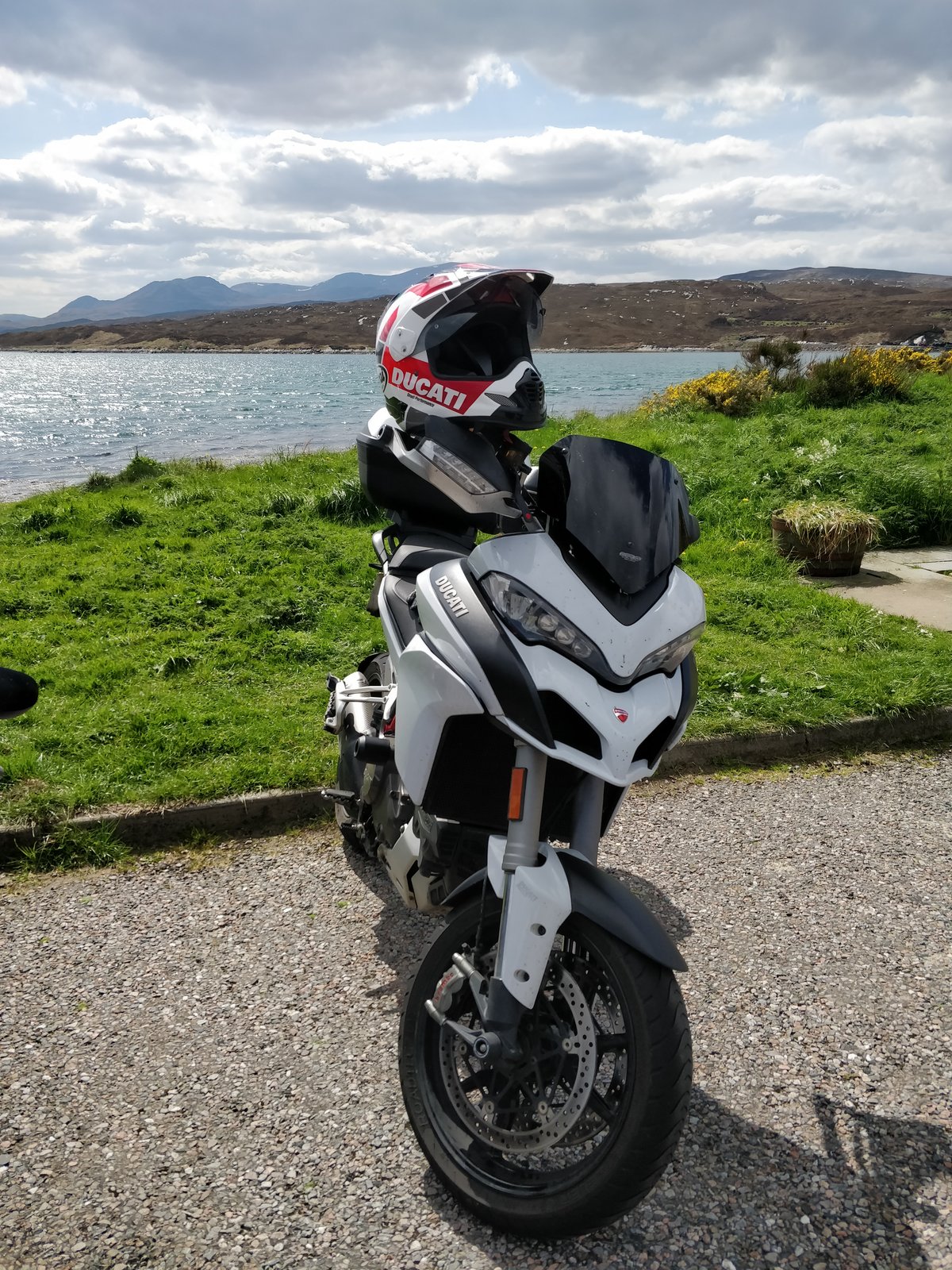

  8. I've gone through the following screens on my 2015 DVT:
    Calsci short.
    MRA Vario
    Puig short racing.
    Puig touring.
    MRA Short.
    I've settled on the MRA short at the upper setting. I use an Arai Tour x4. My seat is set to the upper setting, and I;m 5'8, and I use earplugs (DesignGO).
    I've sold the MRA Varion, but may give the others a try again. I'd like to try the Ducati PP one, but I dont really want to part with the money!
