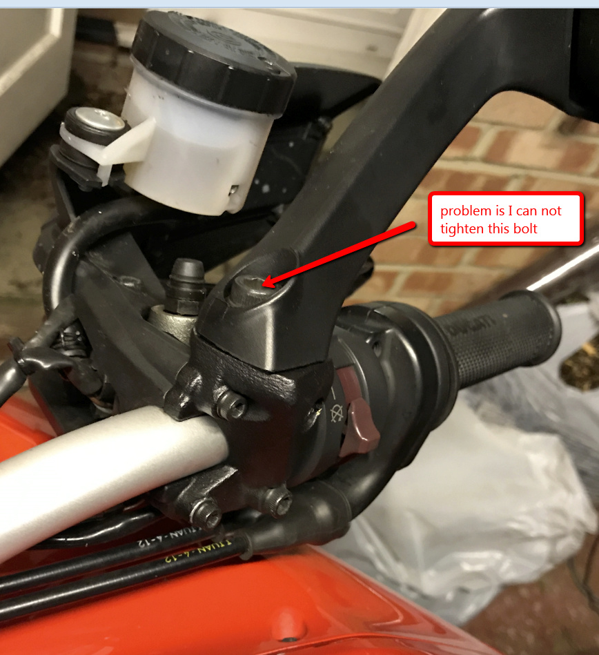

  1. My basic problem is I can't tighten the bolt that holds one of the wing mirrors.
    I am a novice at spannering and I didn't know the 8mm hex bolts that hold the wing mirrors are left hand thread.
    When I went to remove the mirrors I was tightening and stripped the first one, before I realised my mistake.

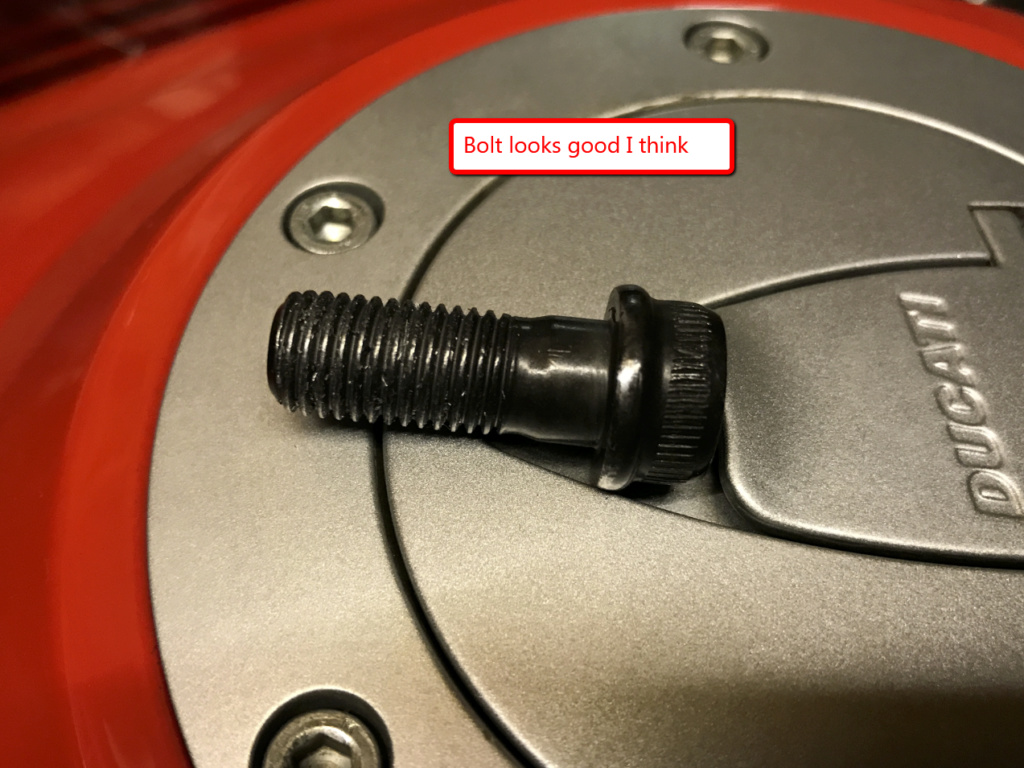

    Now I am trying to fix this and I've got about as far as I can myself.
    I have determined the bolt is OK and its size is M10x1.25
    I have seen thread repair kits demonstrated on youtube and I thought I would get one (helicoil), but, all the ones I can see on Amazon at least, are all right hand thread.
    Is this a common mistake to make?
    What is my best option?

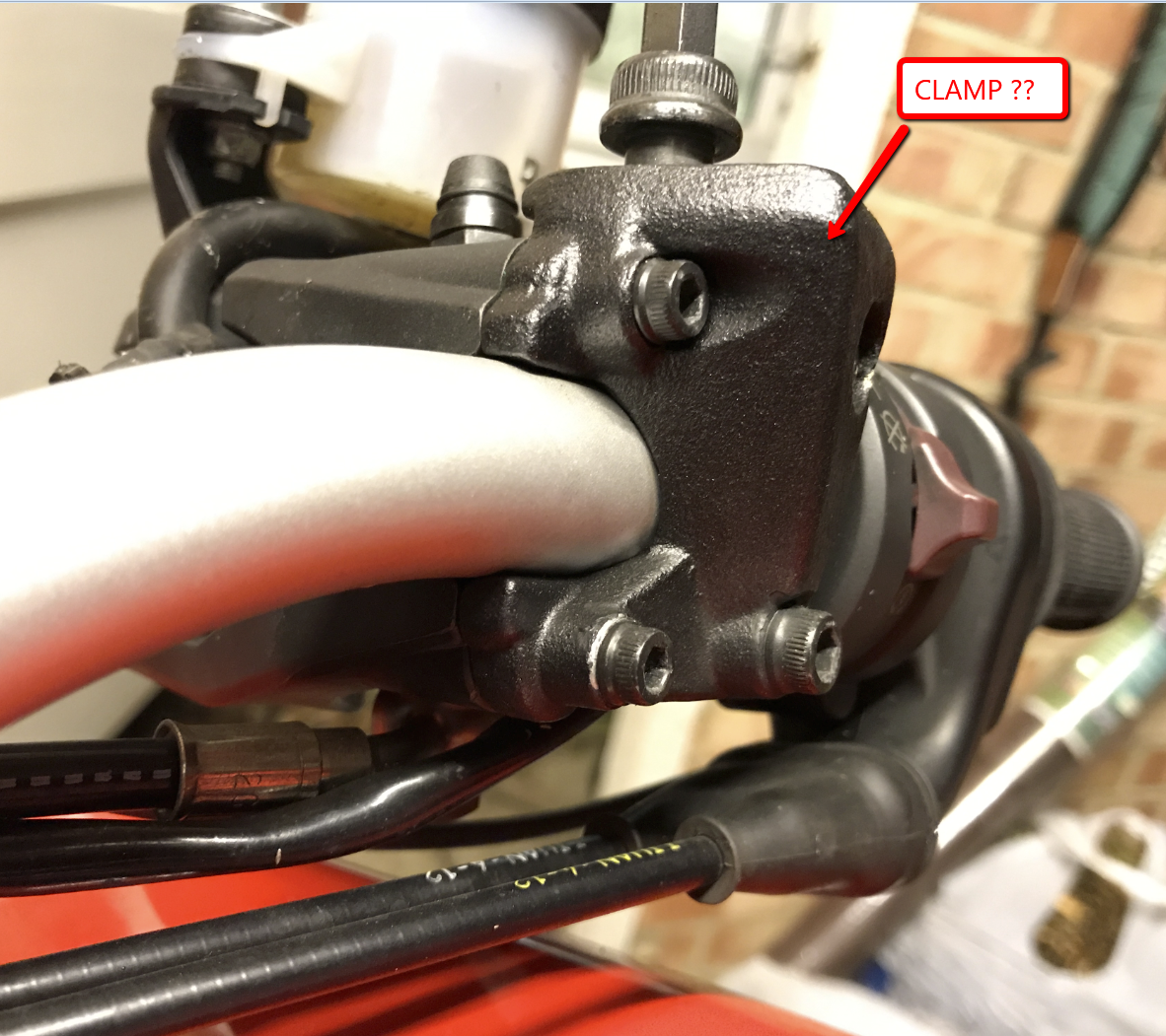

    Is this the clamp?
  4. Yeah I thought it would be crazy money as well! If it was a more common size bolt I’d say get yourself a helicoil set, but can’t imagine you’d need a m10 LH helicoil any time soon if ever again :p
