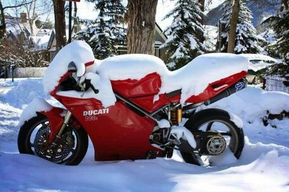

  14. Some people just don't seem to worry...
  15. I'd put the wife out before that.
  16. Bet you're popular at home. :)
  17. Not often. ;)
