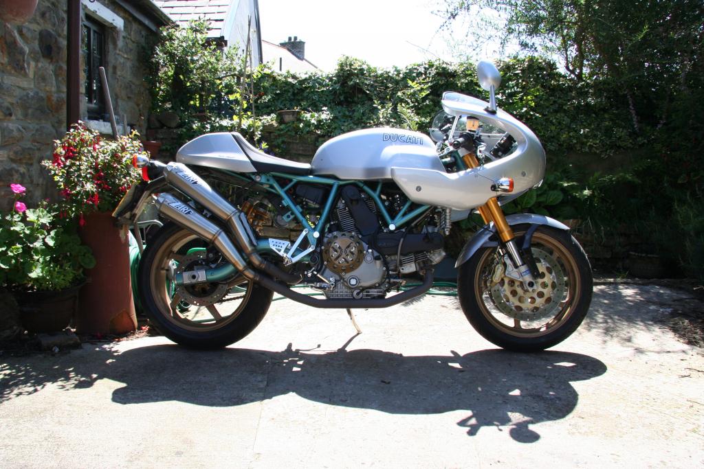

  7. I used to run Monster S4 5 spoke wheels on my old PS sport classic. There was no machining needed, all I did was use the same brake discs and brake callipers that came with the wheels and the spacers /sprocket carrier that came with the SC. So the reverse should in theory work for Monster (note will need to be same axle diameters as the S4 monster) or to put it another way SC wheels discs and brake callipers with monster spacers/sprocket carrier. another limitation is it would need to be an electric speedo pickup version as the SC wheels don't have the speedo drive, though creative parts swapping of bits may fix that too. IMG_1121.jpg
