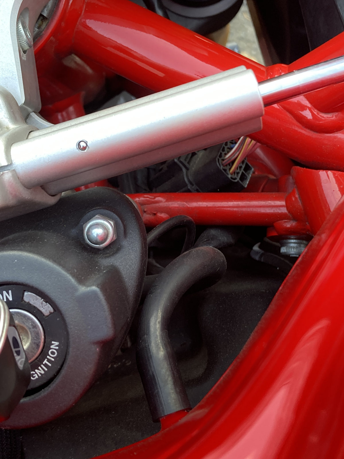

    Just noticed this wiring loom which goes into the junction box. Should this be covered up? It's on a 749
  2. If you look down the wires into the back of the plug you'll probably find some red or yellow rubber bungs around the cable itself. They seal the plug from water ingress. I don't like the look of those either. On mine, some have extra rubber boots and some don't. I got some new boots from China and I'm slowly de-pinning all the connectors to install new or extra boots.
  3. Jet, that looks like the RH switch connector block, it is shown in the factory service manual wiring arrangement photos as unsealed on the backs of the connector, there are a few like that in the headstock area. Whether they need sealing is debateable as sealing a connector that is designed to be open can trap water (unless it is very carefully done) and cause corrosion as the water can't evaporate out.
    You can download the manual from this post https://www.ducatiforum.co.uk/threads/free-ducati-owner-workshop-manuals.593/page-7#post-1309624 and check out the photos in section P1
