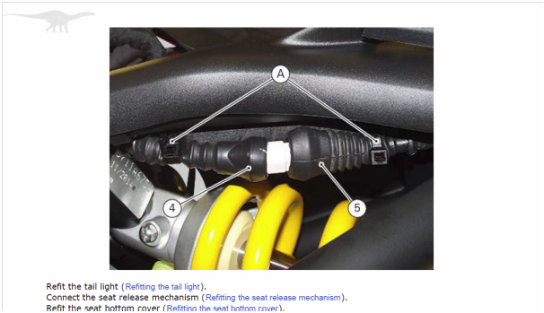

  19. Solved - The problem was corrosion on the connector to the rear subframe wiring (Part 64 on the wiring diagram in the manual).
    Bolds, I think that this is the part you were telling me to check but I looked at a smaller white connector under the seat. Thanks for your help you are a star:upyeah:
    Found it eventually by just pushing and pulling on the wiring from the Black Box and noticing pressure canceled some of the issues out.
