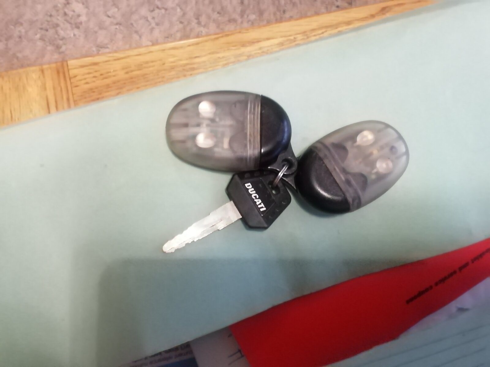

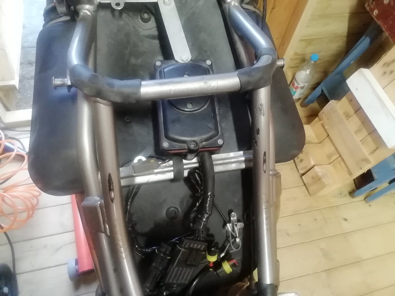

  4. It is fitted with this immobiliser that's not working. Anybody know a good bike auto electrician who could remove it? IMG_20210912_172728.jpg IMG_20210912_174651.jpg
  5. The relays are electro mechanical and as such ripe for age related intermittent faults. My 916 Fuel pump relays became a bit intermittent recently . Though I'd get rid of that alarm asap.
    On my old (1st) 916 it had a datatool alarm that was a simple unplug the alarm from the loom and refit all the original connectors back together it was fairly easy to trace the alarm wiring and spot the plugs that needed to go back together with the alarm removed (not that good a security feature!)
