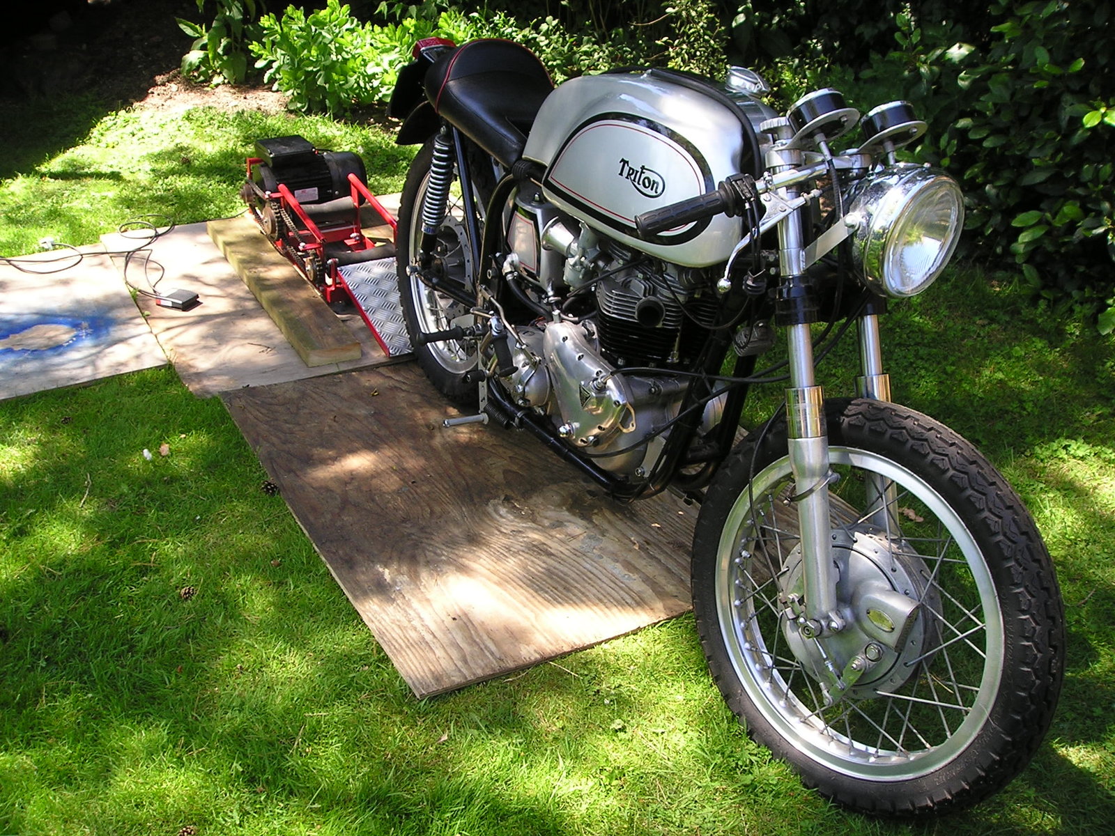

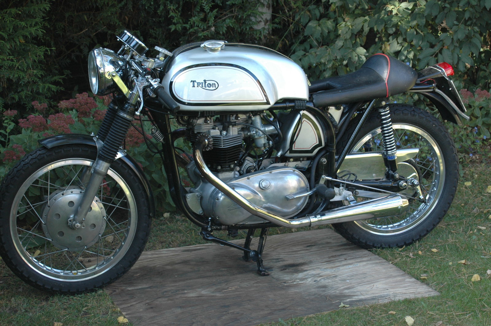

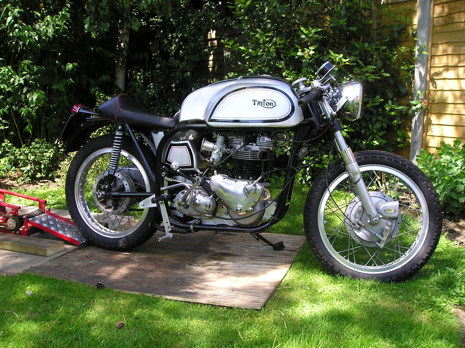

  15. Just a little more info as requested.The bike was constructed by two brothers in the early sixties.The engine is a 6T Thunderbird engine mounted in a Norton Wideline frame.Gearbox is a Slickshift.
    I bought the bike in 2008 and realised within a short space of time there were many things which had either been bodged or had never received the correct maintenance.
    Everything from wiring to knackered valve guides.A supposedly overhauled magneto which was on its last legs,and a considerably abused clutch.
    However,on taking inventory of what I had bought I found a lot of period parts which were of quite some value.
    Genuine Manx petrol and oil Tanks.John Tickle Racing clip ons,rear sets,twin leading shoe front brake,and top yoke.Also came with a Cibie reverse dish headlamp.Mounting plates were by Converta.Smiths Chronometrics to complete the look.
    I used the bike up to 2010,its last Mot.Circumstances meant that the bike was put in the garage for some years before it was looked at again.
    Mrs Mervyn suggested I have a workshop put in the garden so I could put the Triton in there and work on as and when.
    I am replacing the kick start mechanism and clutch basket,plates,etc,with a view to seeing if we have lift off in the near future.It has an overhauled 9 stud twin carb head running new carbs.Also new is the 750 Morgo conversion which replaces the knackered one I took off.Sparks come from a Lucas K2F magneto.
    If I have problems I will pay to have whatever needs doing.
    My aim is to hear it running again,whatever it takes.
    I have only found three photos, P1010040.JPG P1010041.JPG P1010042.JPG will take a load more and put them up on here in the near future
