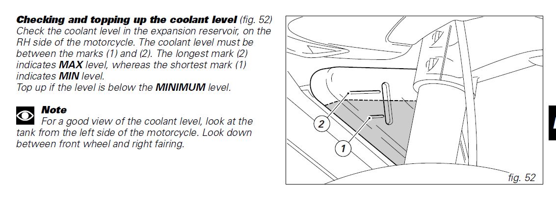

Just had the fairing off. My expansion bottle is opaque black so you can't see the level until it overflows. Took it for a short run then left it idling in garage. Coolant coming out at expansion tank cap. Fan kicked in at 105 DegC. Maybe it's just kicking out the over-fill?
Charles, there is a clear section of the expansion tank on the inside that you can see from the other side of the bike.
Ah Italian logic. To look at something on the right hand side of the bike you take off the LH fairing!! Or is the suggestion that you can see the clear section on the inside face without removing either fairing? Will go an have a look.
Flaming Norah! (I seem to be using this nonsensical phrase hourly these days! Who was Norah anyway?) For anyone else following this path for the first time, I'm so old I forget that phones have a torch in, so with the bars on left lock, if I kneel down at the front of the bike, put the phone light up inside, I can get a clear view of the level window. It's now sitting on 'full' so if it loses any more, further investigations will be needed. (Note: This is with the LH fairing off at the moment, but I don't think this will affect this 'kneel at the front' technique)
Brief update. 1. I meant RH fairing. 2. Safe in the knowledge that the level was correct, and being able to get a few litres of petrol in a Gerry can yesterday, I took her for a run yesterday evening. No overflow or leakage. So for now all looks good and fairing back on. 3. Now just waiting for the heatwave and see if I can find any enjoyable roads in the SE and not collect any points.
