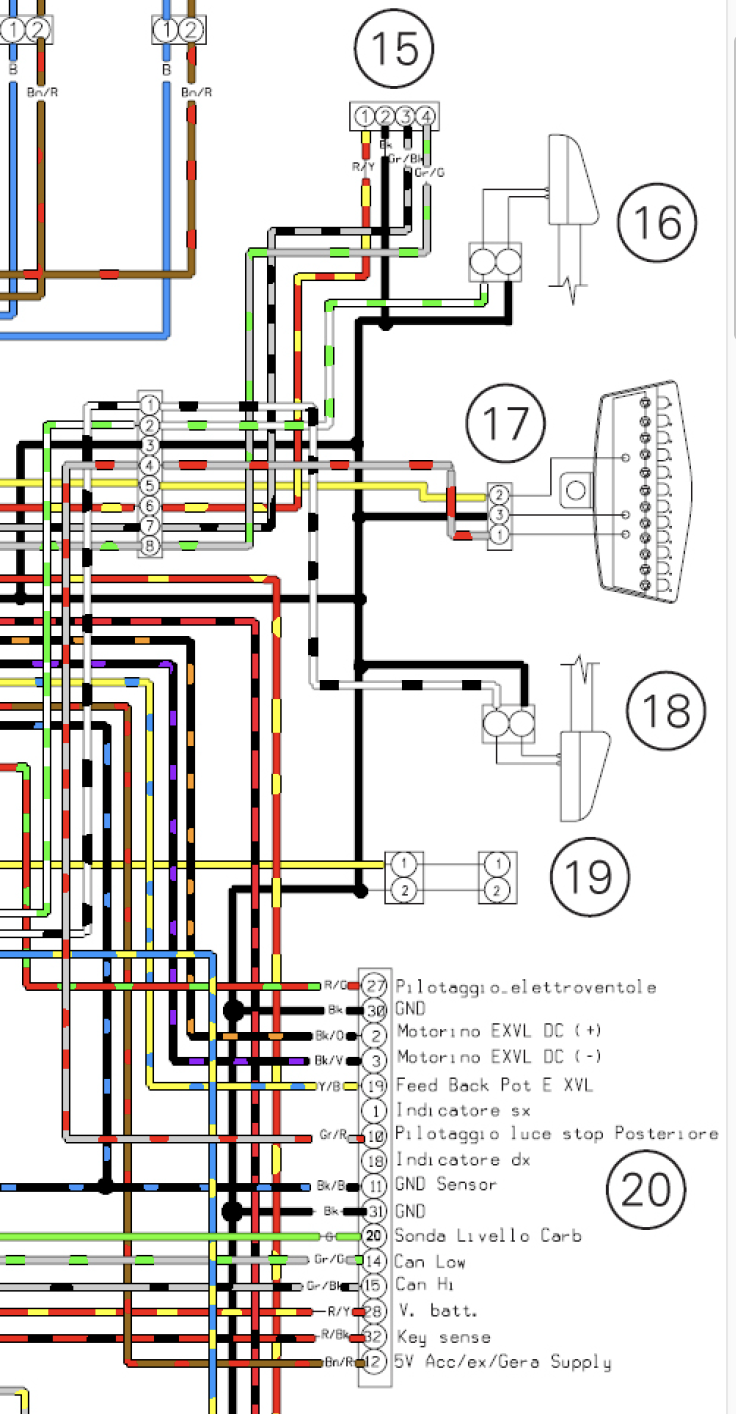

  1. Help please, I have looked at the wiring diagram. But cannot make out what i need to know. I am just being thick I know.
    2017 Supersport rear light wires. Red and White I assume is power, Black I assume is Earth, is Yellow the brake light ?
    Thanks in anticipation
  2. Can you post a photo of the wiring diagram? Or even better upload a pdf? It’ll save others having to search and make sure we’re all looking at the same diagram as you :upyeah:
  3. I have attached it. I looked but could not see the colour coding !

  4. Correct :upyeah:
  5. Black is ground, Yellow is tail light and red/grey is stop light.
  6. Thanks Derek
    That's a far better diagram in colour. I can make sense of that. Much appreciated
