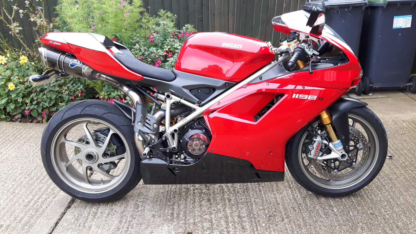

  14. Yes i fitted a larger (non Alloy) tank to mine, i didnt like it cos i thought it spoilt the lines of the bike and i also had an umbilical hernia at the time and the raised height of the tank at the rear interfered with it!...ouch...see pic,bins included for @Ducbird :D
