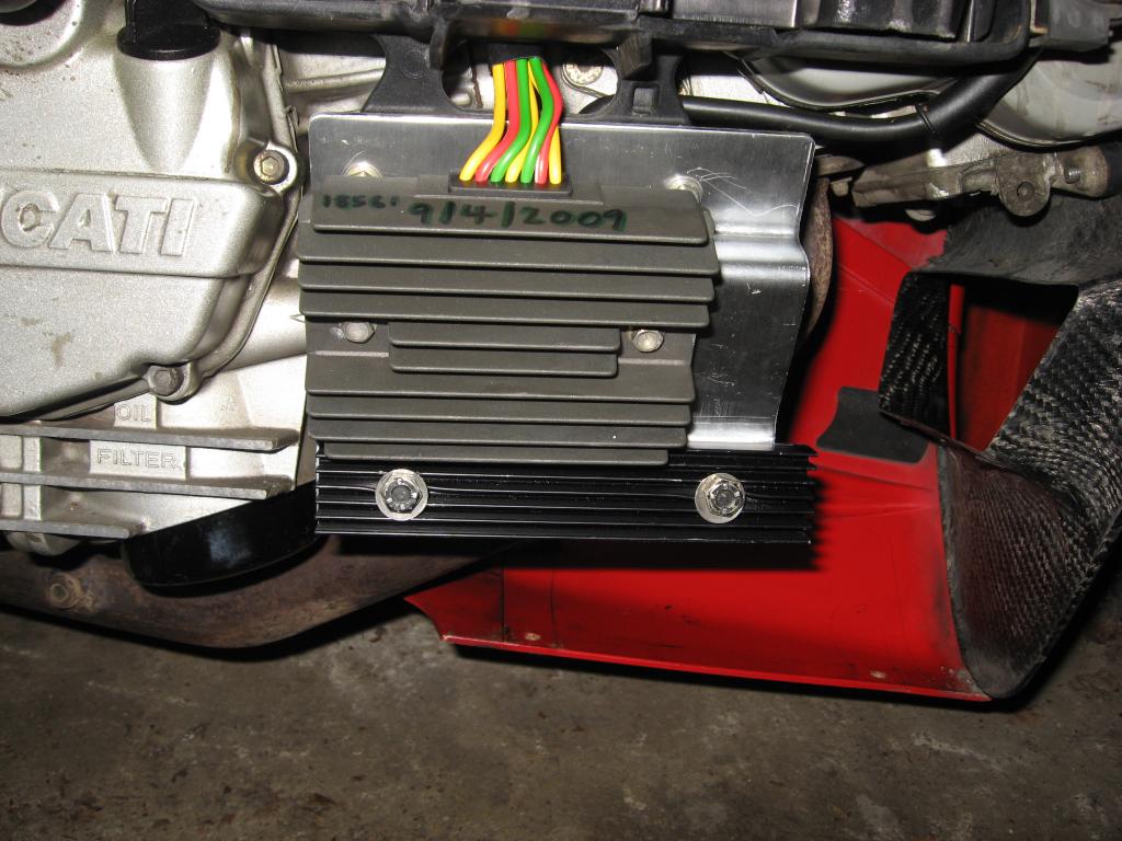

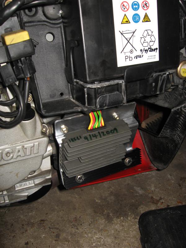

    If you look at the picture the added heat sink has nearly double the heat conductance than the reg/rec heat sink. FWIW This is the later 748 with 998 style fairing which has a larger cooling duct than the 916 style one. If you look at the battery box and brown spots on the casings you can see what happens when an AGM battery leaks when a hole gets melted in through its case, very little fluid is released, if this was a normal lead acid battery my engine and back wheel would have been covered by it and ruined

  12. This is how I run my 3 phase on my '97 748, no bother
  13. Tidy job that Denzil... And some good advice...

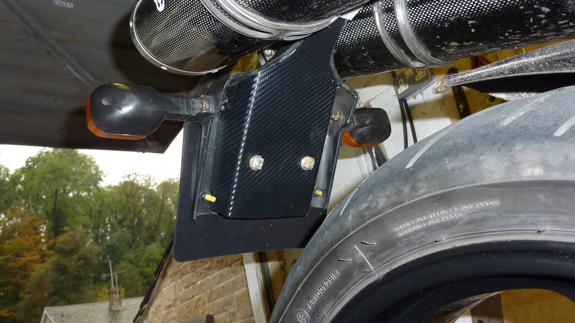

  16. This is how mine keeps cool now.
    And to keep the crap away an added guard.
    Steve
