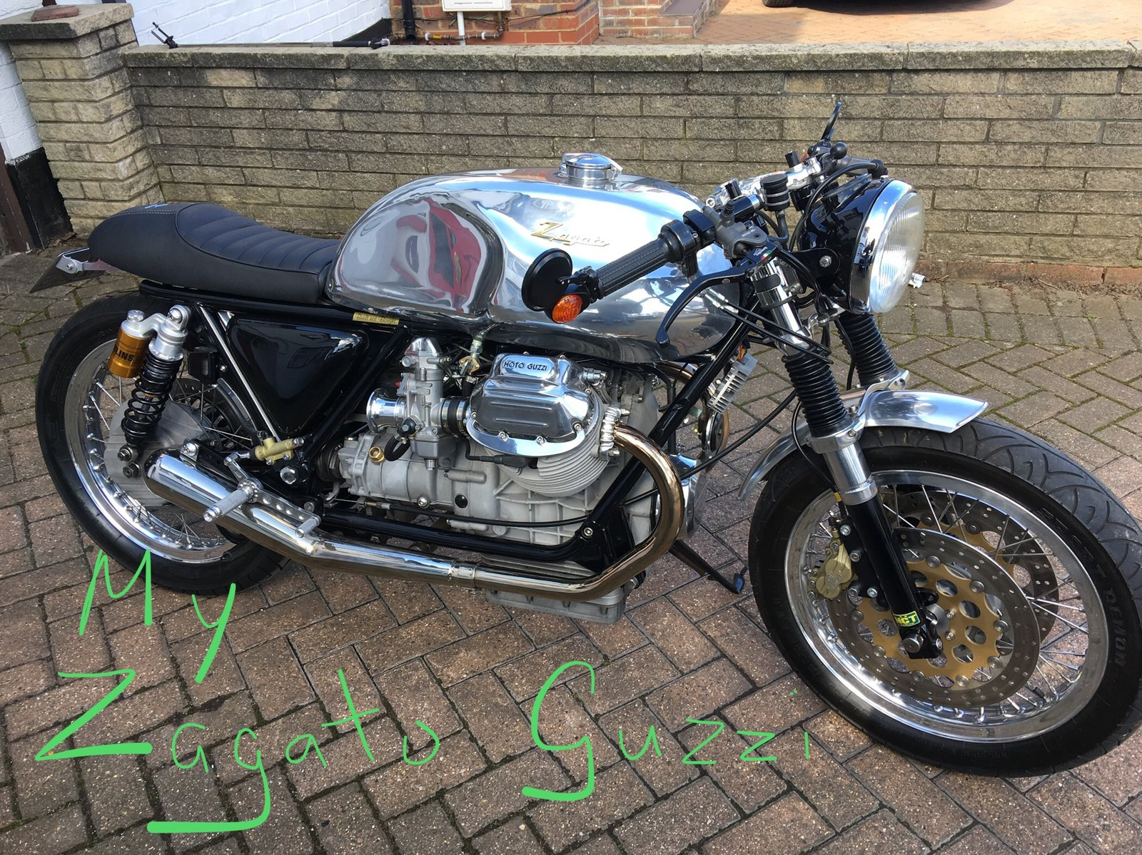

    Anyway, here is the result. It took me three years to build, my perfect Guzzi. Needless to say, this bike is a tribute to Ben Part’s cafe racer. And I was lucky enough to be invited to the event Kickback Custom bike UK final at Coventry a few weeks ago.
    Nothing is as it seems. Classic looks but cutting edge technology.
    Keyless ignition
    Motogadget micro processor electrical system
    Original forks with GSXR internals
    shoehorned in
    Ducati 916 brakesBrembo RCS brake controls
    Silent Hektik digital ignition
    Wireless rear stop n tail lights
    MV Augusta, Suzuki, Hayter lawnmower, a wire coat hanger and gas fittings go to make up this very personal build.
    People have had their noses 12” from it and stil been unable to see some subtle features, I love it. I hope that you like it too.

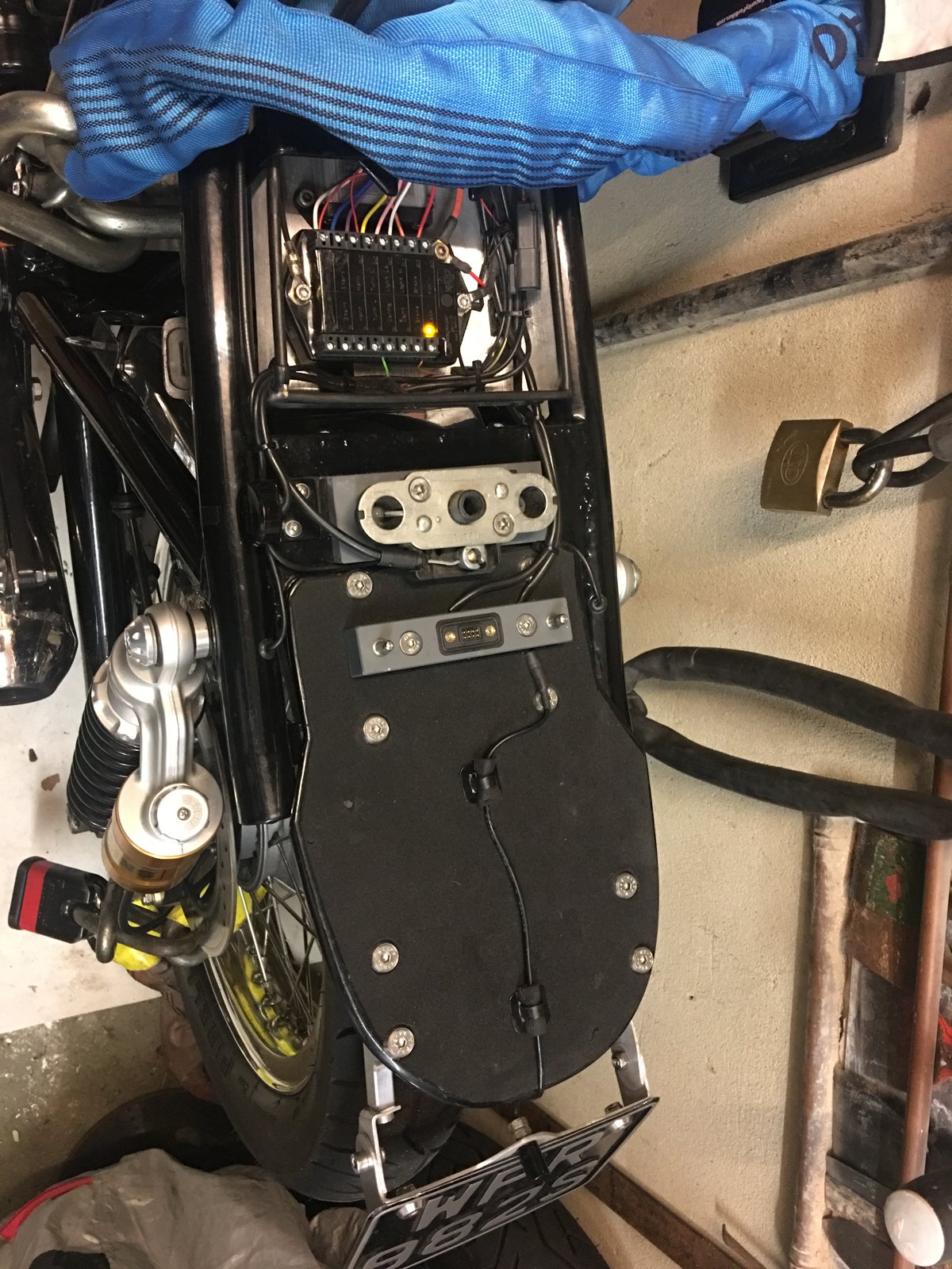

    Out of curiosity, you mention the wireless stop/tail light, and I was wondering if it is fully e-marked (don't worry, technical curiosity rather than any sort of enforcement agency!) does the stop/tail have it's own battery supply, what protocol does it work on (bluetooth, zigbee, etc), what do the sender units look like and how are they powered?

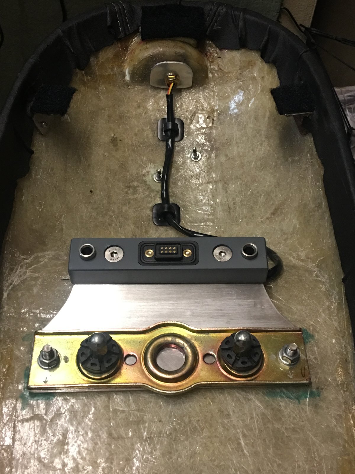

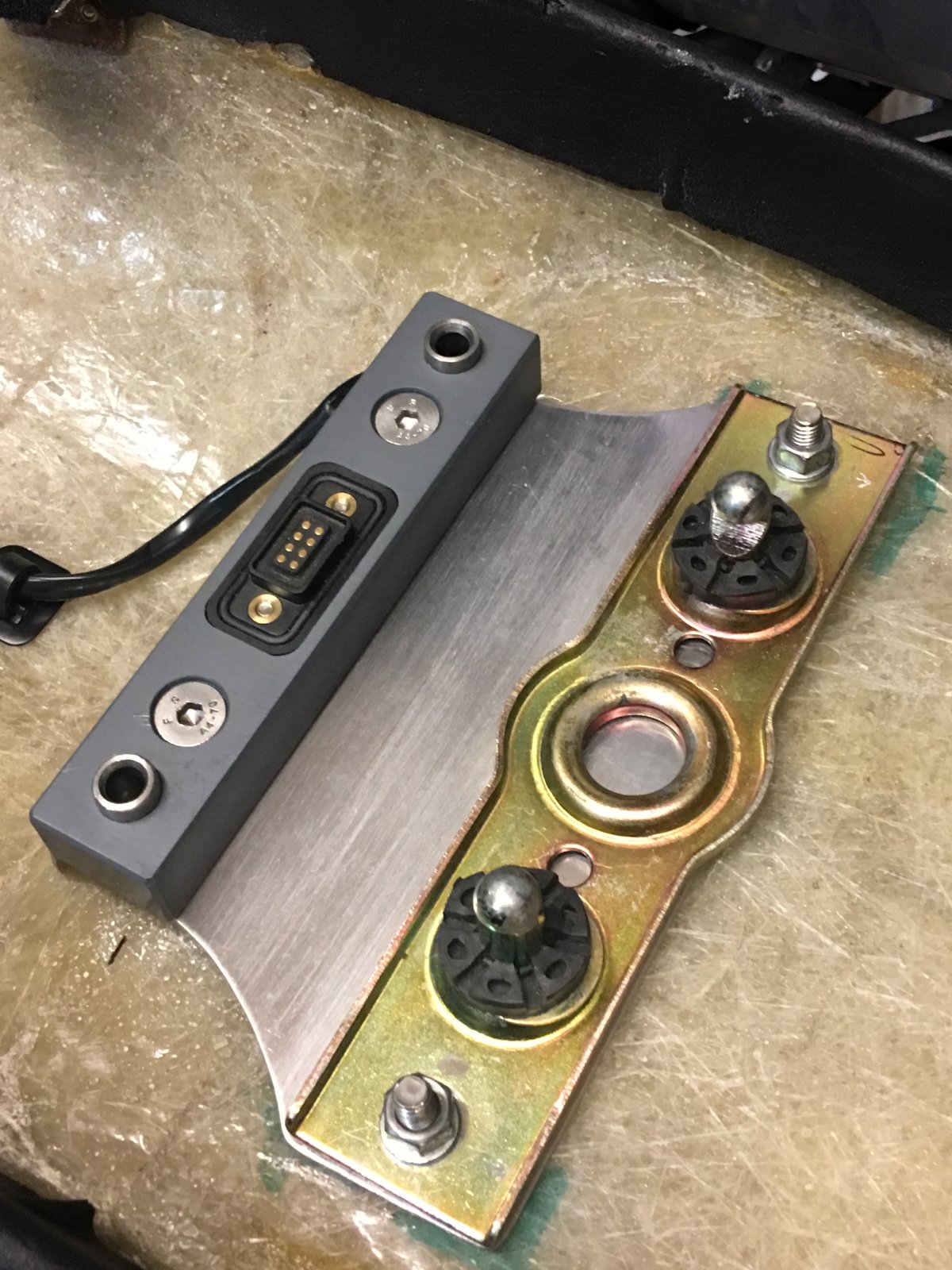

    The stop n tail light is in the seat itself, I used to have a metre long coil of wire between the light and the frame so that when I took the seat off, I could set the seat down on the ground. A socket would have worked but been too fiddly to do one handed.
    My solution was to find some sprung contacts, I initially thought of car hatch back ones but they were huge.
    I found tiny connectors and fabricated mounts with SS locating pins, the margin of error was minuscule.
    Hey presto, after 3 months of drawing trialling and positioning, it works, every time. No wires between the seat and frame.
  4. Looks like you could run a Hi-Fi System and a desktop PC off that equipment ;)
    Really tidy job.
    Which engine and frame?

  6. ahh, I see what you mean. I was picturing in my head a microswitch on the brake lever, another on the brake pedal, each with RF sender unit that sent basic signals to a receiver unit in the tail light.
    A very tidy solution.

  8. It’s a ‘76 T3 base. I also have a Le Mans in the garage, but the T3 was a mess and I didn’t want to chance ruining a cracker.
    Besides, it’s now 950 cc, ported and flowed, bigger carbs with pumpers on, twin plugged digital ignition handled by a deep spline clutch.
    It really shifts up to 80 which is where the Le Mans engine keeps pulling strongly, and anyway my eyes start to water with the jet helmet and google’s. That’s enough for me :innocent:

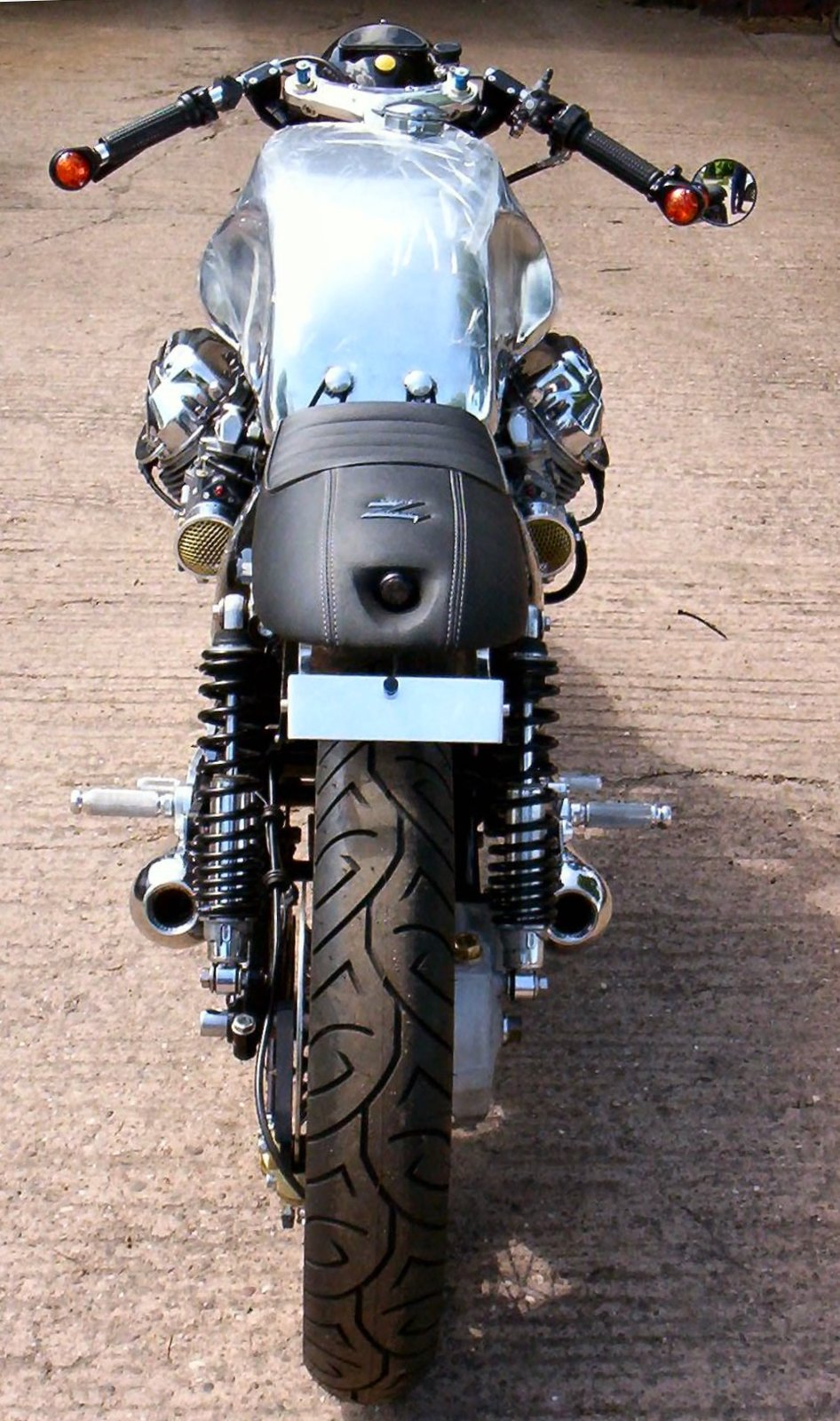

  15. This bike design and engine confriguration resonates with me all day long:)
    You might like this angle then (pre Ohlins) It’s my fav shot.
  17. With those pots sticking out either side it looks tough:)
