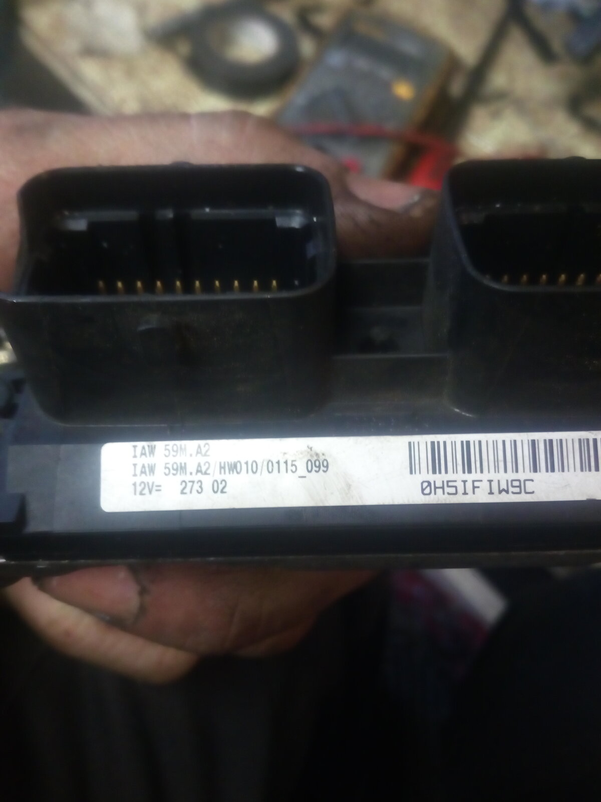

  1. I got it running.
    Phew...
    Swapped over the clocks,ignition and ecu from my good 999.
    IMG_20190124_162036.jpg This ecu works with either of the clocks.
    So I'm thinking, getting my clocks virginized will allow it to run its own ecu.
