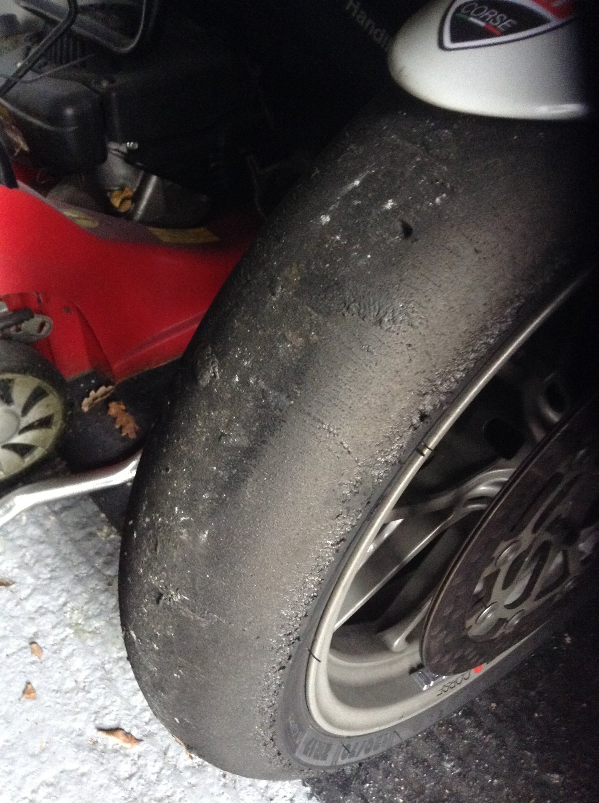

  2. I noticed these lines running across the tyre

    Which tyres are you running? Pirelli’s? The lines almost look like they have been made from a slatted surface.

    Re the tyre, The bike was loaded on a stillage for transport, it took a chunk out on the way there but luckily wasn't as deep as a wear indicator. Maybe the loading ramp I guess? Tyres are Michelin power slick Evo, other than a pressure cock up on first day at Valencia they were awesome, way beyond my talent. Still got a day or so left.
