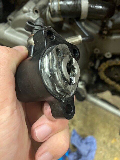

  6. well i think the issue is that the internal part of the slave cylinder has spun and I'm assuming it isnt meant to given that if the recessed part was facing towards the chain it wouldnt have made contact.
    I imagine that the X-notch in the slave is supposed to lock into something.... which isnt present

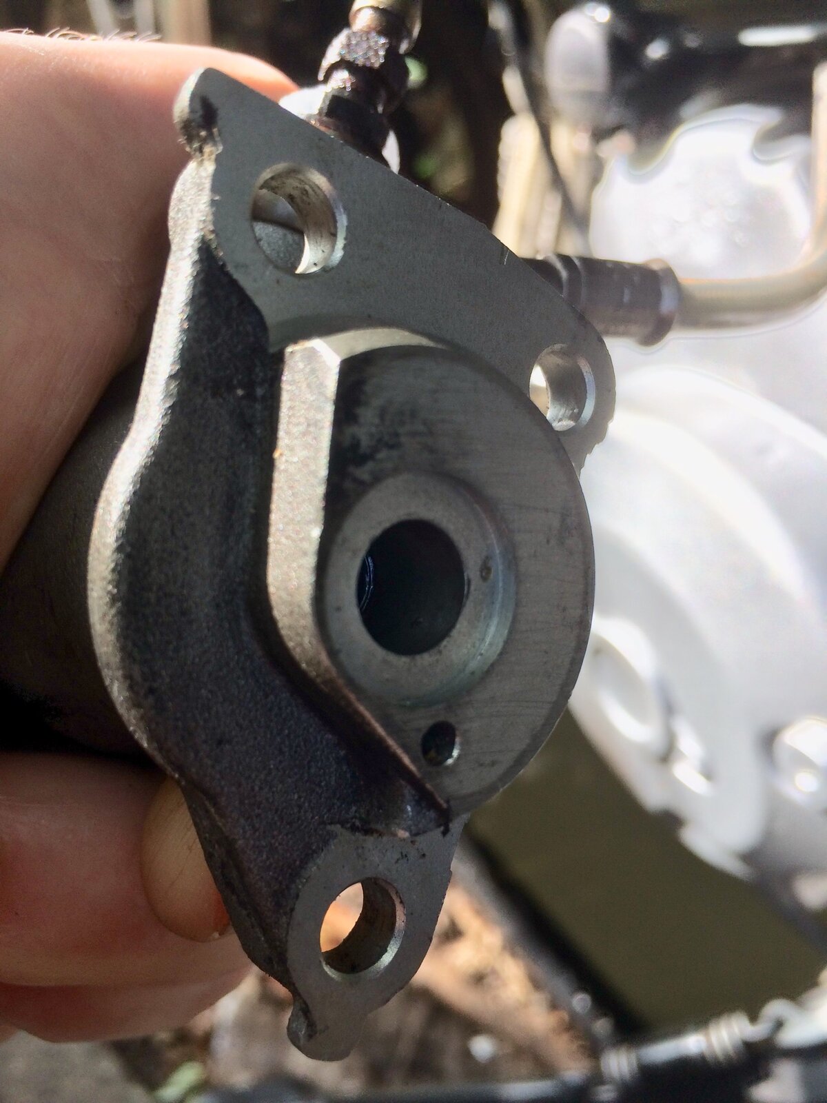

    I have enclosed a standard slave for comparison, have fitted many Oberon over the years, they are certainly a good alternative, but I think you might be right about the body somehow rotating in the clutch slave housing. I can’t see with hundred percent clarity, but it looks as though your most cutaway portion is 180° out?
  8. the single slot in your above pic is there to locate with an "anti-rotate" pushrod if you happen to have fitted one, they are interchangeable with the "ordinary" type, but make sure you get the right length.
  9. So Chris, the silver part of the Oberon actually rotates freely so when I initially installed it the orientation of the cutout would have been the same as in your original.
    I definitely dont have an anti-rotate pushrod though, it spins freely. So is the problem that I dont have the anti-rotate pushrod or that something has failed in the slave cylinder causing it to spin when it shouldnt?
    Maybe worth an email to Oberon?
  10. speak to oberon. they should have a lifetime return to base warranty
    they do sell rebuild kits , so its possible your is coming apart
  11. what is "the silver part"? - is it a secondary housing that then has the piston within it? (can't tell from pictures) if so, then it shouldn't rotate, only the piston rotates erroneously at times/on some bikes hence the introduction of the ant-rotate version.
    I can see there is a hole in "the silver part" - maybe this is where a dowel or simply a fixing ought to live normally? (which would prevent it rotating?) I haven't bought an Oberon for a few years, so design has obviously changed and as funkatronic says, if a comprehensive rebuild kit is available, then "the silver part" must be easily removable, possibly as above. :thinkingface:

  12. Wouldn't be the wrong slave cylinder???
    Other models of cylinder have a cut out on the silver section at the back....right where yours is rubbing.

  16. so just in case anybody was interested in the resolution of this:
    I fitted a new/used gear selector mechanism and after a brief ride around the block the bike seems to be ok and selecting all gears fine.

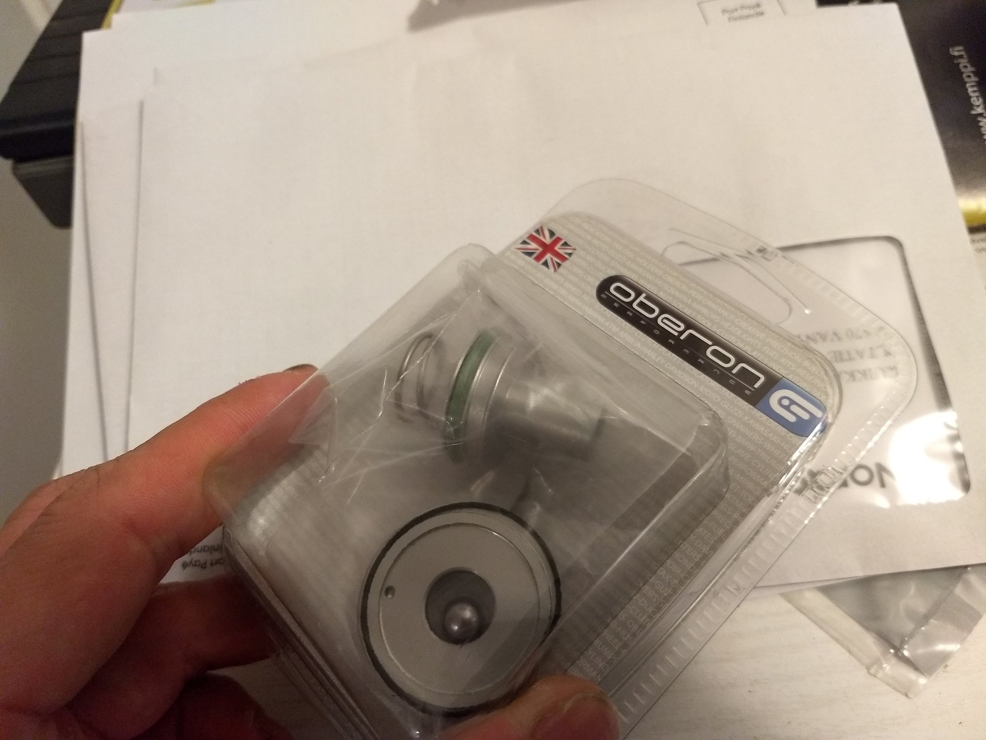

    I sent photos of the slave cylinder to Oberon and they sent me a new item and are investigating the broken part to see why it failed.

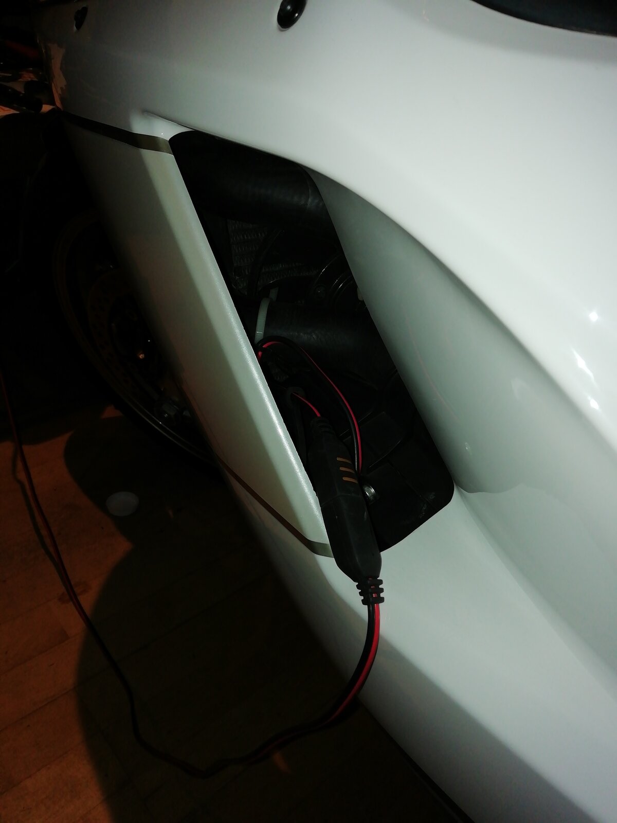

  17. No, you don’t have to remove the panels to connect a charger. If you buy new, the charger should come with leads that you permanently connect to the battery. At the other end is a socket. You route the socket to somewhere convenient (by the clutch slave on a 1098). Then you just connect the charger to the socket when you want to charge the battery.
  18. Buy yourself a trickle charger and it will come with a lead for permanently attaching to the battery. The other end of the lead will have a plug/socket on it which you connect the charger to, rig it up so that connection is just inside the fairing vent and away you go. I use a Ctek charger which works well for me but I'm hearing good things about Noco genius.

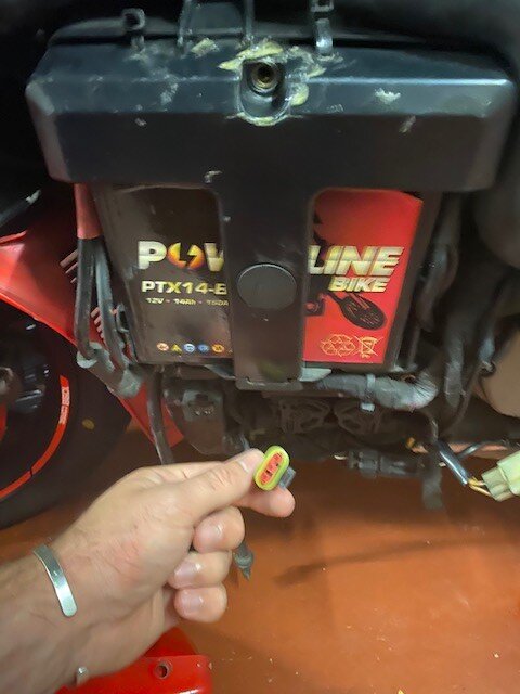

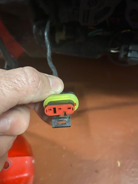

  20. just to add to this, I read that some of the bikes were fitted with a battery charging connection from the dealer.
    After looking at my bike I have this connection which I'm not sure about - is this for the battery or something else?
