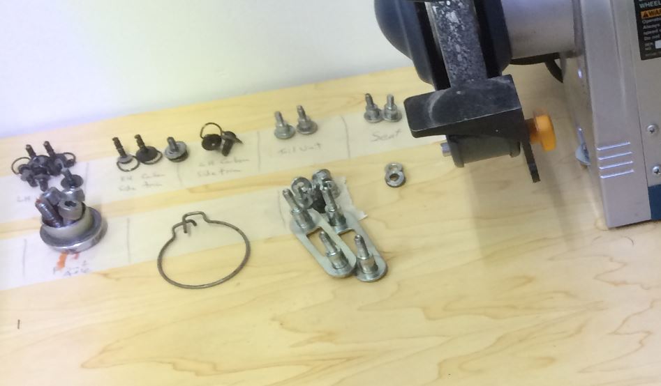

  1. i'd walk straight through the middle of them, i know i would, and kick them into every corner.
  2. I know, I'm ashamed. :(
    If I can get some credibility back, I was more organized and I did this when I was returning it back to standard last year. :)
  3. Better, redemption isn't going to be too hard :D. Andy

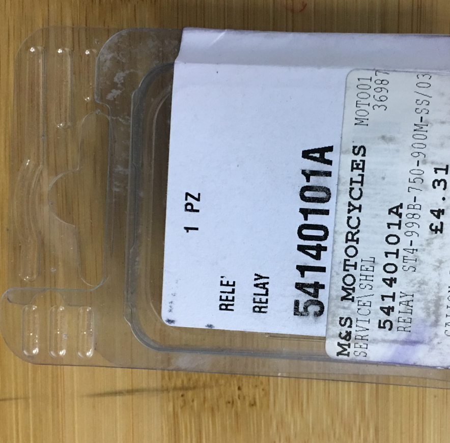

  5. My headlight relay has expired. Could anyone advise where I can get a replacement? Ideally sharpish
  6. Your local dealer parts department or give Craig a call at Moto Rapido (01962877998 option 1) before 11:00 and he will put in the post the same day. Andy
  7. Perfect. Thanks :)
  8. Part number - 54140101A
  9. They are buttons, get 2 or 3 as they are used for a few things on the bike.

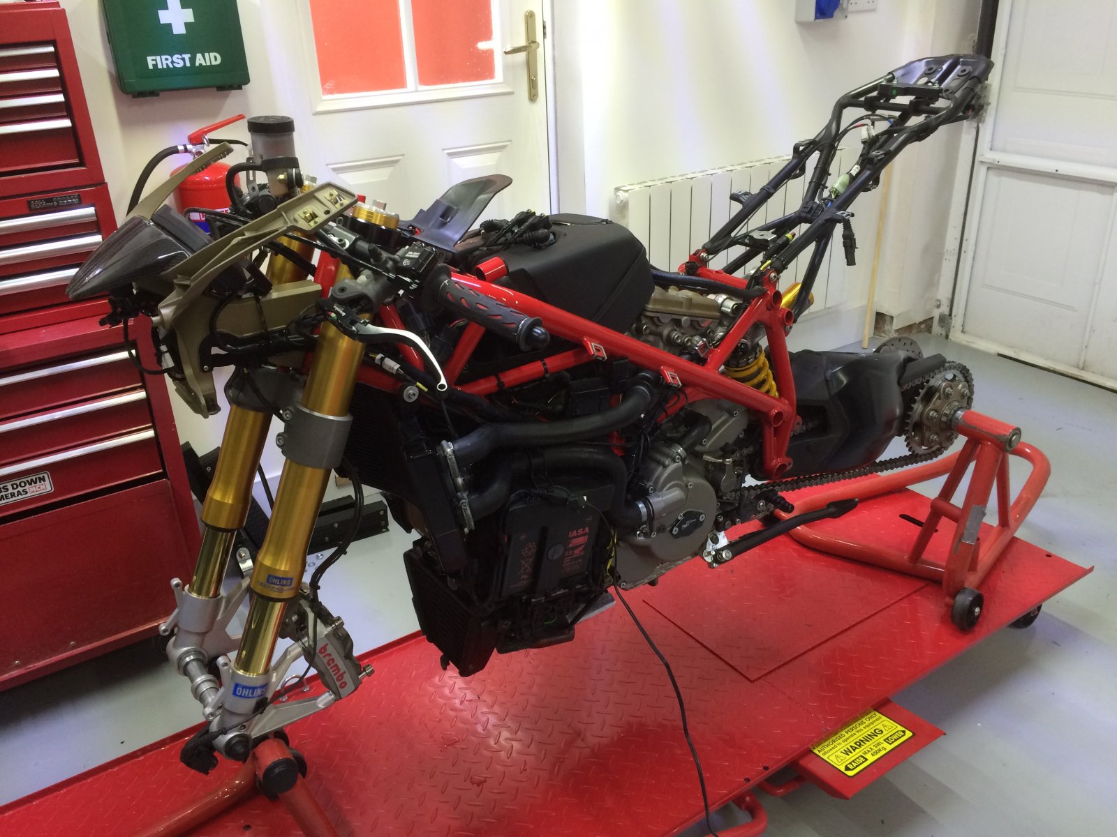

  10. Having a few issues with my headlight too, started the bike yesterday after being parked over winter and the headlight was off, main beam works ok but if I wiggle the wires up behind the headlight it would come back on then go off, not got chance to strip it down yet but does this sound like simply a loose connection or a dash problem?
  11. loose connection IMO
  12. Relay changed job done, thanks for help.
  13. 90 mins to remove fairings? Its a 20min job.
