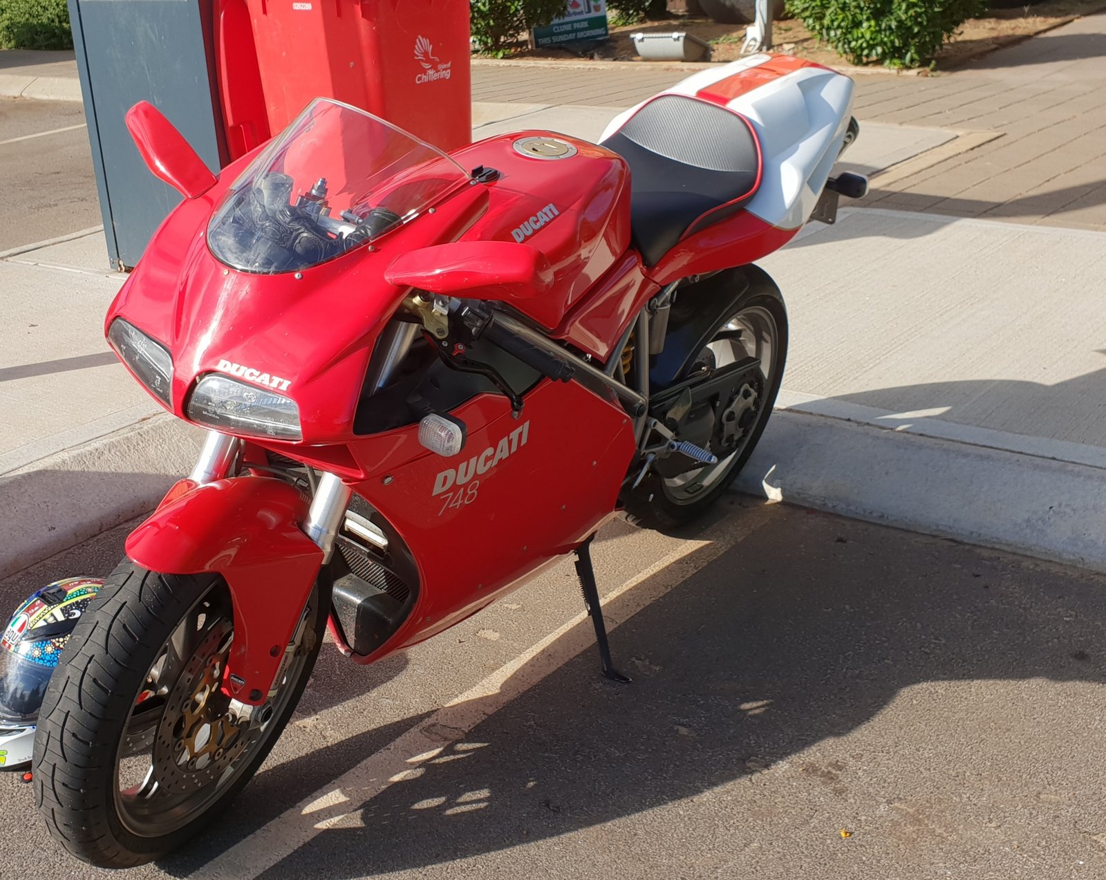

  6. I have a 1098 stand on my 748. Much better lean angle. Slightly bigger footprint. Easiest mechanical job you'll ever do.

  13. The 1098/1198 side stand also allows you to have a little more rear ride height and still have a really good lean angle 20181125_074220.jpg 20181125_074200.jpg
  14. Such an improvement over standard, thanks for the photos Martin.
