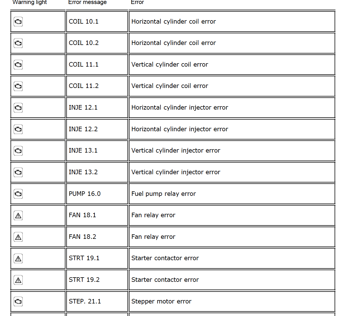

  7. I've just had a look through the service manual, specifically all the dash codes and readings. Nothing at all there about ---. Loads of error codes though if you have any.
