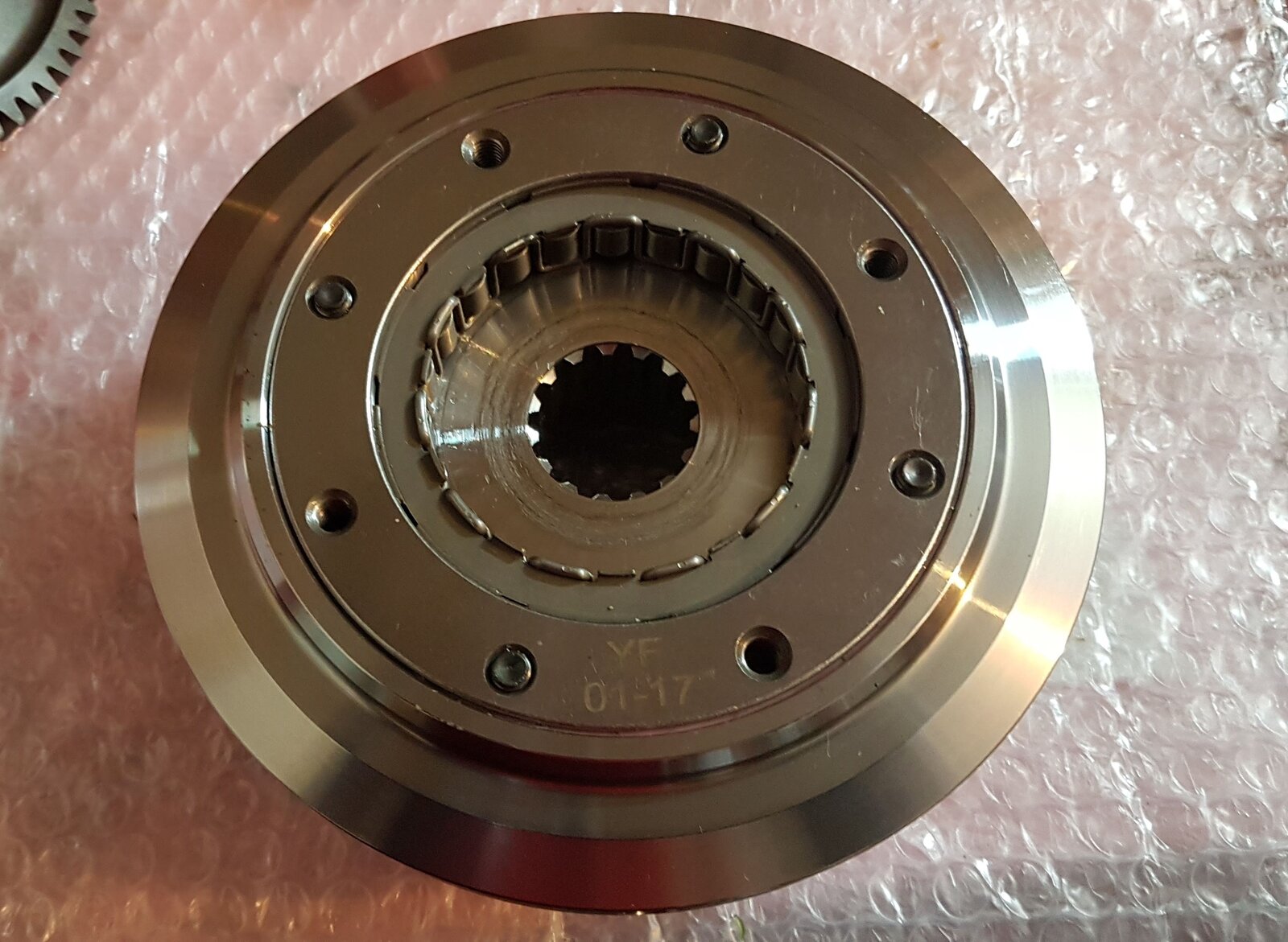

  1. Uh oh missing oil feed?! That doesn't sound good!
    I've found a pic of the same part and it seems like it may be designed like that? or a bad batch?
    https://www.ebay.co.uk/itm/Volant-M...756400?hash=item2118e7aa70:g:j30AAOSwmLlYBMhD
    Do you know what the latest part number should look like? I've got part number 276Z0011A.
    Also, maybe the hole was removed as the corresponding hole on the flange was also removed? meaning the oil feed would be blocked anyway?
    I was thinking of doing that too, but I was worried that the holes wouldn't line up as the alignment holes have been removed! Hopefully freezing it would give me a bit of a chance to wriggle it to align properly once fully seated? Did you have any issues with aligning the holes?
    I'm pretty sure the sprag requires some tight tolerances to operate properly, and any opening up of those tolerances would mean it'll slip more, which it already looks like it has a problem with.
  2. Yes, that part number is the latest one. but..... the eBay one has the mark and drilling. Where did your new one come from? The number on yours in the picture doesn't look like a Ducati one

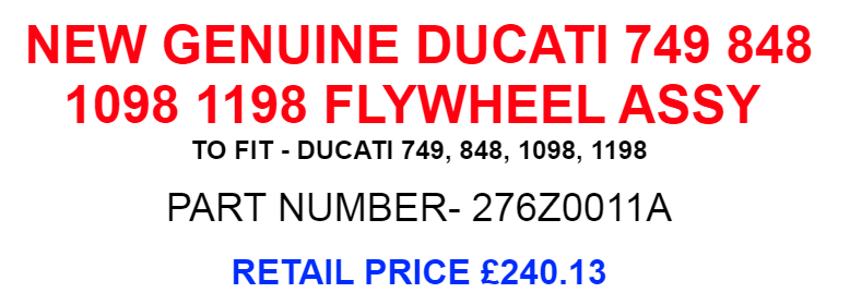

  3. The new one I bought on eBay, sold by HGB Motorcycles, a dealer based down south. It was advertised as a genuine part with that part number:
    eBay ad:
    (I put in a cheeky offer as I didn't really need the new flywheel, minus the 2 at the front of the RRP, and it was accepted to my surprise, and previously joy, but now I'm worried!)
    I bought it exactly 30 days ago, as there's a 30 day returns policy, I've filled out a returns form anyway and asked them to prove it is genuine.
    Looking at the other ebay flywheel I linked, the holes look chamfered like the original I have, so maybe another clue it's not genuine!

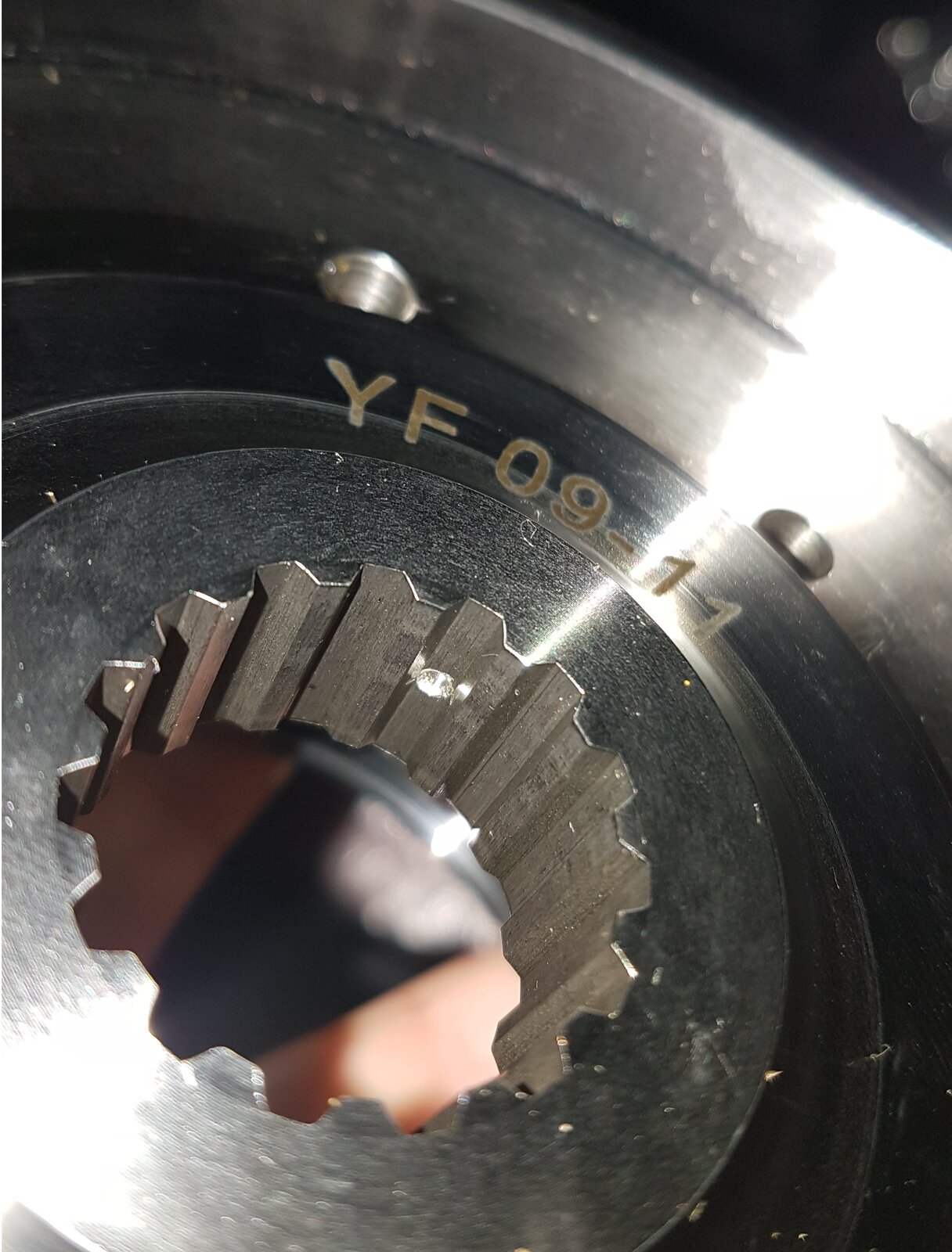

  9. Doh... I had another look at the new flywheel....and noticed a hole in the splines...which came out at what I thought was one of the alignment marks...I looked at the picture previously posted, and noticed this detail was hidden due to the angle of the picture! I thought the oil way you were referring to was the bigger hole on the same PCD as the bolting holes i.e. the alignment to flange hole!!!
    So in conclusion, it does have an oil way to the splines!
    I've emailed Ducati anyway with all the pics to see if they can verify the part, if they respond positively then great, but if not then I'll stick with Nelly's judgement and err on the side of caution!

  10. 3 weeks in the freezer seems like plenty to shrink the flange to help it fit the flywheel, so time to get it out and put this thing back together!
    In the meantime, the "new" flywheel has been returned due to unanswered questions about some missing features:
    - The alignment mark near splines
    - Chamfers on the bolt holes are different to similar parts
    Ducati Italy did try to help, however, they mentioned it may take a number of weeks while they contact the right dep'ts/manufacturers to verify the parts. Time I didn't have so I opted to return it.

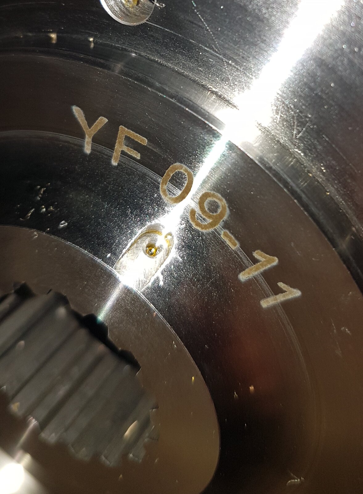

    The part marking "YF 09-11" however I'm sure is genuine as there is a similar part marking on my new flange bought from Nelly:

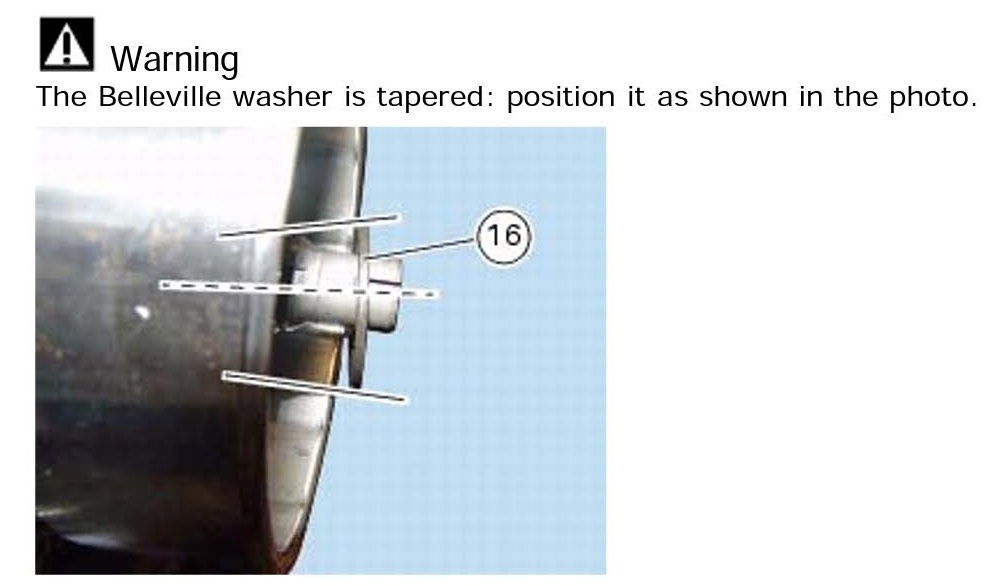

    The crappy diagram in the manual looks like it’s indicating to install it with the wider end on the nut side. However, the witness marks of the nut on the washer indicate that the wider end was fitted on the flywheel side, and I’m sure this hasn’t been modified since leaving the factory. It’s also the side I would normally fit a Belleville washer, and also the way it’s shown on other Ducati manuals…..so which way is it?

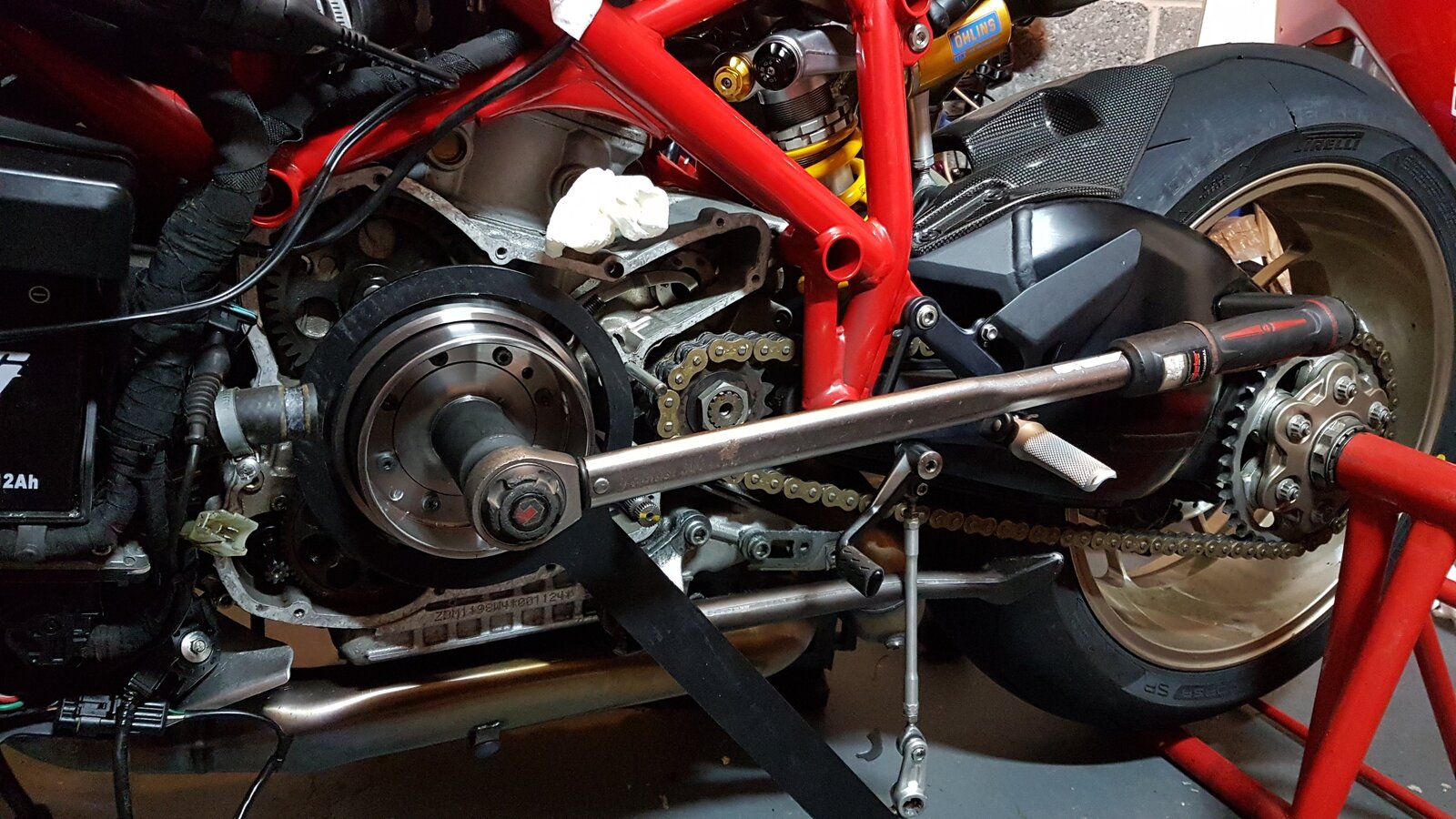

    Next up was the nut…the part I was not looking forward to the most! The thought of torquing above 300Nm started to dawn on me and I decided to have a practice run with the old nut first. I attached the holding tool to the flywheel and started to torque up the nut….100Nm…..200Nm……and after what seemed like I had my whole weight on the end of the torque wrench……..finally..……SNAP!!!......Only joking finally I felt the relieving sound of the torque wrench clicking. Wasn’t too painful thankfully! Now it’s time for the real deal with generous helpings of Loctite.
