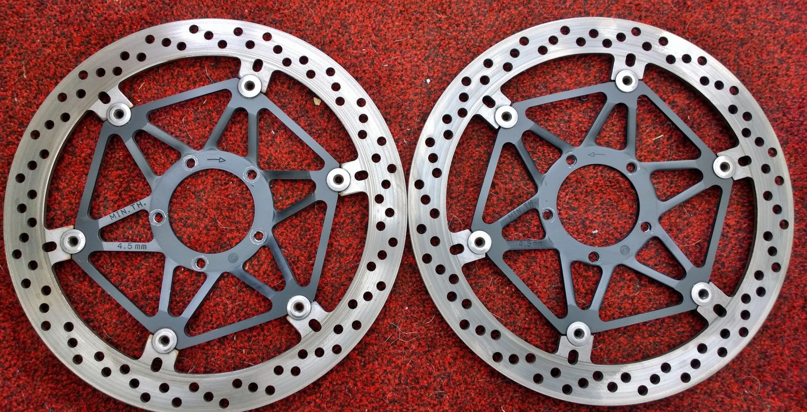

  9. right discs dug out
    please note they have sat on a shelf for a year since I used them.
    no lip at edge of pad area and no play that I felt in use but I think your confusing float with play.
  10. I'm not sure what the tolerance is on the float, I know that if I hold the current discs the float play is probably betweem 3 and 4mm which to me seems to much play. Anyhow I'll defo have yours off you please @Cobra88 - PM sent
