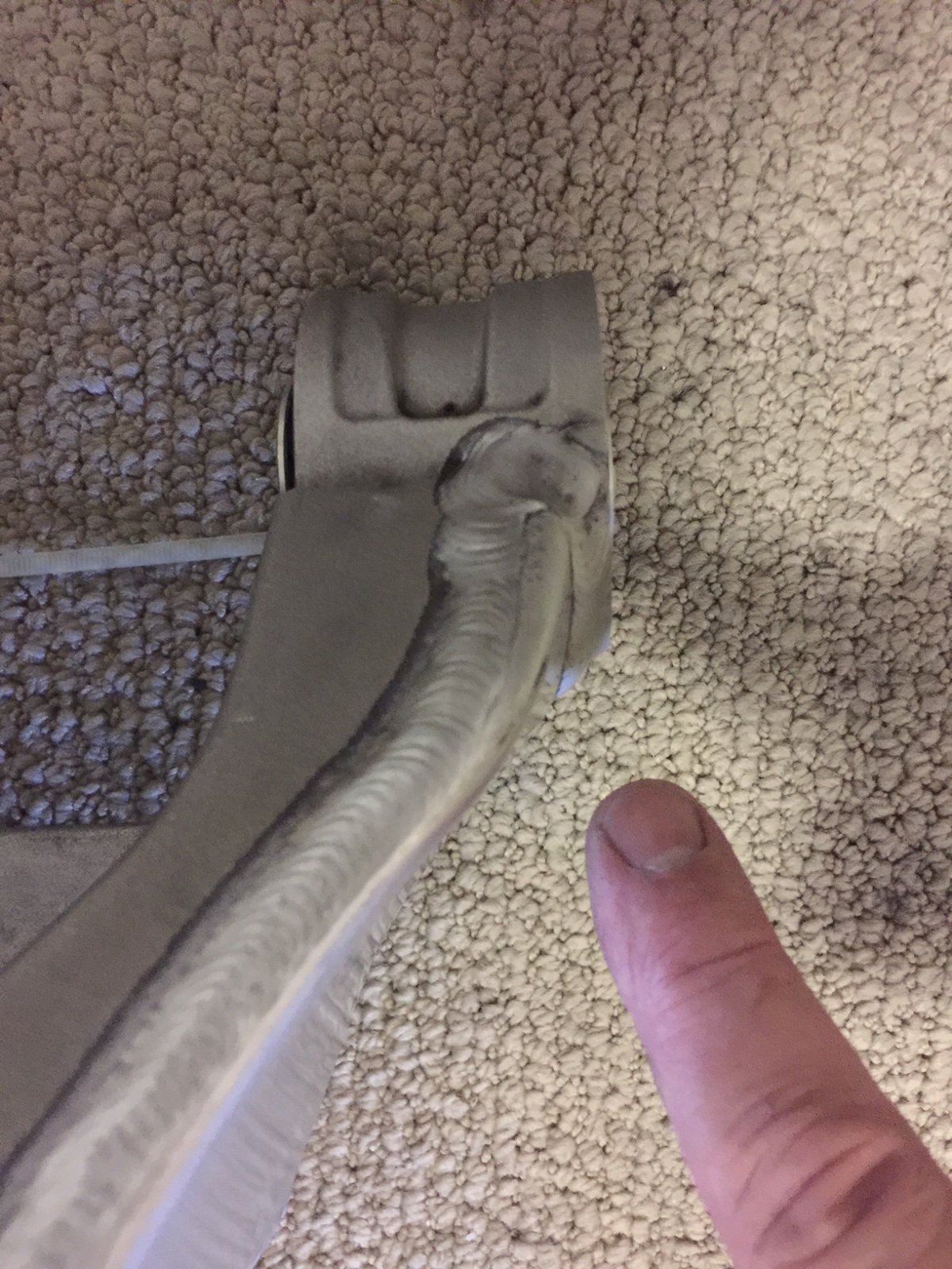

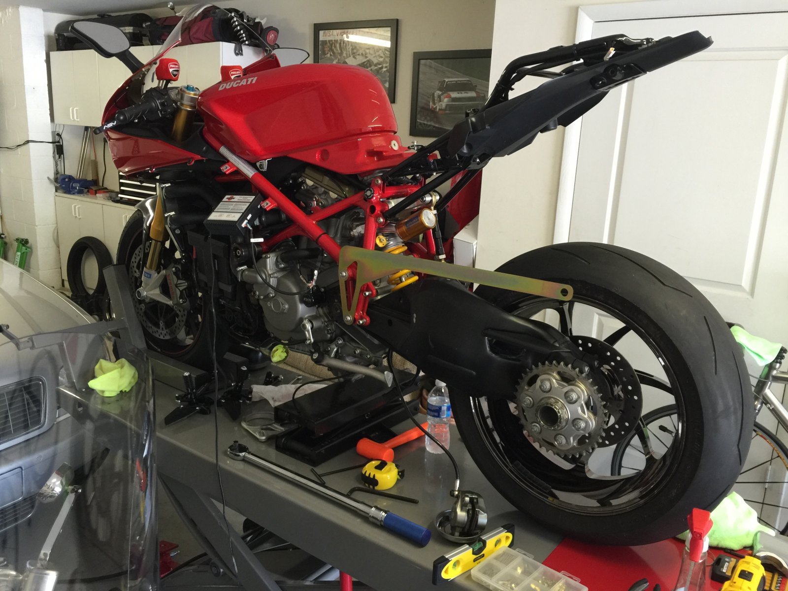

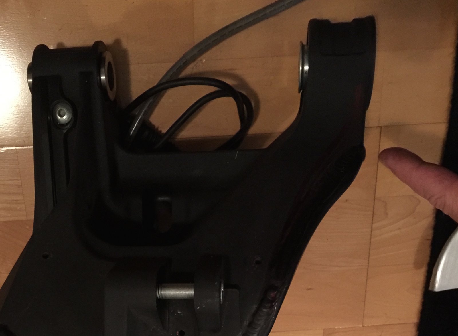

    Mozzo.jpg Fabrication or Step up? So I'd heard that the 1098SF swingarm was slightly longer and was a cheap alternative to the 1098RS swingarm. I searched eBay and found one in decent shape for about $300 US. I took off the stock one and fitted the SF to see what needed to be done. The right side is the issue in that where the exhaust is routed down from the vertical cylinder, the SF swingarm extends back from the pivot about 35mm to 40mm before it starts to curve in towards the wheel. On the Stock SB swingarm it curves in right at the swingarm pivot bolt. So after trying to have one fabricated and not working out and then trying to do the fabrication myself and send it to a welder/machine shop. I realized that the time and effort was getting to be a bit much. If I had access to a machine shop, I would of loved to create one out of a 1098SF swingarm because I think it looked pretty nice actually and if you spin the Mozzo back towards the frame you can get very close the the 1098RS length. Photos are of the stock 1098 Superbike Swingarm and the stock 1098 Street Fighter showing the roughly 35mm difference where the exhaust hits on the Streetfighter swingarm if installed on the Superbike. Not saying it can't be done, just requires some effort. The rest of the swingarm fits fine. I have a Pirelli SC2 200/60/17 mounted on my track rims and clearance was not an issue except where the vertical exhaust is routed. Mozzo - I love that the Italians have a specific word for part!

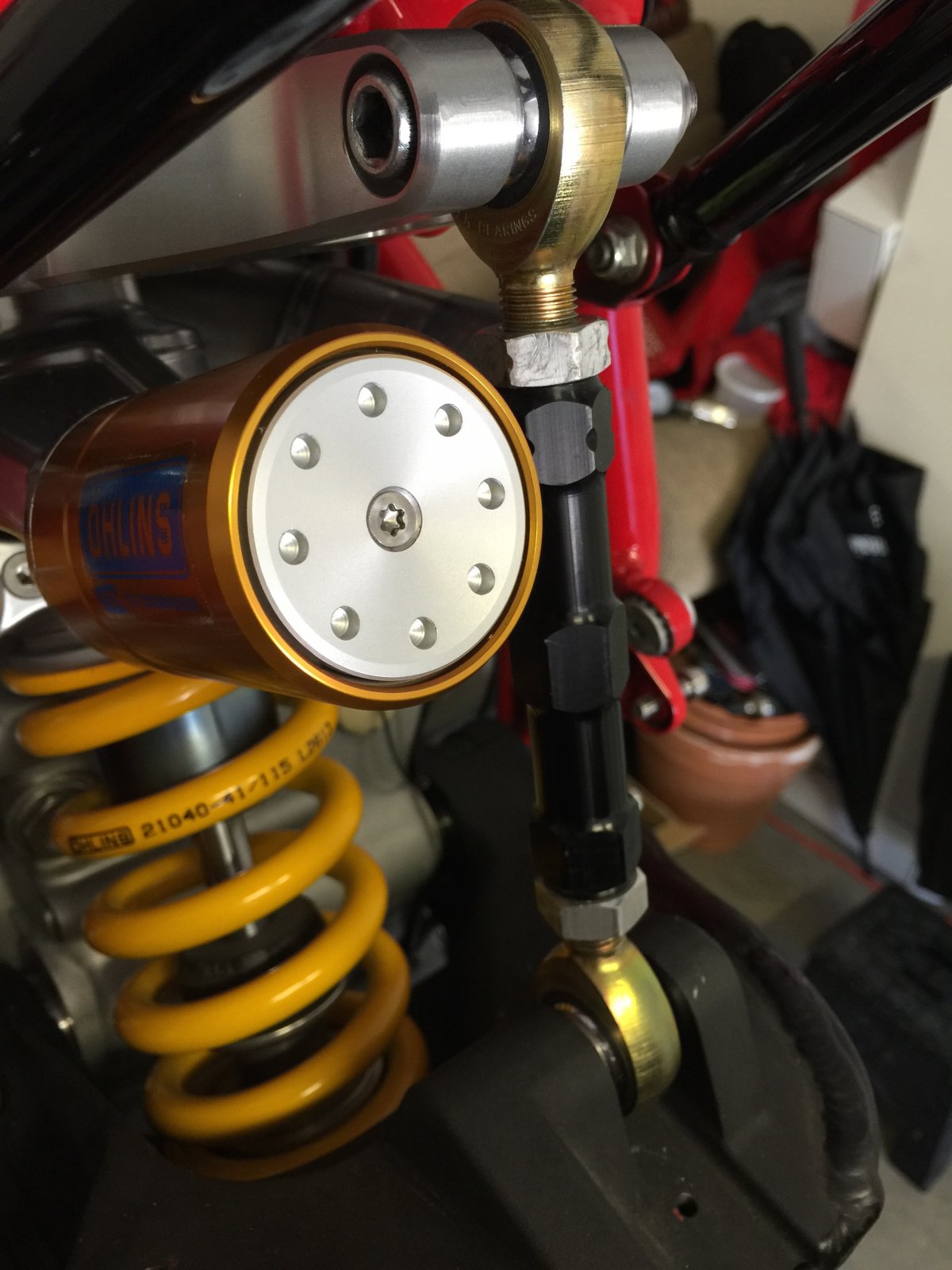

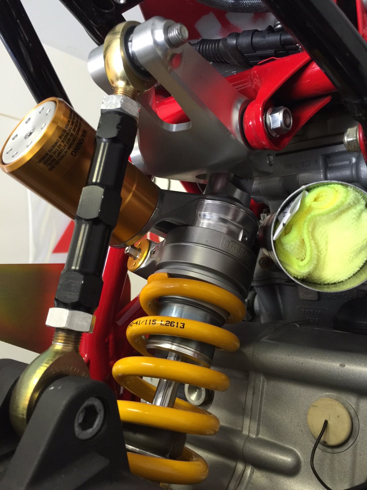

  10. 1098SF Swingarm Fit Test.jpg 1098SF Swingarm Fit test with Ohlins TTXGP Shock.jpg 1098SF Swingarm Fit test with Shorter Link.jpg 1098SF Swingarm fit test on my 1098S "Hit the Wallet" Project. Making sure that the 1098SF Swingarm fits with the Corse Rocker, the Ohlins DU343 and the shorter link from Swingarm to rocker. Yep, everything fits nicely, just need to make room for the exhaust.

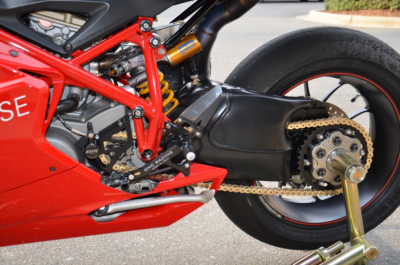

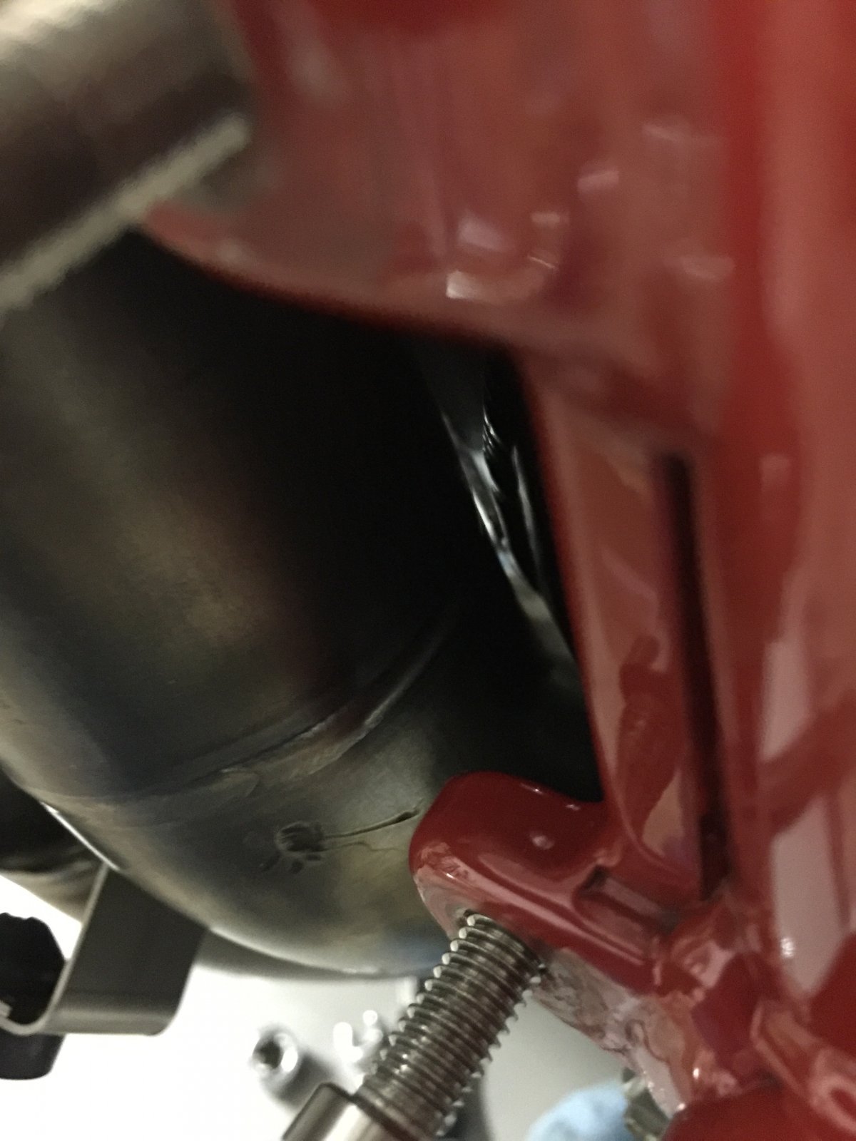

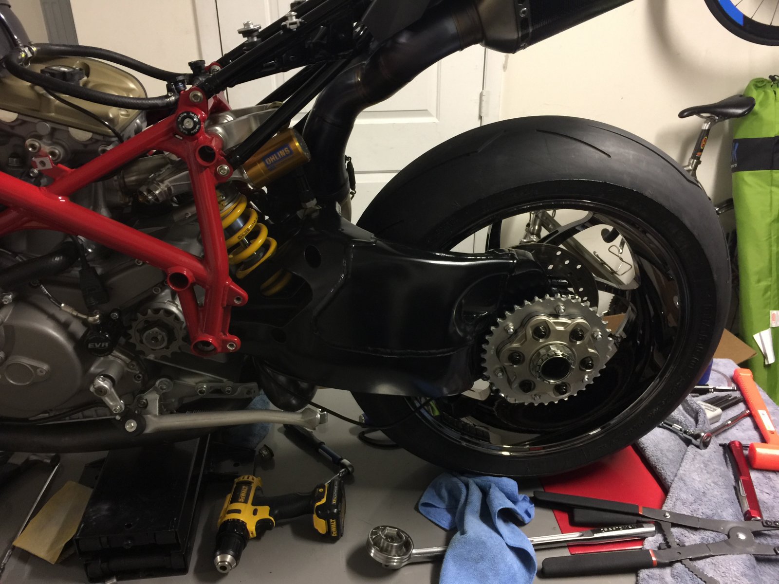

  11. 1098RS Swingarm.jpg DSC_1590.JPG RS swingarm and Akrapovic exhaust clearance.jpg While all this trying to fit the 1098SF swingarm is going on, I was on my other bike (a Honda VTX1800F Cruiser for puttin' around with the better half) when a guy in a car coming towards me in the opposite lane decided to turn into me. His left front fender hit my left leg knocking the bike over on top of me and I (Luckily better half was not with me at the time) slid about 15 yards on the asphalt with an 55 stone bike on top of my right foot and lower leg. I was lucky, nothing broken, but lots of road rash and a badly sprained right ankle and foot. So that kind of set me back a couple months. Be careful out there on the street! Anyway, I started looking to see if I could find a 1098RS swingarm and that's how I found this forum. I read thru a few threads and quite liked the comments and info so decided to join. I started a thread and mentioned what I was looking for a 1098RS swingarm and about two months later Lukefrs contacted me and said he had seen a refurbished one for sale on eBay out of Germany. I wound up contacting the seller to get the history and see if it was still available. It was and did include the bolts so I decided to make the purchase (Step up). Be careful, if you buy one of these swingarms because the bolts and the threaded pieces they fit into are are about 120 to 150 quid each! Make sure they are included when you buy one, not only because of the price but they are getting hard to find. Many thanks to Lukefrs for the tip!
    No real fitment issues to speak of, though fitting it into the frame was as expected, very tight. I had to actually loosen the engine mounting bolts that run through the rear of the case to get this swingarm installed, the stock swinger easily slid in and out once I removed the pivot bolt, not so for the RS swingarm. Also the clearance between the Akrapovic Evo exhaust and the swingarm is tighter than a gnat's ass (less that a piece of paper). Not sure if it's the same with other brands (i.e. Termi) or not?

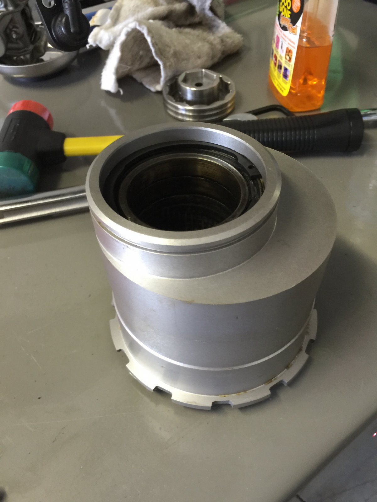

  17. Cafe' Ducati.jpg Have some work to do today on the Red Bitch. Need to make sure the tank protector where the key goes has enough clearance for the Steering damper mount on the rear part of the top triple. Since it was moved back 4mm, it now rubs the protector. Then I'm going into the Ohlins FGRT 211 Forks to install the smaller spacer to give me the extra 10mm suspension travel on the front end, from 120mm to 130mm. Always an oily experience. But... with this libation (pictured) I'm ready for the job! I told ya, I've got it bad... Someone told me that if you drink a couple of Ducatio Macchiato's while working on your bike, it will alleviate anything bad from happening and you will have no left over fasteners or bolts when the job is completed.

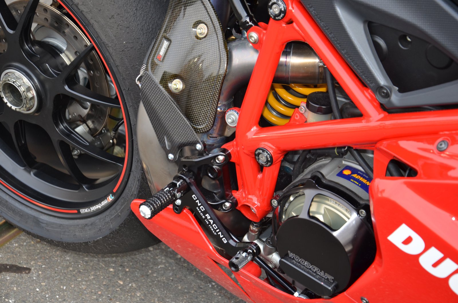

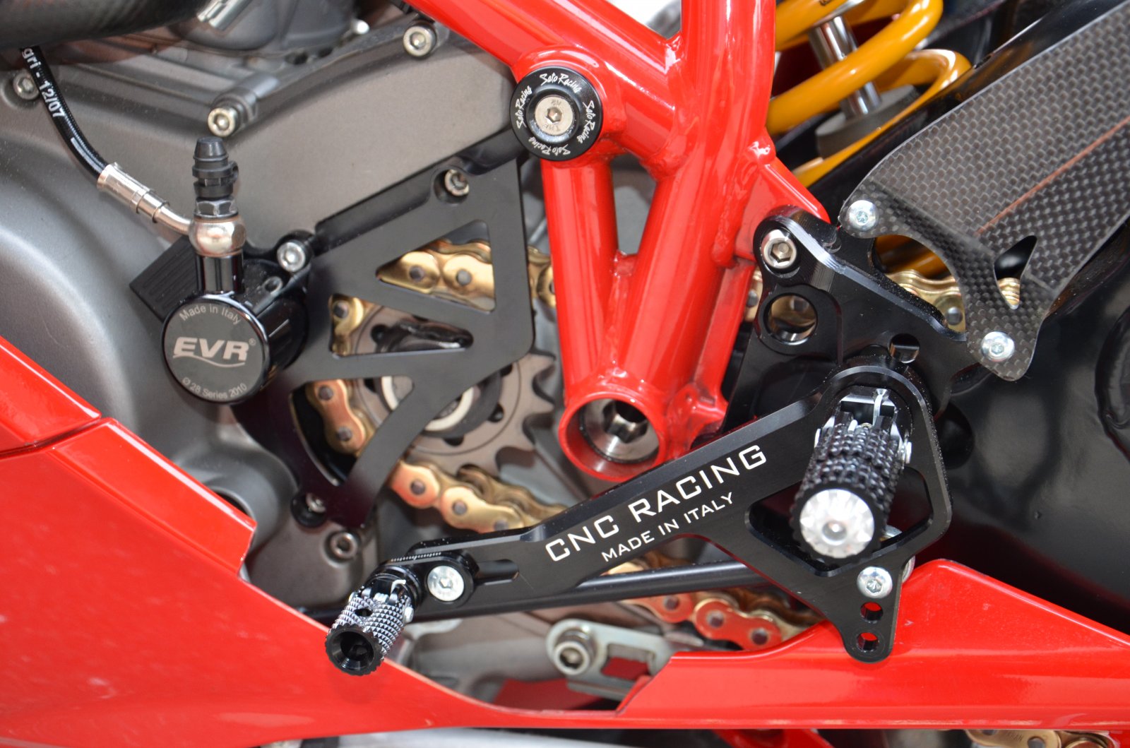

  18. DSC_1595.JPG DSC_1607.JPG OK, moving on to controls now. I've looked at a lot of the options that were available, and decided that the CNC Racing Althea Kit looked very well designed with some adjustment availability. By looking at photos of Checa's bike it also appears to be the same rearsets that Checa used and if good enough for him, then by God they're good enough for me. They also have folding toe pieces on both shift and brake levers when I'm getting over to that 64 degree lean angle... (Yeah right!) Anyway, it was an easy choice for both the Triples and Rearsets and the fact that they were black nicely complemented the new black RS swingarm too. I'm not so much into shiny look at my bike kind of bling, but I am into go fast, proven, race functionality and how that drives the design. To me, bling is factory race bikes with exotic materials; titanium, magnesium, carbon in all the right places. I love the Ducati factory triples and handlebar clamps made of of magnesium, but Damn they are way pricey! That's my kind of bling.

  20. With all the upgrades completed, I took the bike to Virginia Int'l Raceway April 8th, 9th. I did the California Superbike School with a friend of mine. The upgrades made a HUGE difference. Bike was amazing! Completely different as compared to stock. So balanced and Neutral, mid corner adjustments (when I buggered up the entry) no issue. Power down hard exiting slow speed corners, trailing it in hard on the brakes, no issues. Just poised and predictable. Absolute huge difference in the way it handled. Set suspension based on Dan Kyle's notes and my weight. Compression, Rebound and Preload, were mid range settings so there is a little tweaking to do still. I think I can improve on the turn in and quick direction change (Still a tad slow). But other than that it was a hoot! AT VIR you exit the last turn pretty fast in 3rd grear, front straight was full honk in 5th. My little 1098S was flying by more than a few 1199's and 1299's. Big smile under my helmet...
