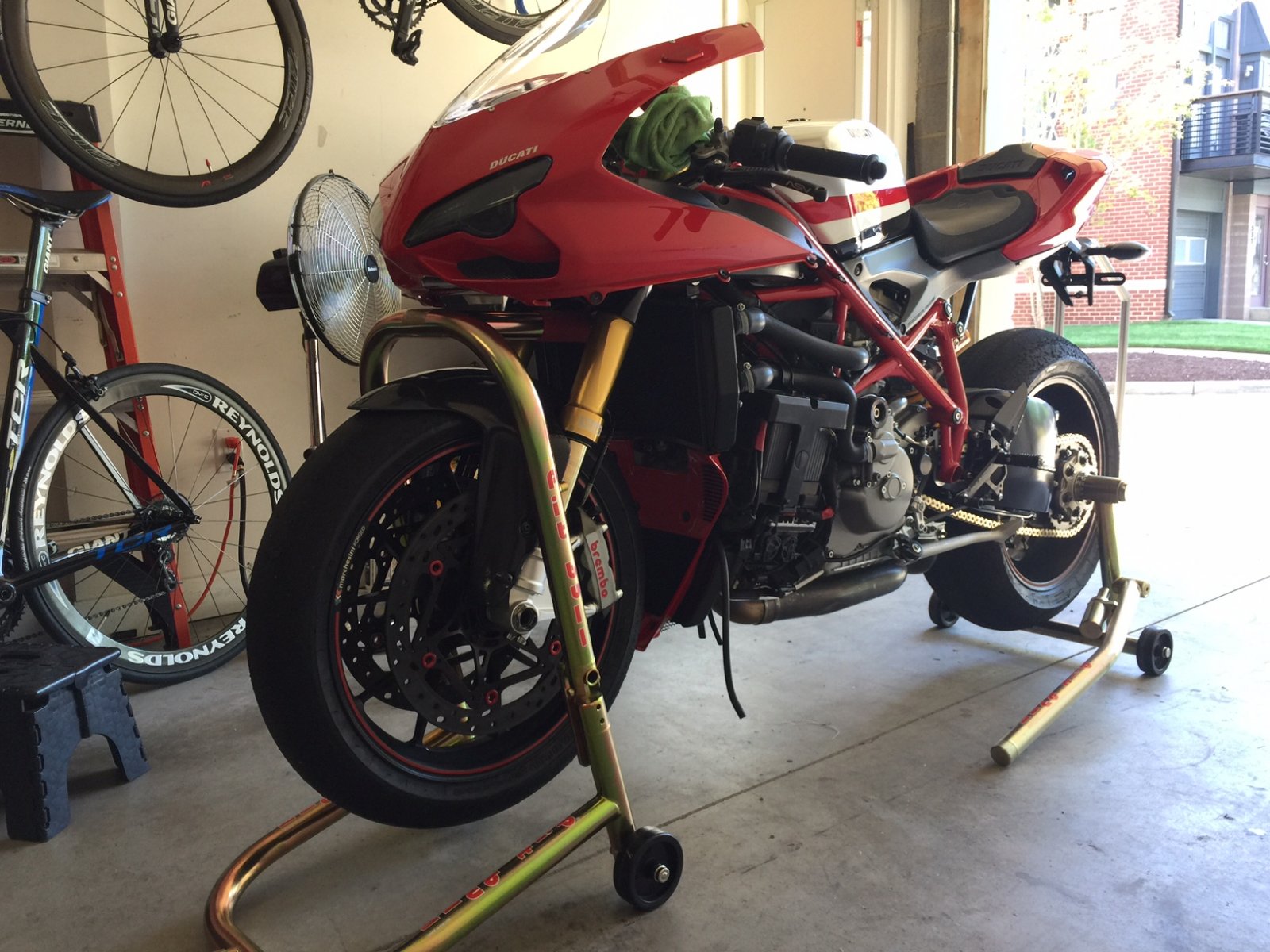

    Photo Op! Just pulled out of the garage (early May) for a photo after having been in there for a year. Still have the street front wheel/brakes on in the photo below.
    The CNC Althea Triple Clamps Center Shaft goes all the way through the bottom triple, so I special ordered a short 27mm Pin from Pitbull and Presto! front stand works! Plenty of room to clear the fender and bodywork.
