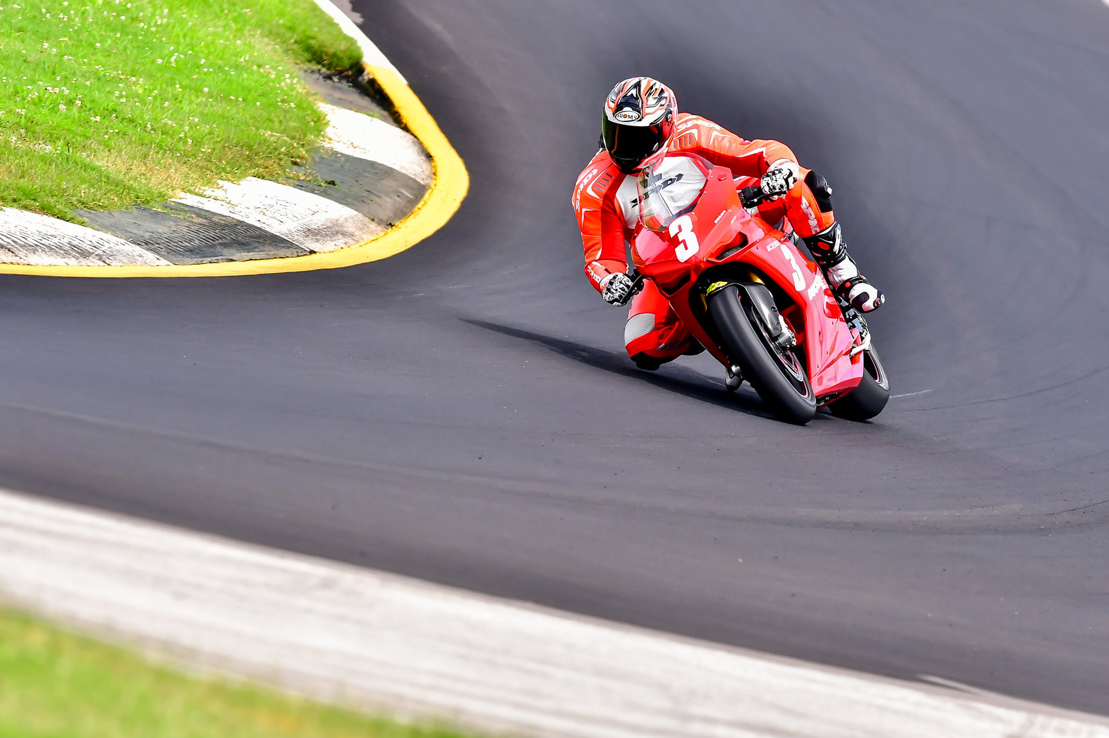

  4. Couple photos from the recent Track day at Road Atlanta. Is it just me or do the older tracks that follow the lay of the land offer much more challenges and thus rewards once you get them sussed? PRE-ROAD-ATL-20170715-115753-7453-ZF-3957-29400-1-001-008.jpg
    It was crazy hot in Atlanta, in the mid 90's with high 90+ humidity! Bike is working really well with the upgrades and recent settings. Now fine tuning has begun, may change one front spring down to provide for a tad more feel. Currently have the fork oil set at 170mm from top lip with springs and spring support removed. Under hard braking at the end of the straight forks are collapsing down to about 20 to 25mm mm front fork travel left, which seems about right. Road Atlanta has a long back straight (albeit with a kink), I was just touching 160mph (probably closer to 153/4 in reality) before braking on a downhill slope, so there is a lot of weight transfer onto the front wheel. Figure that it's not going to collapse any further than it would at this spot on the track so springs and air spring seem about right. May compensate the air-spring to 160mm below the lip to account for a slightly softer (metal) spring change.

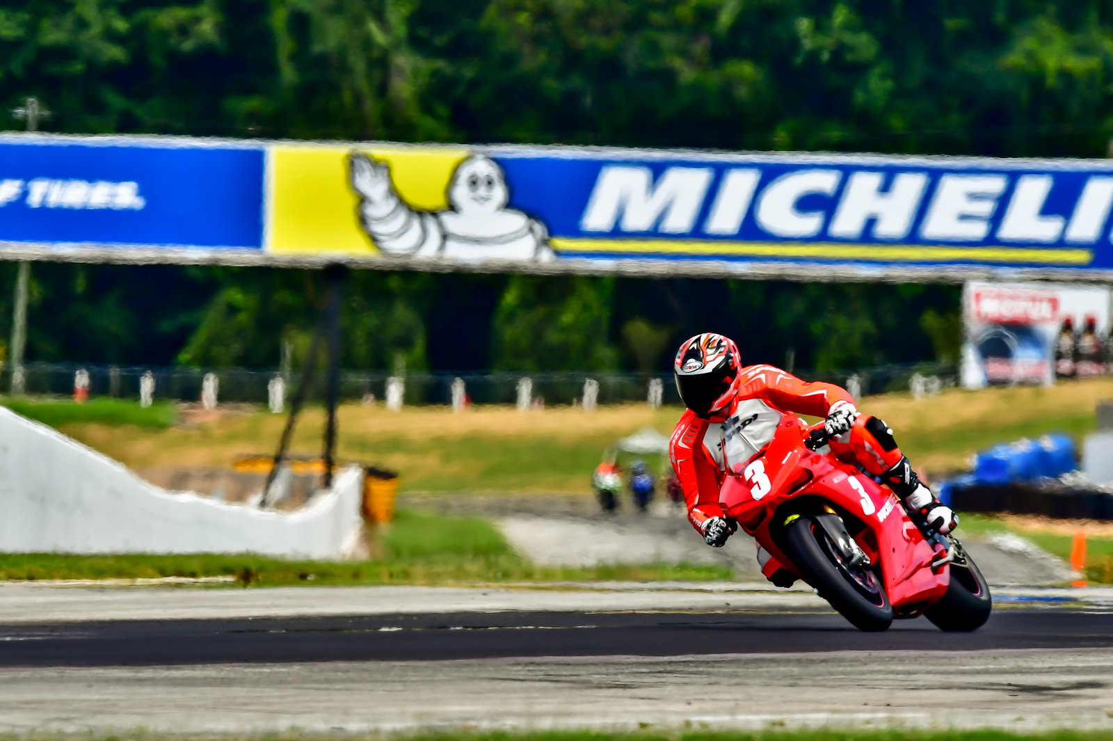

  5. One more... Tipping it into turn 1, fast uphill sweeper. Great turn! PRE-ROAD-ATL-20170715-115411-7421-ZF-3957-29400-1-001-006.jpg
