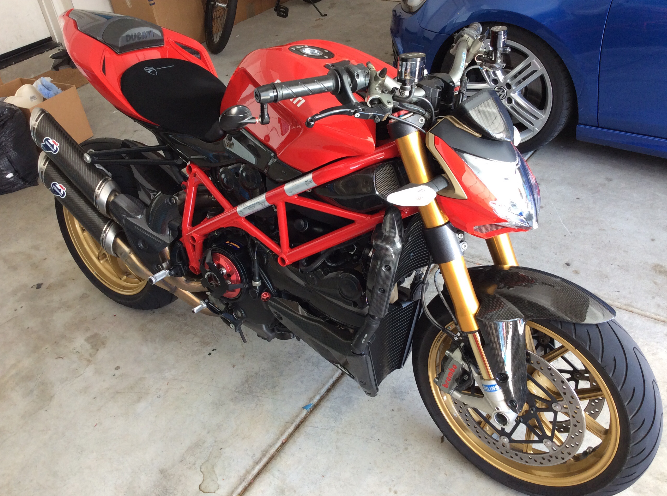

  13. Ive the 2010, Bought with 2900miles, termi's, carbon, Slipper clutch etc, Bought 2 years ago for 9k, prices are much the same at the moment for similar milage, Miles seem to determine price tbh, Luv the bike
