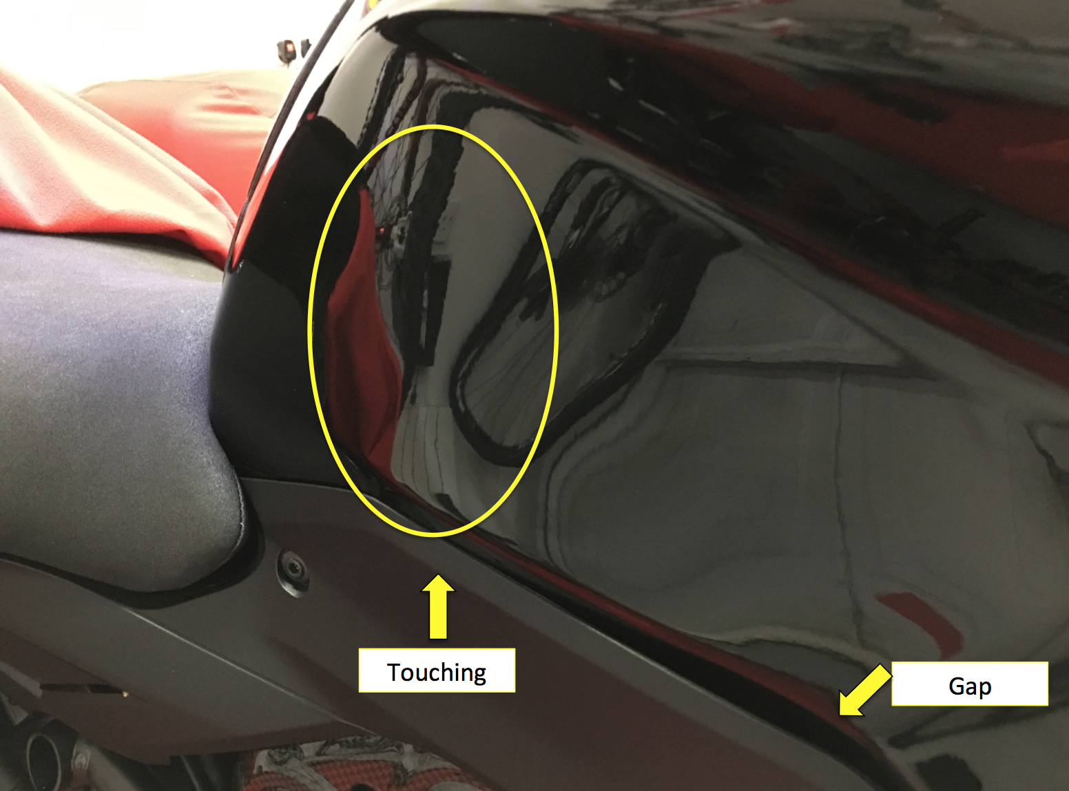

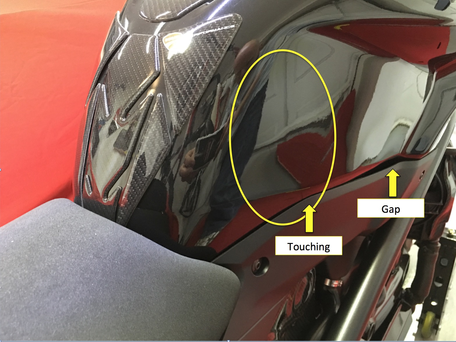

  4. My 1st tank was replaced under warranty as the bike was only 18 months old.
    About 18 months after that, it was replaced again due to this one swelling too. I had to pay for installation and I was told that this would be the last time and it was "goodwill" as the bike was out of warranty by now. My dealer pushed with Ducati UK for me as I had bought it new and the bike had been serviced on the dot. The replacement tank was perfect, but had swollen on the RHS, was touching the steering damper bracket, and key guard was also difficult to get in place.
    I now drain the tank to almost empty when I leave it.
    Oh, I asked if I could keep the tank and just have them supply me with the replacement, which I would have kept until I ever sold the bike. No go as they said it had to go back to the supplier. I think in reality, it went as far as the bin. :mad:......Mmmmmmmmmmmm bin :heart_eyes:
