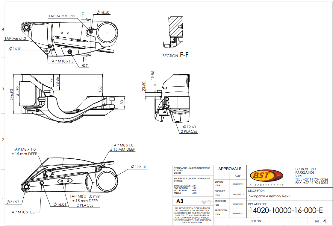

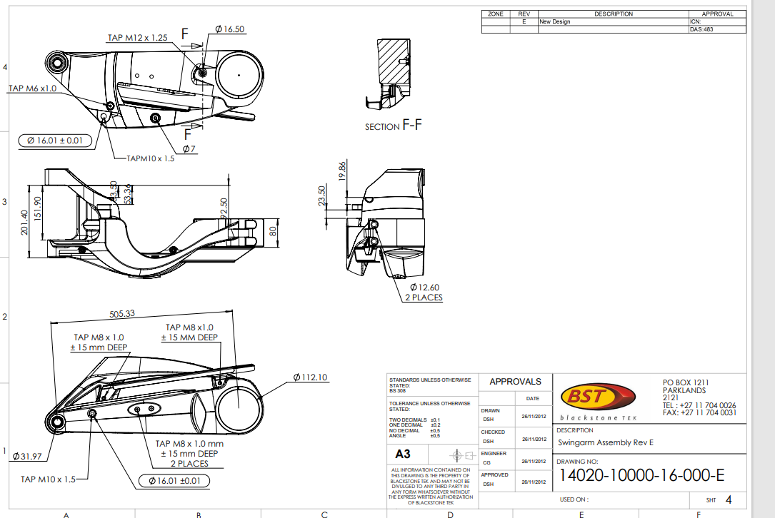

  3. Got this from BST. Note that they claim 16mm over stock. 505mm. Andyb has the stock arm at 505 for a 1098. I agree with that. So if I am reading this right for almost 3000.00 dollars you get a stiffer stock length arm. Do we want a stiffer stock length arm? BST 1.png BST 2.png
    #23 parrish37, Dec 1, 2020

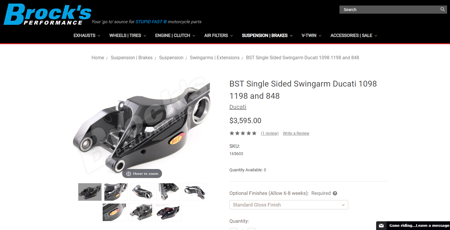

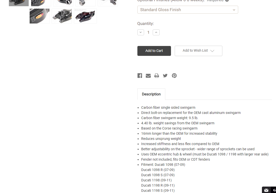

  4. Really - Nobody. Not a sole cares that a 3000.00 dollar swingarm in the diagram from the manufacturer advertised to be 16mm over stock is in fact the same damn length as t he stock one from Ducati. God - I miss andyB
  5. I have a Stock swingarm working just fine. I have an SF working just fine with 190 tire. There is no engineering required unless you choose to cut them. The BST, and FEBUR are options to the RS. The RS is getting scarce. When I talked with Brock's Performance Jeff sent me the drawings. All I am saying about the BST is it is the same as stock. The RS trades for 3500.00 dollars here. So no cost difference, just length. Again: "Do we want a stiffer stock length arm on a 1098s?"
    As for the circles I travel in. You just walk into Ohlins in Hendersonville. Riding a Ducati is expensive, Track Day riding even more, Club Racing a bunch more. Back when this bike was raced these mods were normal fair. No complicated Forest. Just trying to build a bike and pass on what I find...
