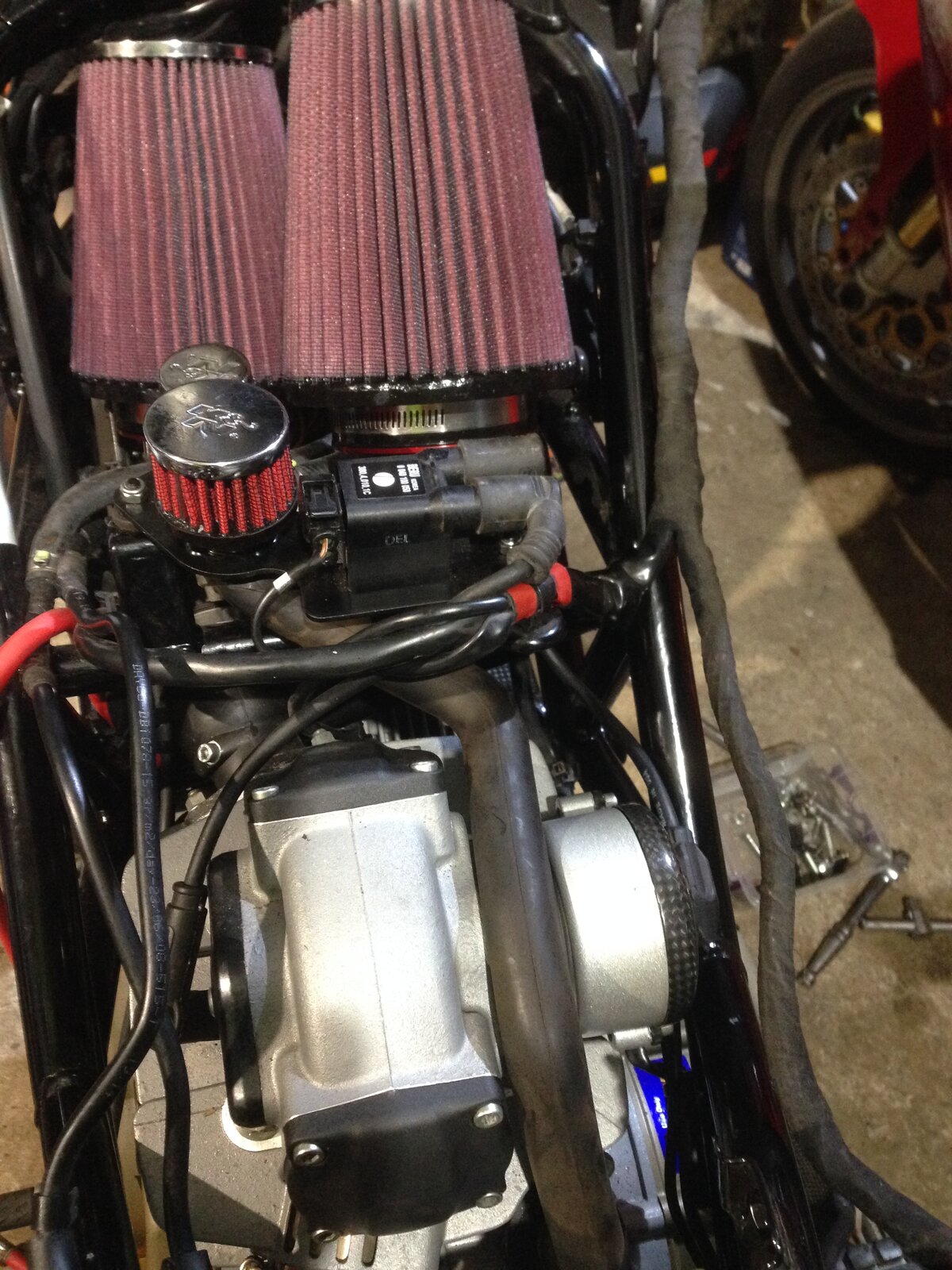

  5. Had Ducshop stacks/massive K&Ns on mine prior to fitting a Cycleworks big tank. The K&Ns that came with the stacks were way bigger than those supplied with the big tank. Stacks were beautifully made, easy to fit & worked well with the bike which had same set up as OP (underseat Termis/uprated ECU, Zard downpipe). I don't think Ducshop stock them any more but could be worth an email. I will probably take the bigger tank off at some point as I no longer use the bike for long trips (and miss the induction noise from those stacks!) I also fancy going to single silencer so am on the hunt for a titanium SC Project slip on if anyboady has one laying about the place...

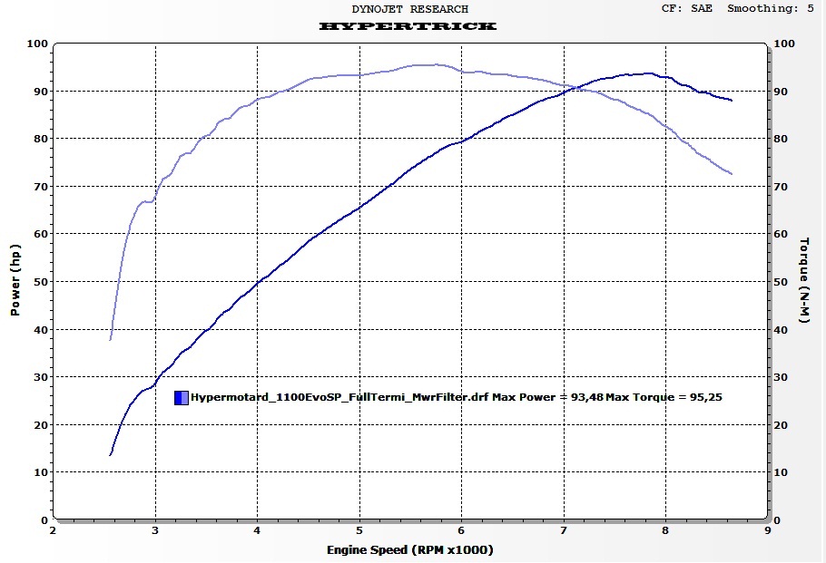

  6. The Corse Dynamics velocity stacks are nicely made and filters huge, but my gosh aren't personal imports expensive!! IMG_4560.JPG
    I was tempted by the large tank option but that induction roar is pretty addictive
  7. That afr looks lean... has it gone bang yet....
  8. That picture was taken off the screen before Chris sorted it all out! I can't find the print out of the final settings
  9. I think the Ducshop kit is very similar to Corse Dynamics, though the stacks may be a tad longer and the filters slightly shorter (and no bracket for the coil?). Can't remember how much they were - this was a decade ago and I had them sent over by a friend - but not cheap. No remap, did some Dyno time at SPR in Notts where we tried all three of available Ducati ECUs (the standard one and the two DP ones). The DP ECU meant for single sided exhaust was a good match, horsepower peaking around 93bhp and a nice fat torque curve IIRC. Since uprated with a PCV plus Autotune which should help when (if) I go to single silencer

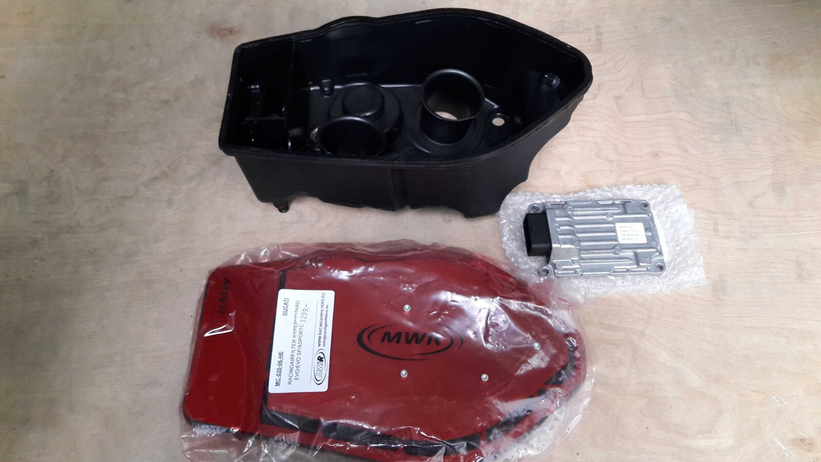

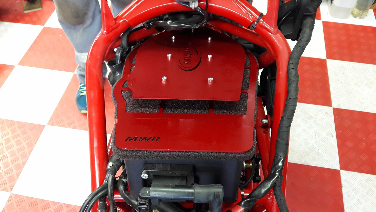

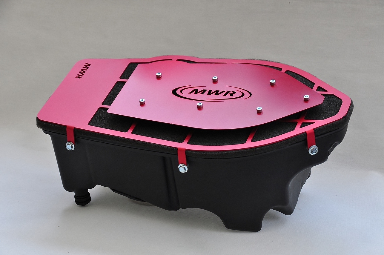

  10. I have installed the MWR Full filter and the Ecu with Hypertrick map from IBC in Arboga in Sweden. This setup works absolutely amazing and I can highly recommend it. I used the Ecu which came with the Termignoni exhaust system for the Hypertrick map. Bought me a used air filter box which is then split in the middle to be able to mount the MWR filter. What a sound it is from the intake now. I have also mounted SC Project 2-2 race exhaust systems on mine. I love that bike
