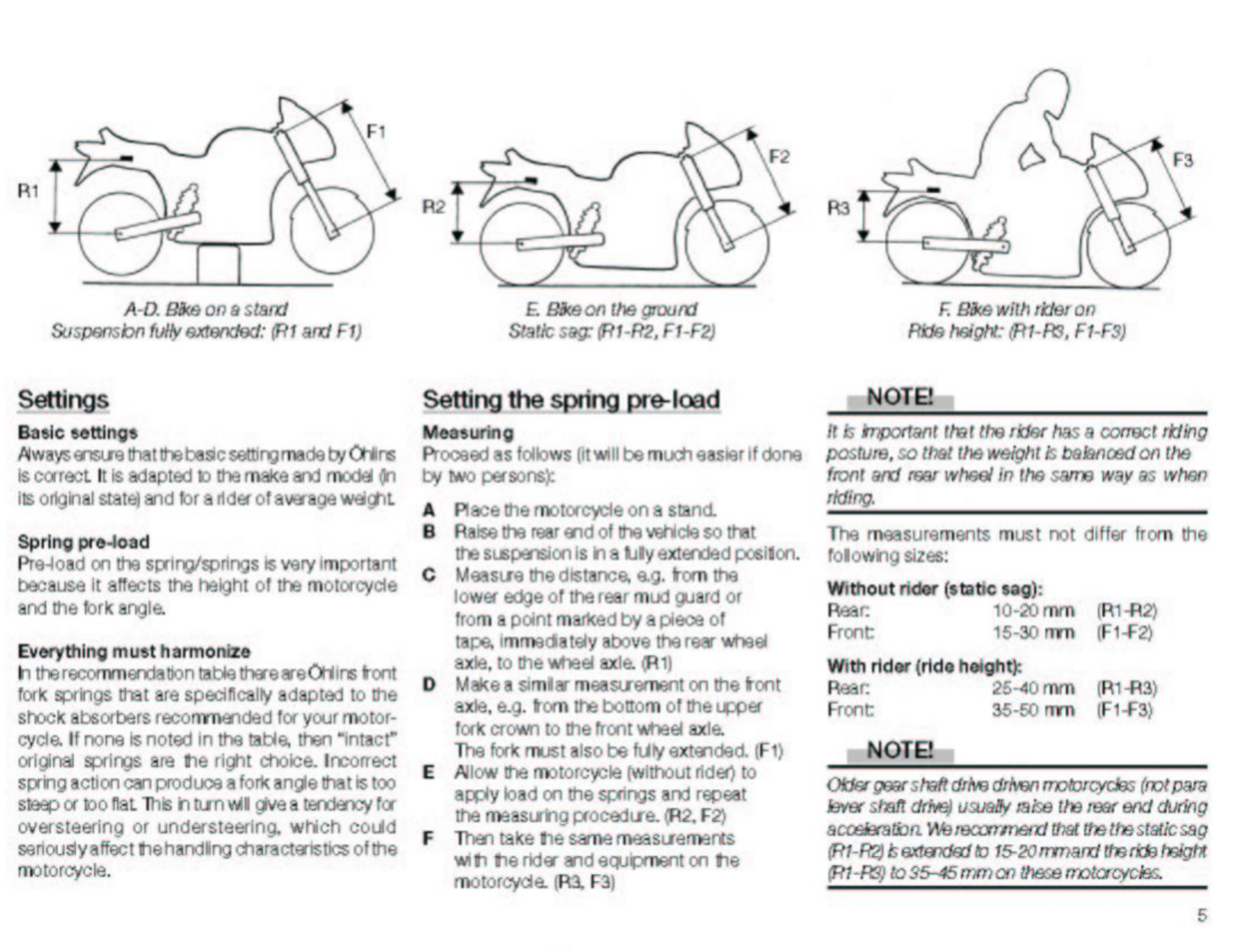

  7. Even Ohlins agree.....
  8. @andyb same basic thing, just said differently.
    Ohlins extract defines static sag as without rider.

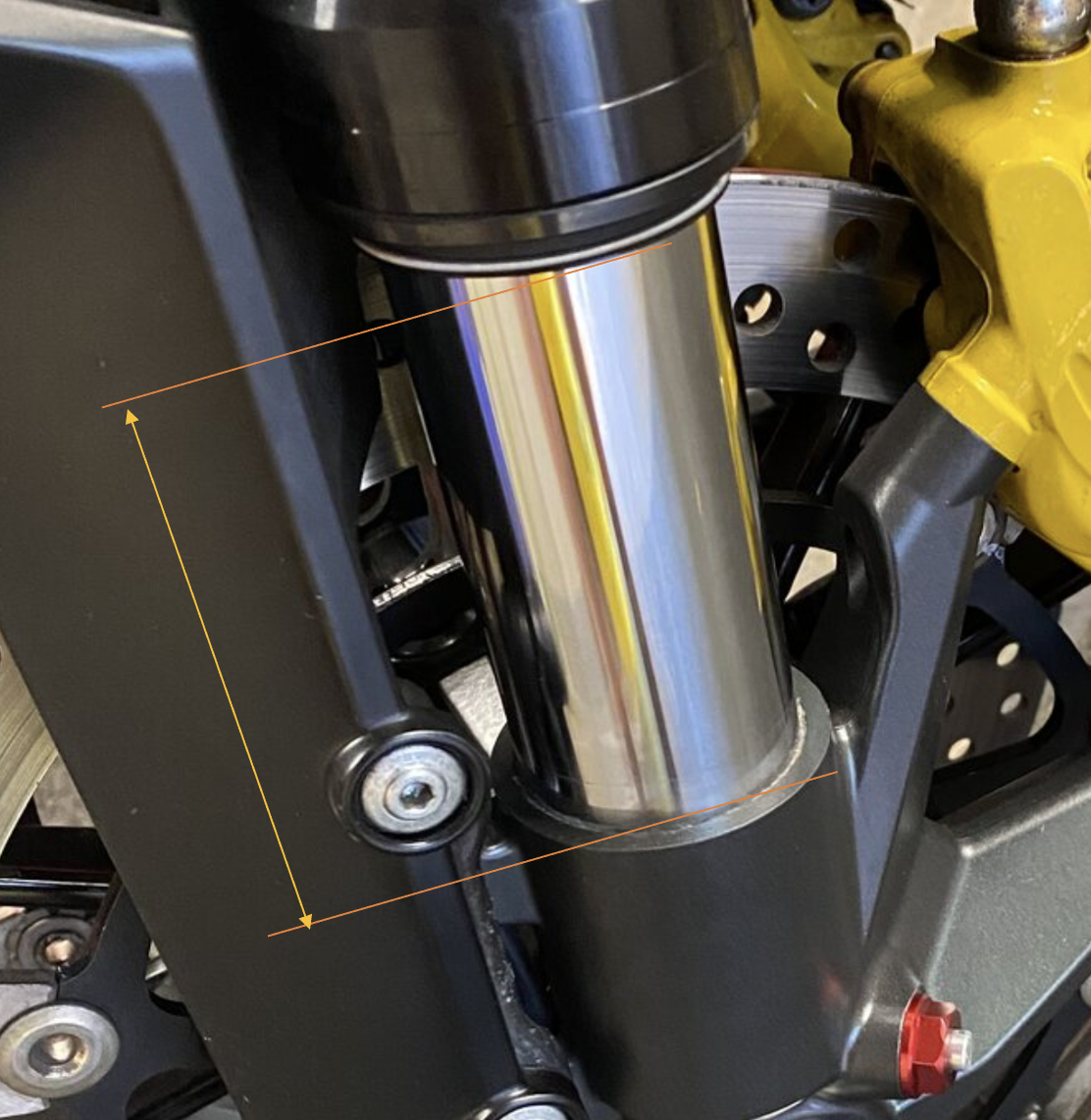

  17. So do your front measurement from the bottom of the fork outer tube just from the lip of the fork seal down to the top of the calliper mount, the full potential travel of the fork.
    You will need an assistant, or if you put a cable tie on the tube and slide it right up to the lead edge of the seal with the wheel off the ground. there's our first measurement.
    Now as Bradders says, there sort of is an industry standard that does equate to 40 at the front, or better still call it a third of the overall travel of the fork. But 40 is assuming/misinforming that the fork has a travel of 120mm. Plus the 40 is a good starting point for riding on the track.
    So measure here with the front wheel off the ground. Come back to me when you find as its a monster1100 evo with Marzocci forks the full extent travel is 130mm at our measurement not 120mm like forks on a sports bike.
    So a third would be around 44mm, if measured in this same place wheel back on the ground and rider on board.
    However, for the road with all its undulations and pot holes, I would start at 50mm so slightly more than a third.
