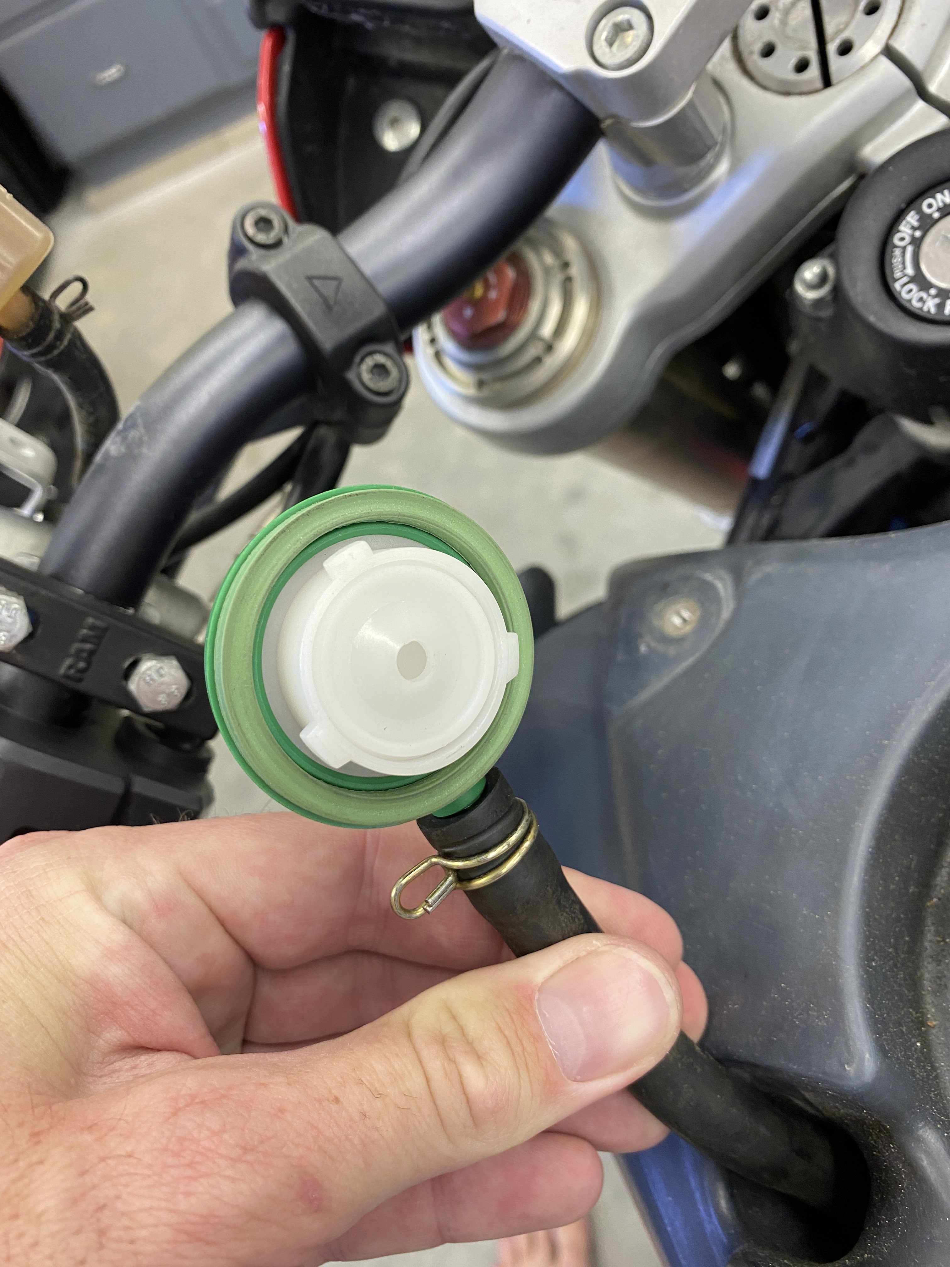

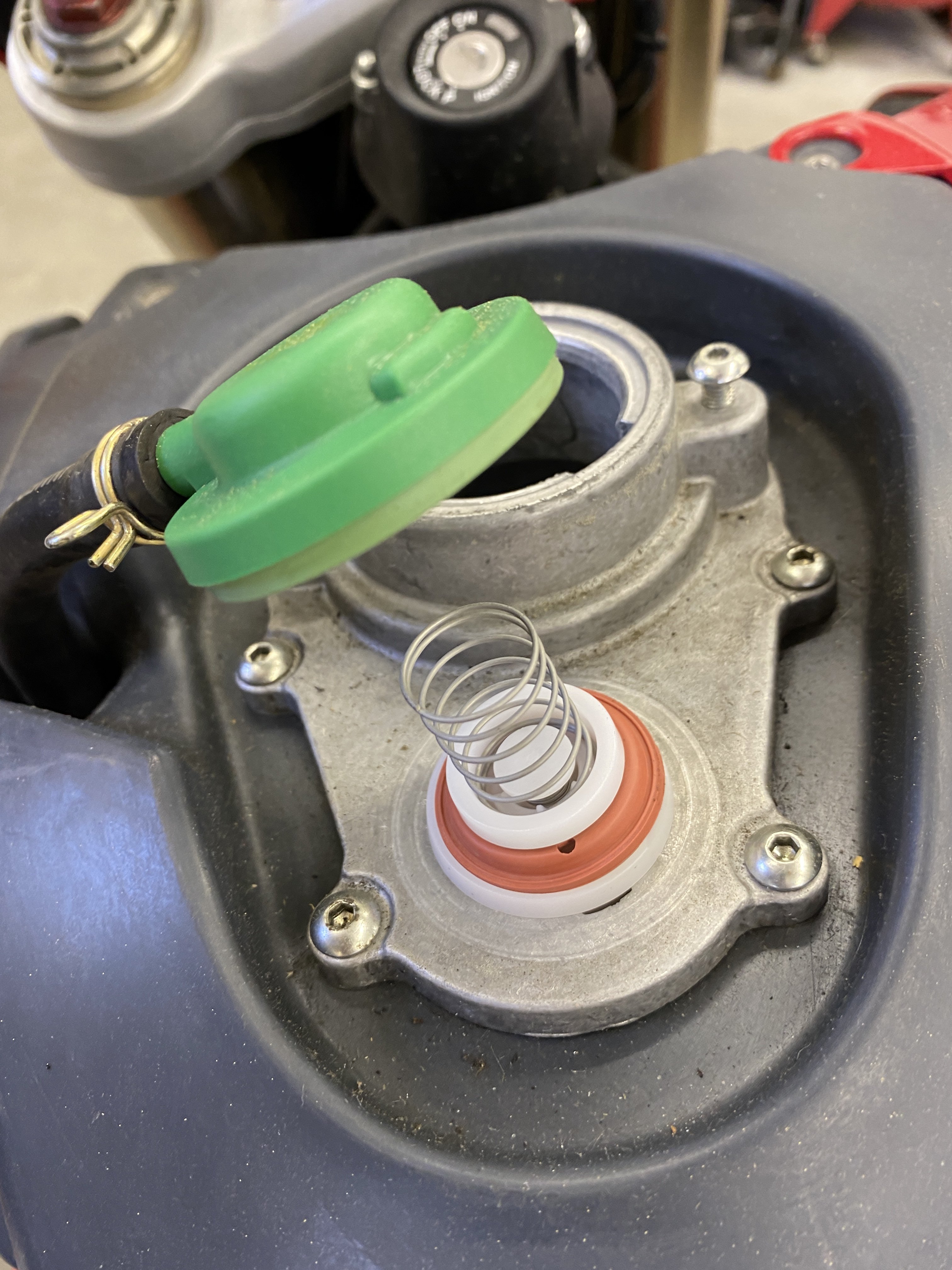

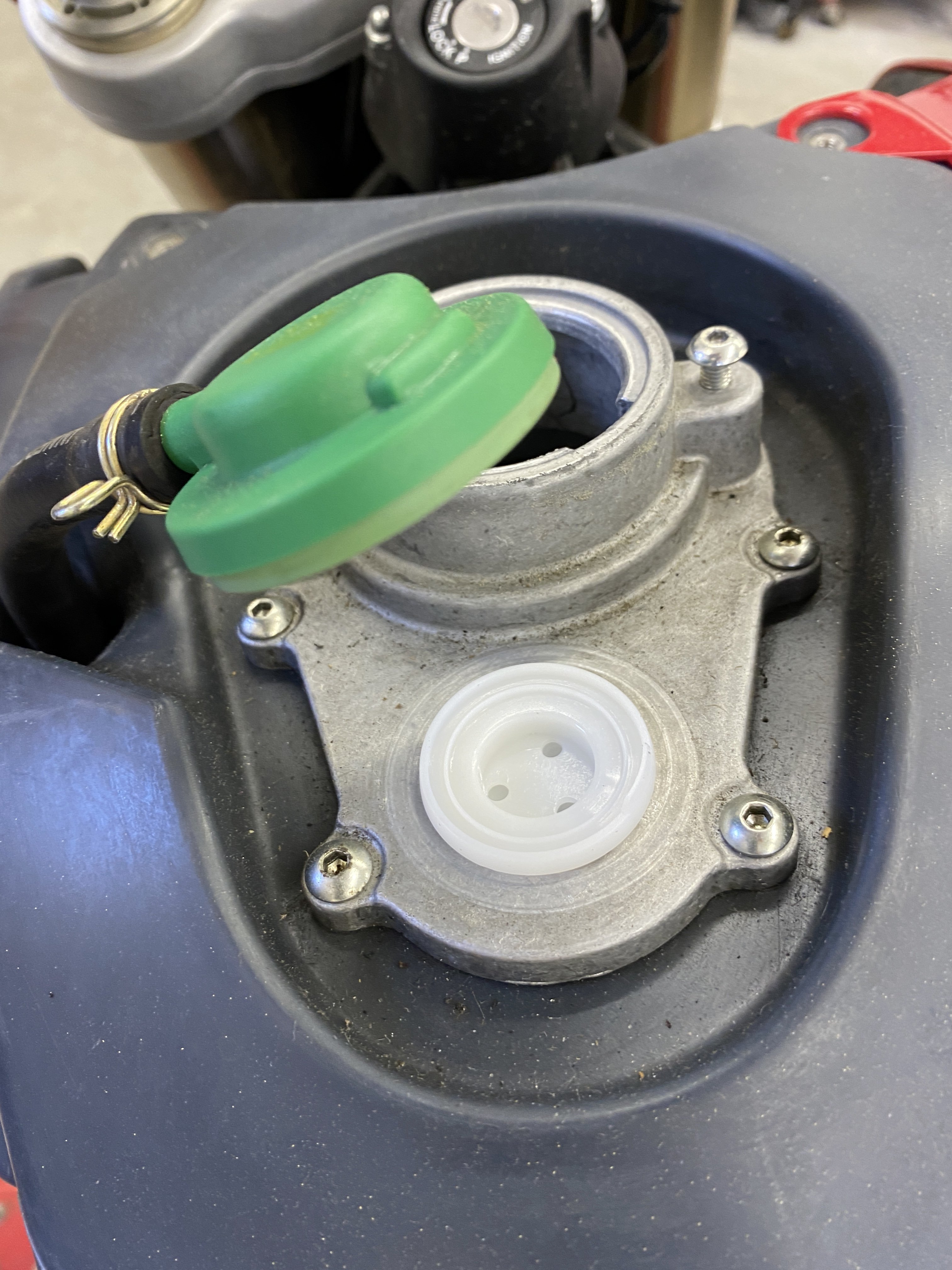

    At the same time as the gas tank started leaking, I started noticing a distinct whoosh sound whenever I opened the gas cap. I can't tell if it's positive pressure or a vacuum, but I tried checking the breather valve that sits on top of the tank. I, um, broke it while checking it, so I installed a new one. It didn't come with instructions, so this is how I installed it:
    [​IMG][​IMG]
    Did I assemble it correctly? I have to blow very hard to get any air into the tank. I also checked the rubber hose for blockages, and it flows freely.

  3. I'll check this weekend. The reason that I suspected the breather is that the tank really makes a loud WOOSH when you open it, and that is something that did not happen before I changed the thermistor (and o-ring). So I started to think maybe the tank isn't venting properly..?
    If the problem was the o-ring, I would expect the tank would leak whenever it has gas in it -- but it doesn't. It only leaks after a while, and it absolutely pisses out if you've been riding the bike.

    I can’t help with whether the breather valve is installed correctly as it’s different to the ones on my bikes. However, it occurs to me the breather valve is not working as it should, the bike runs, a vacuum builds in the tank which is causing the o-ring to be pushed into the tank due to the pressure differential which opens the seal allowing fuel to drop out under gravity. I would double check the o- ring & fix the breather valve.

    Aside from riding the bike with the cap off, can you think of how I could test this? I guess I could try and temporarily gut the innards of the breather: that way there's no valve in it, just free movement of air through the hose (and I can keep the gas cap on!)
  7. Just have a few litres (1 gallon) in the tank and ride with the cap open but over the filler, then refill and do the same with the cap sealed closed. See what the difference is. With only 1 gallon in there it will slosh around but won’t slosh out.
  8. I just reassembled the breather; I can breathe into the open end of the hose and into the tank fairly easily. I can also suck air out of the tank as well I think.
    I'll put it back together and go for a ride with a gallon in there and see what happens. I'll make sure to park it at in my neighbor's spot when I do ;) the other thing I was thinking of was filling the tank to the brim with water and see if any leaks over a week or so.
