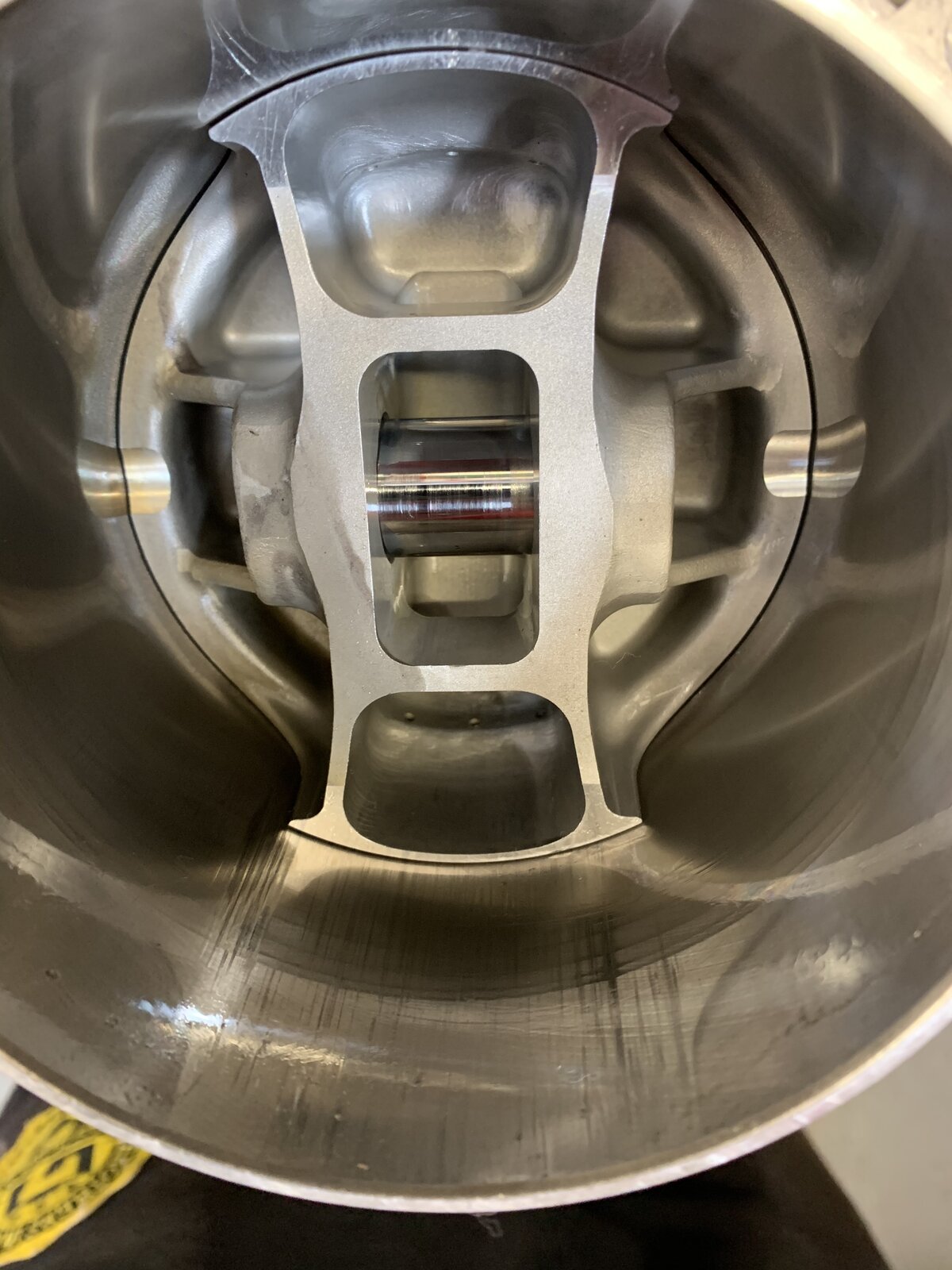

  1. Long shot but does anyone have a running 1198 engine sat in a corner they want to sell? My engine has been stripped and is right in the middle of either repair or scrap. Just wanting to see if there is anything that’s about before I make a decision on this one.
  2. What's the damage to your engine?

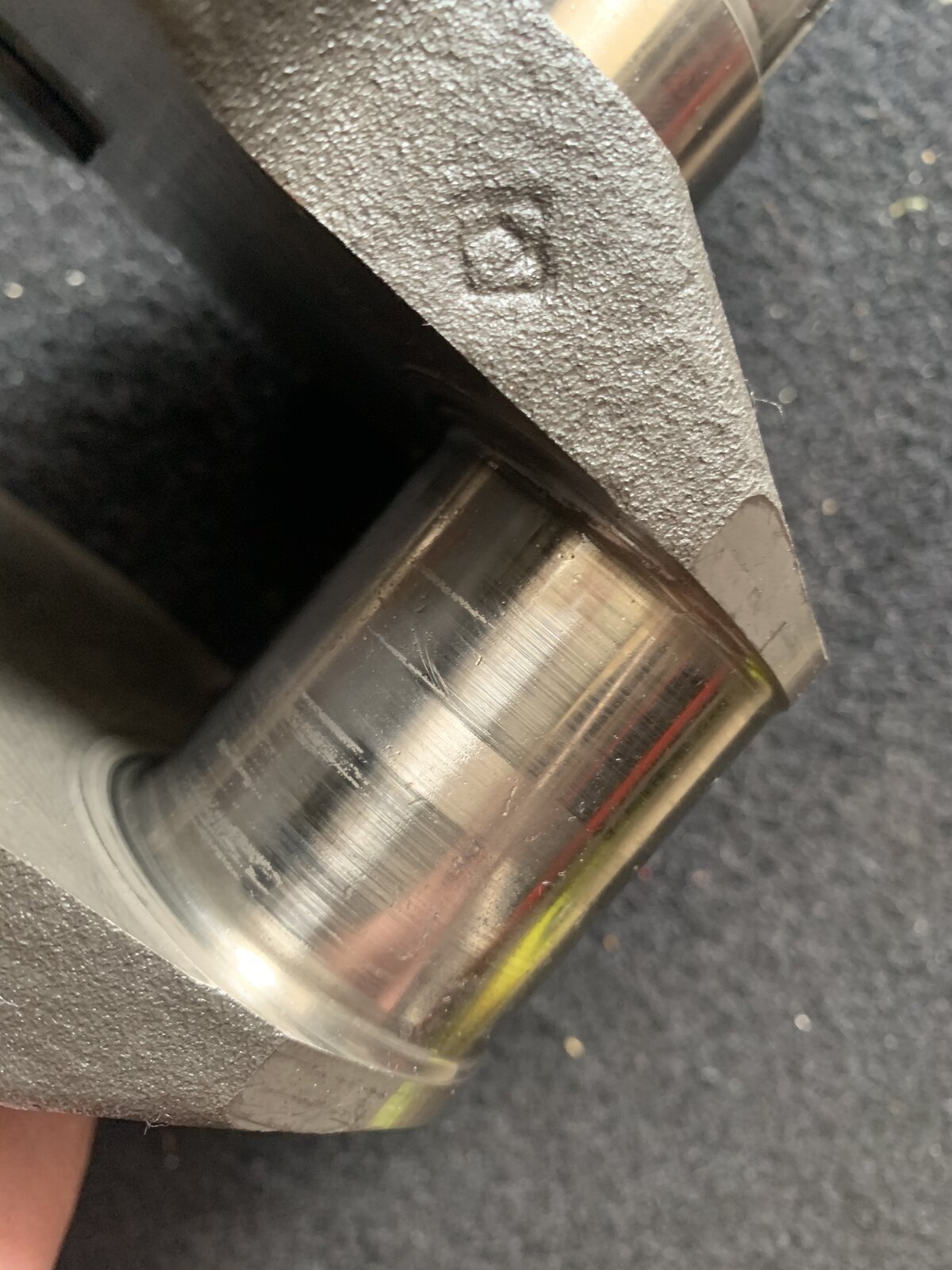

  3. Had it stripped by Ducati John. There’s some minor scoring to the crank but still within tolerance. The shells had worn down to the copper. The horizontal cylinder has some scoring so will ideally need re plating. The oil pump somehow has been scored on the pin so it doesn’t spin freely and the gearbox dogs are slightly rounded on the shoulders. Apart from that, it’s the seals, bearings and the usual parts and a rebuild.
    sadly I don’t have the skills to rebuild it so ultimately going to sell it as a project but want to see if I can find a working lump somewhere before I commit to selling it. Bike has only done 11k miles as well. Seems to have hard a hard life

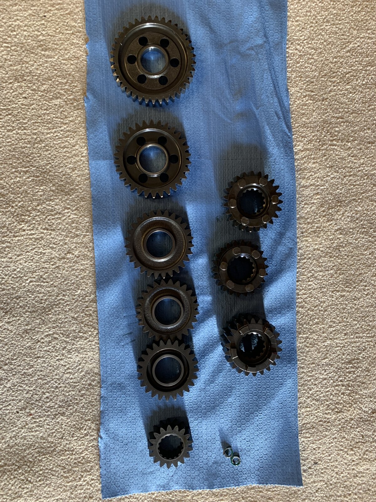

    84425097-49F7-4205-9845-1C1CF9D66A29.jpeg CC11C2A6-C069-4068-A3E2-E1DA52010674.jpeg E2200B6B-6D45-498B-B072-8858C28ABA56.jpeg

  11. No, just new shells on the existing crank. New gaskets and bearings from Ducati are a few hundred quid to be fair. And as a tight northerner I like to keep the costs down :joy:

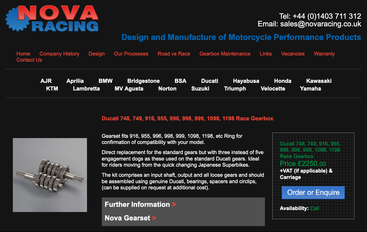

  12. And I’ve got a gearbox
  13. Balancing is 100 quid and probably the biggest bestest investment you’ll do
  14. Gearboxes are can be a weak link in these engines.
    Put back what you have, if it is deemed to be serviceable or update to bsd, if you intend to keep the bike. Even RS boxes can be fragile, due to lightness, so they got changed often.
