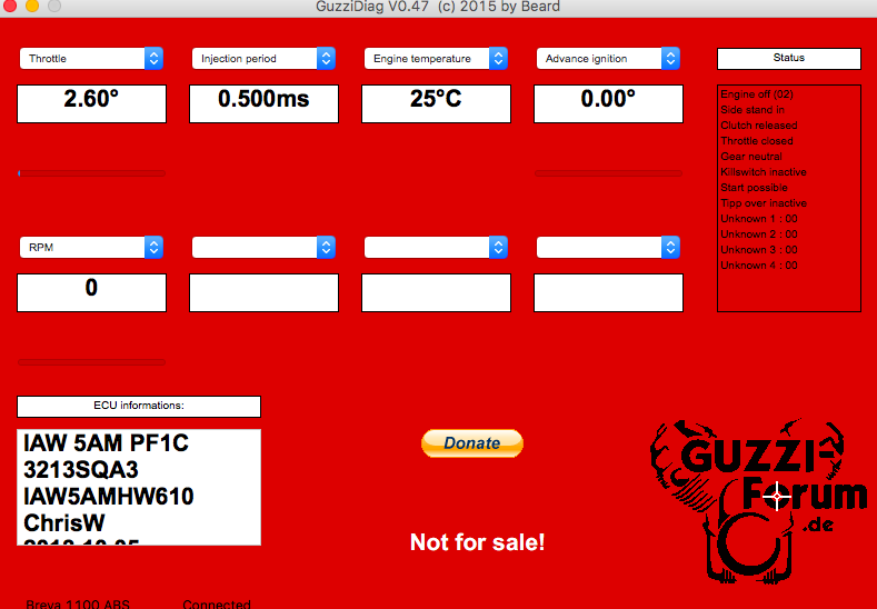

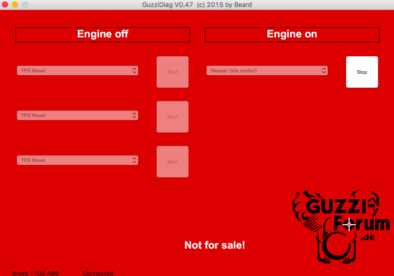

    Im using Guzzi Diag, have reset the TPS under the Actors page (see attached). There is also a setting called Stepper (idle control) which sounds like it may help my cause of high idle. Have pressed the start button on that and it seems to be taking an age, am i supposed to receive a pop up once it is done - it dd so on the TPS reset?

  12. On this page, before i reset the tps it was showing 5.30 under throttle, now half that.

  14. 2.6= TPS reset
    The Idle stepper tests the ICV when the engine is running. It should increase rpm for a moment.

  18. 2.6 tps is about what i get on my contraptions.
  19. What does the 2.6 actually relate to? Why is n't it zero for example?
