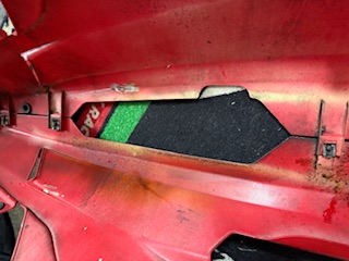

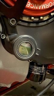

    just wanting a bit of help with my infuriating 1198. Had it rebuilt recently and it’s running great but I have a recurrent oil leak on the left hand side and I cannot for the life of me find where it is getting out. Please see pictures below. I think it was leaking here before its bottom end let go last year though I don’t think the 2 are related. It’s been fully rebuilt now with a new crank etc.
    Any ideas welcome,
  2. Could it be seeping out along the alternator wiring? I have this on my 1098R. I tried to seal it from the inside where the alternator wires exist the alternator casing but it still has evidence of weeping down the loom and drips beneath the battery box near the rectifier.
  3. Thanks for replying, That was my original thoughts, it just seems like a lot of oil. How often would you get visible oil there? This was rebuilt in April and has done about 300 miles. It has been tracking up the loom but I don’t know how much is typical of this type of leak.
  4. Bingo, looks like there's a very good chance that the culprit has been identified, and if so, Thank you Richard :upyeah:@RickyX

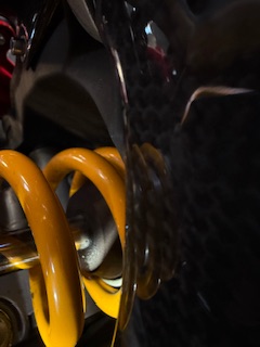

  10. So I cannot see anywhere where oil has leaked from the engine. What I can see is a bit of oil at the bottom of the shock and on the swing arm. Has anyone seen this amount of oil getting out of a shock?
  11. Hydraulic oil usually has a different smell to it than engine oil. Put some on a clean cloth and smell it, away from the bike and workshop.
  12. Also. If you had lost the amount of oil from the shock, I would expect it to have reduced damping.
  13. It is certainly leaking, I just hope it is just the shock and not something else as well. It hasn’t really affected the performance as I have only been pottering on the road. It was serviced last year as well.
    it is a yellow oil and the engine is green. Also feels like a lower viscosity.
    hopefully this is the source of the problem and I don’t have an oil leak as well lol.
  14. The plot thickens, how high is the fluid in your clutch reservoir? all you can do is try and eliminate anything else, if you are certain that it isn't engine oil.
  15. they are all normal, but i will double check.
  16. so looks like it is leaking down the generator wire and the shock is also blown. I did upgrade the generator with Electrex last year so checking if they have a fix. I may just have to tolerate the weeping on the wire. Getting the wires trimmed back glued up and re soldered to see if that works any better.
  17. I'd be more concerned about the 'blown' shock rather than an inconvenient oil weep.
  18. Shocks out already and off to Kais to get it rebuilt. Suspect it’s just a bit old and warn, hopefully it’s a straightforward repair.
