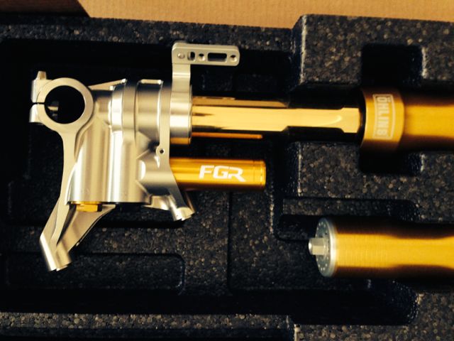

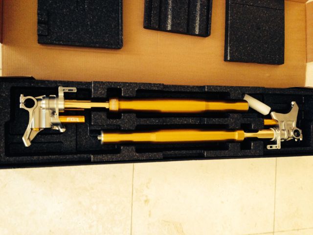

  5. So, here are the forks - Motogp/WSBK spec 2014 FGR300!
