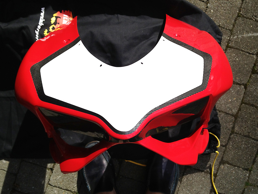

    got the livery back from the painters and all looks great ... took the opportunity to have some matt pieces redone glossy... should go on before we do the trackday at Brands.
    there is also a bit of a modern twist to the oldschool theme... should bring a bit more balance in the white part of the head fairing and a small reference to the R theme as the black lines now follow the white stripes the R head carries...

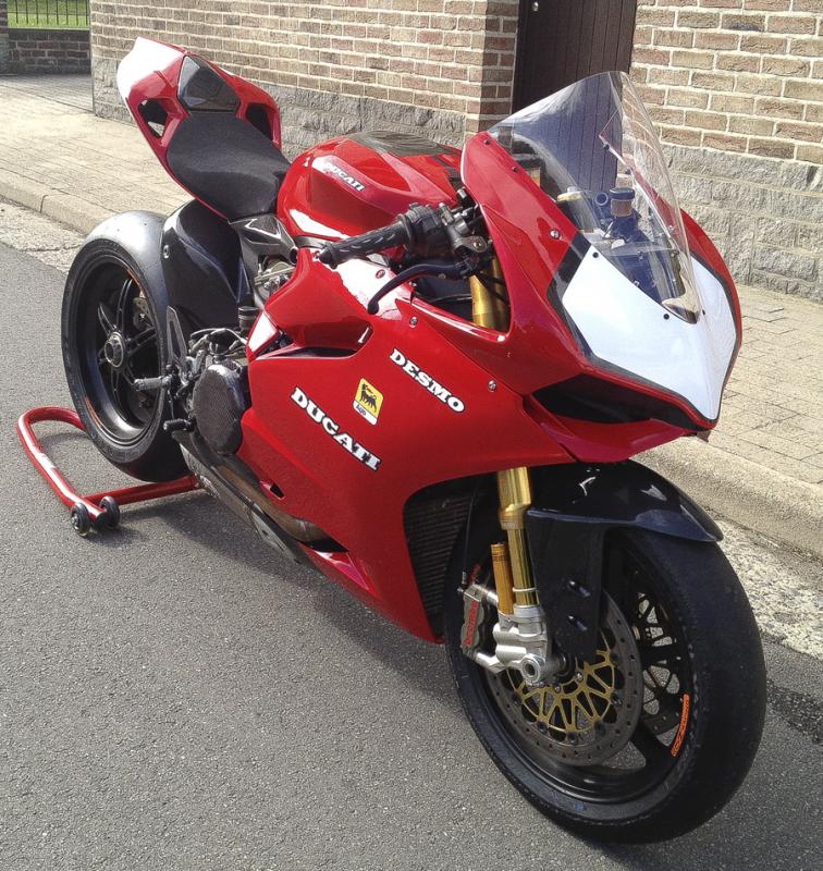

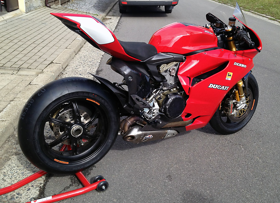

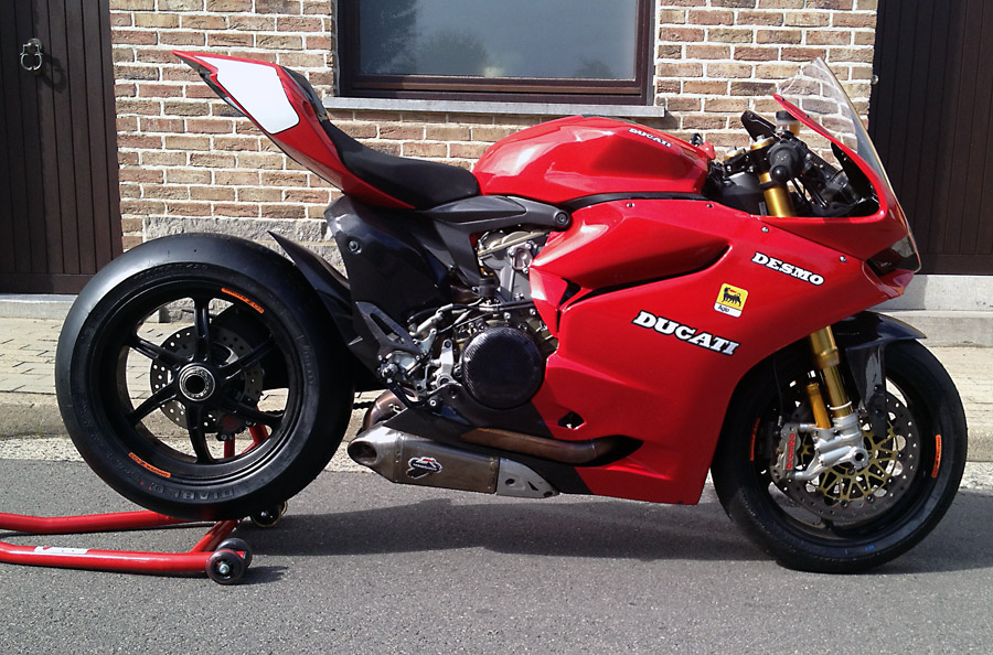

  13. for the money: it's a better tool but i won't make that happen. a bike like this one ran 0,5 seconds to the lap record of SPA... so i know it can do wonders in the right hands. those hands are not mine...
    but, apart from the last few K because of the drop, i enjoyed this year every inch off the way...
    i build my own RR before the factory did i i'm pritty sure it's one of the prittiest out there... :)
    i ve had a blast on her with some great company, met a lot of great people and riders and still have some great days to go this year..
    just booked a day at Hockenheim on the 30th...
    just look at her and ask your question again.... :)
