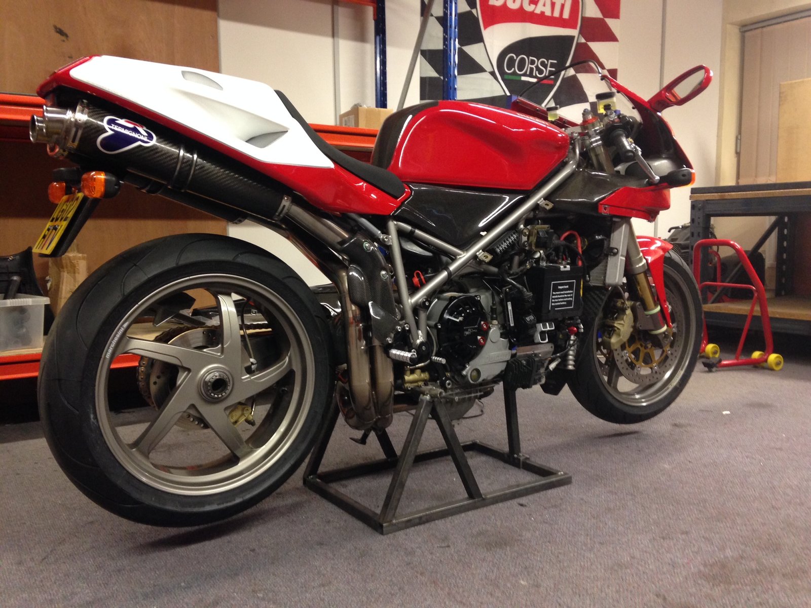

  1. Never seen an uncovered pani engine so not sure... I made this at work for the 998. I’m sure you’d be able to do the same kind of thing using any available spaces / holes.
    Ian

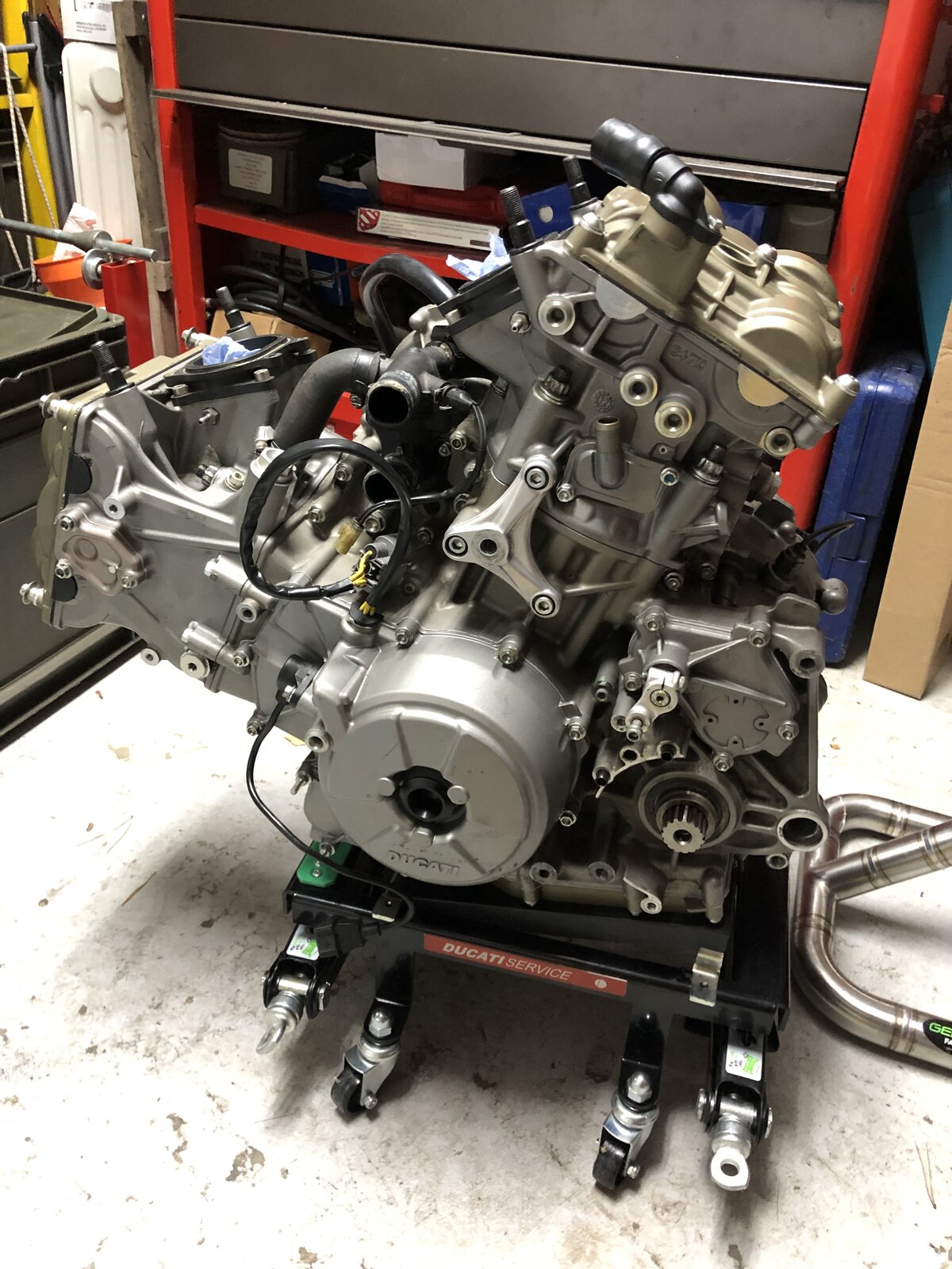

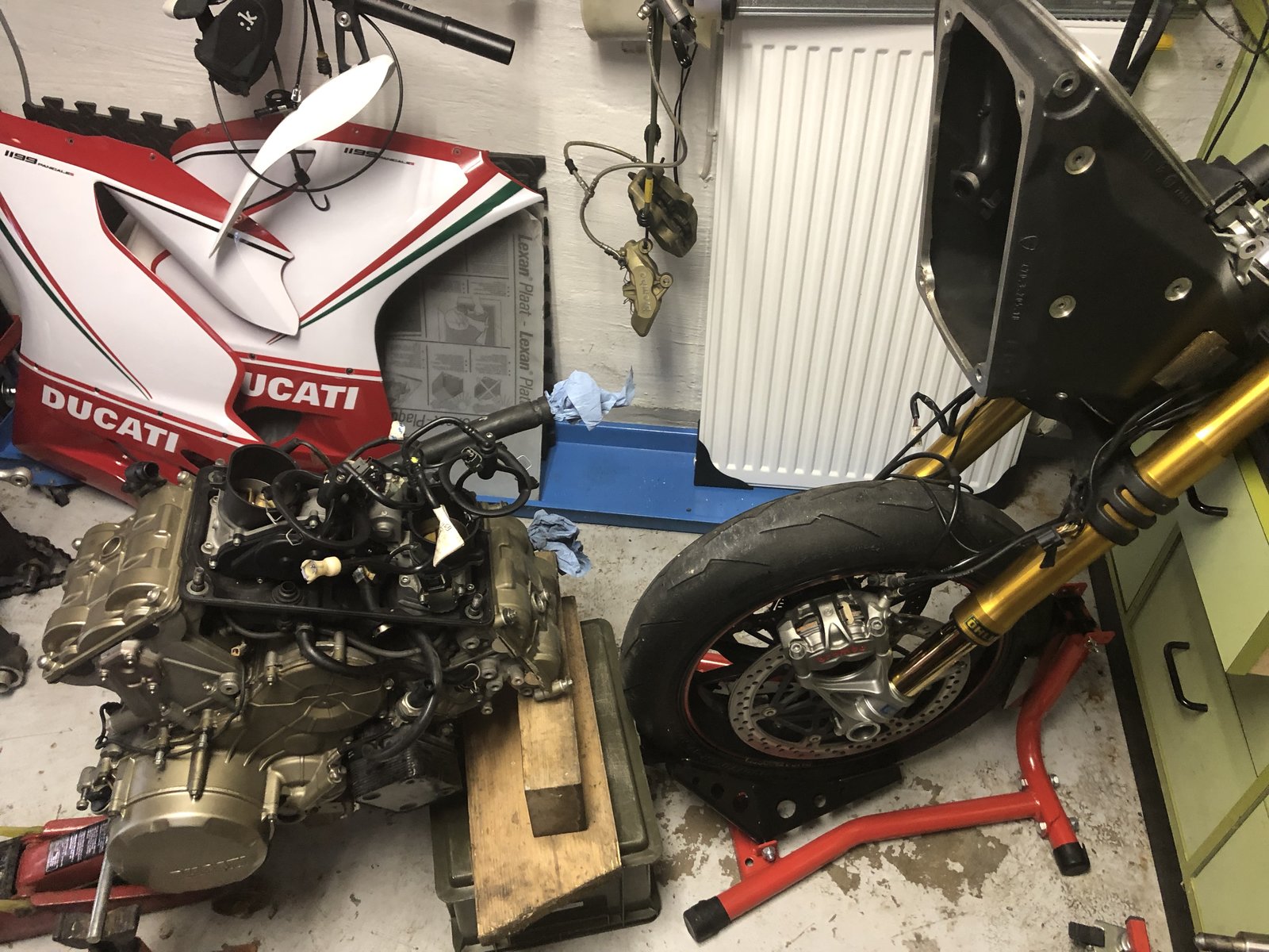

  3. Motor is out, and a bit of a wait until I get back home to see what the damage is...
  4. But a few bits and pieces to get on with...

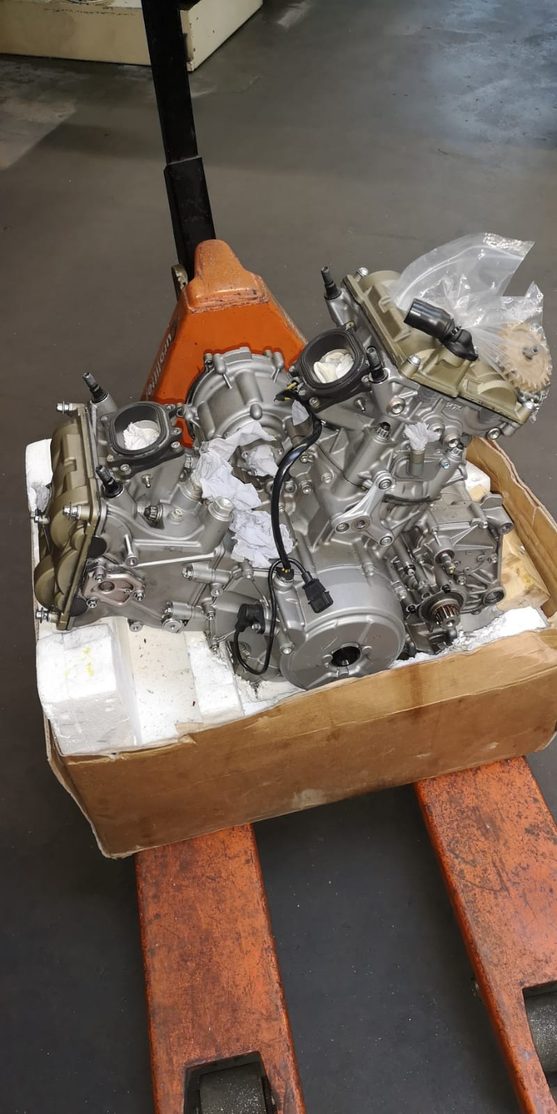

  7. so bit of an update, finaly got an update on the condition and spares list needed to put the motor back into service..
    vertical cylinder head exhaust valves, both pistons, main and rod bearings and a full gasket set,
    but i have costed up replacement head and pistons and have bought a motor to act as a donor...
    should be delivered on the weekend, lets see how this goes ... Fingers crossed.
  8. This arrived today, tomorrow’s task.. head removal.. fingers crossed

  10. Good point, but this motor as a leak between the casings, so will have to come apart anyway.... so 2 will make one... hopefully

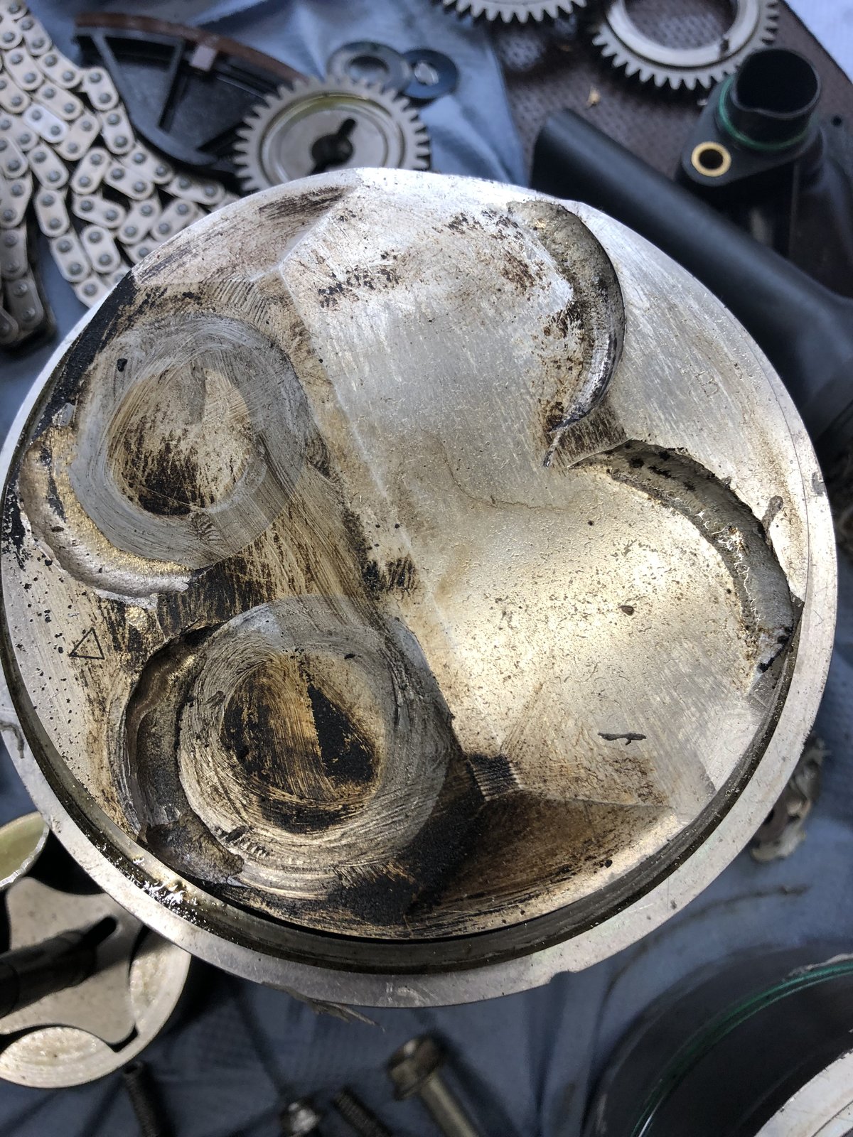

    But good news so far is the cylinder heads looks good and clean, and the pistons should be able to replace my damaged ones.
    Pistons were about 680 euros each new x2 plus head repairs and valves and the spare motor was 1000 euros, so it’s looking like a good option so far.
  11. Damage to the vertical piston on the old motor

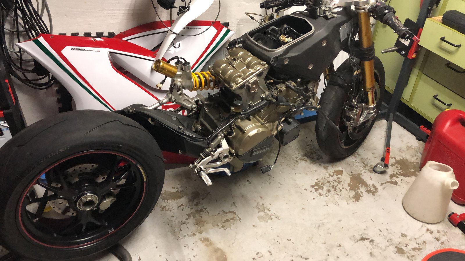

  20. so just to recap-
    i bought the bike late last year as a non runner, engine was taken out and found that the vertical head valve guides were broken and Oil was in the exhaust manifold.
    i pulled the trigger on a second motor as a donor, delivered to the door for 1000 euros...
    this looked better than mine, and as per the info from the seller, just overhauled.. minimum km and removed for a tuned motor.. #bulls§§t as the bike must have have had issues as we found a hairline crack in the motor casing..
    so pick and mix time..
    The original motor was used as the base and just vertical head, pistons and a 1st gear was swapped over and a set of Carrillo Rods fitted, new bearings and seals gasket all round..
    and this is where we are today, motor back in my hands, swingarm on already and tomorrow frame and forks so i have a rolling chassis again..
    lets see what else i uncover along the way..
