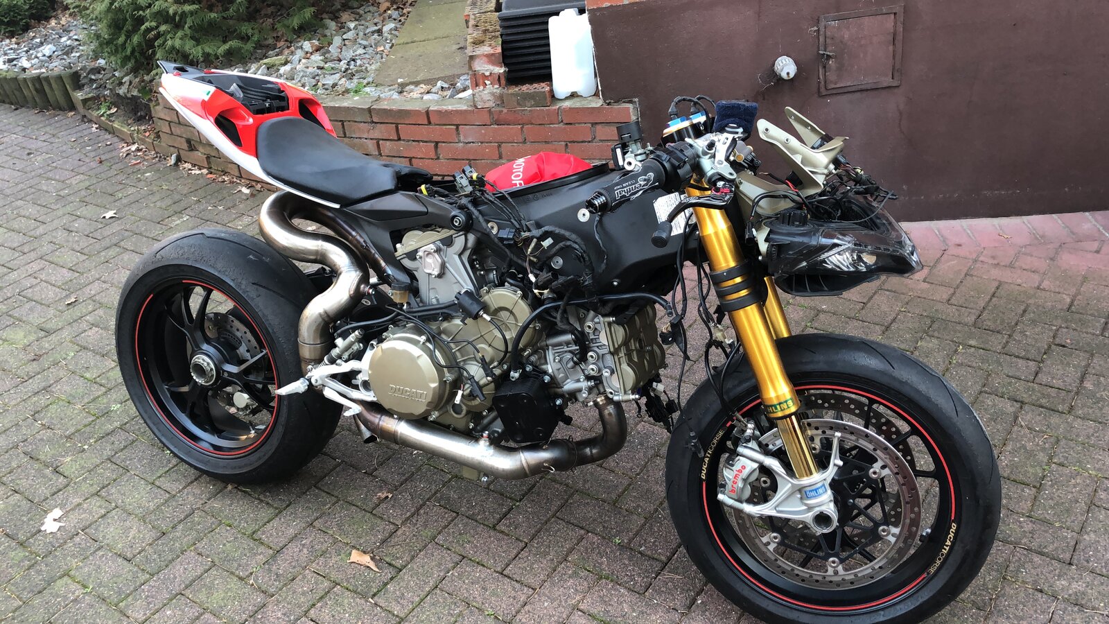

  3. A little progress.
    So next dilemma-
    Non Abs bike and the loom is a bit scruffy, there have been a few ‘mods’ to it, and a relay for the fan (I think)
    I have a nearly new 1199 a abs loom, will it fit without putting error codes ? Hmm time to do a trial fit I guess...
  4. Well she now runs..
    I made sure to spin the motor over a good few times to make sure Oil was where it is supposed to be..
    Next question..! How do i find out what Up- map is installed as no stick was given with the bike and I can’t upload the dp3 map I have without removing the current map.. oh the joys.!
    I might just have to put the RB Evo on with the current configuration, and see how it goes

  9. so a quick update,
    i cant get the bike to run happy yet, small throttle applications make the bike shut down, so i need to inspect the wiring loom.. so off with the fairing etc
    im getting MAP errors even if i swap over the MAP sensors to new ones from the shop..
    worryingly the bike has an external analog relay fitted, and i guess this is a Fan switch mod, so this will have to be stripped out to check for shorts/open circuit..
    i can see me just ordering a new loom if i cant see anything that jumps out as an issue..

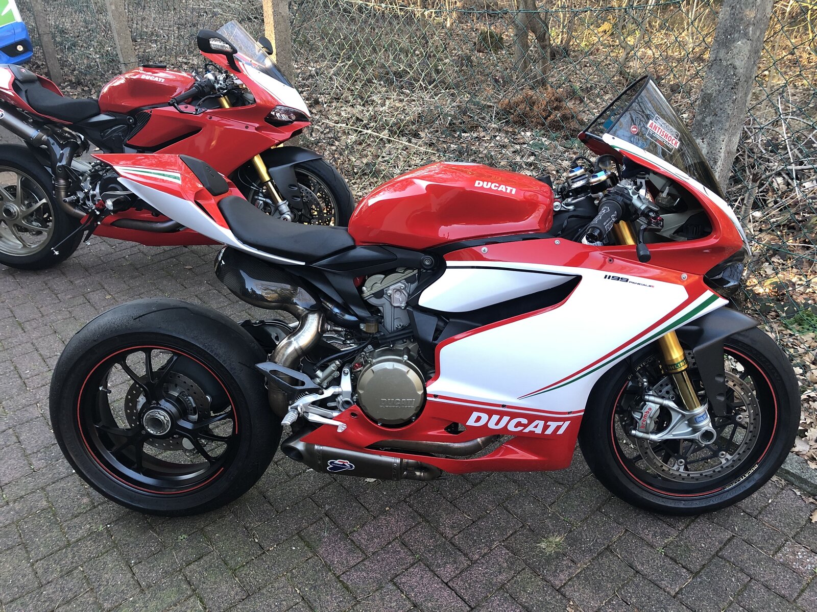

    engine refit etc went without hitch, just a realisation that the previous owner must have had issues with over heating and decided to have a go at inserting a manual fan switch. Not a big issue, but the manner of which the install was done, and the numerous Loom wrapping damage pushed me towards fitting a an ABS version of the loom to the bike ( i had a spare one in a box of parts.)
    so the original Loom was removed and a second hand ABS module, without the hoses was fitted.
    bike starts, runs, but still throws a speed sensor warning, so to save extended messing about, when i get home ill take it in to the dealer to plug it in to the Diagnostic unit to see if the sensor is 'kaputt'
    once i have it up and running with no issues, ill revisit the original loom to see what can be done with it in regards to repair and refitting, as the bike was a non ABS model, and ideal for the track.
    • Useful Useful x 2
