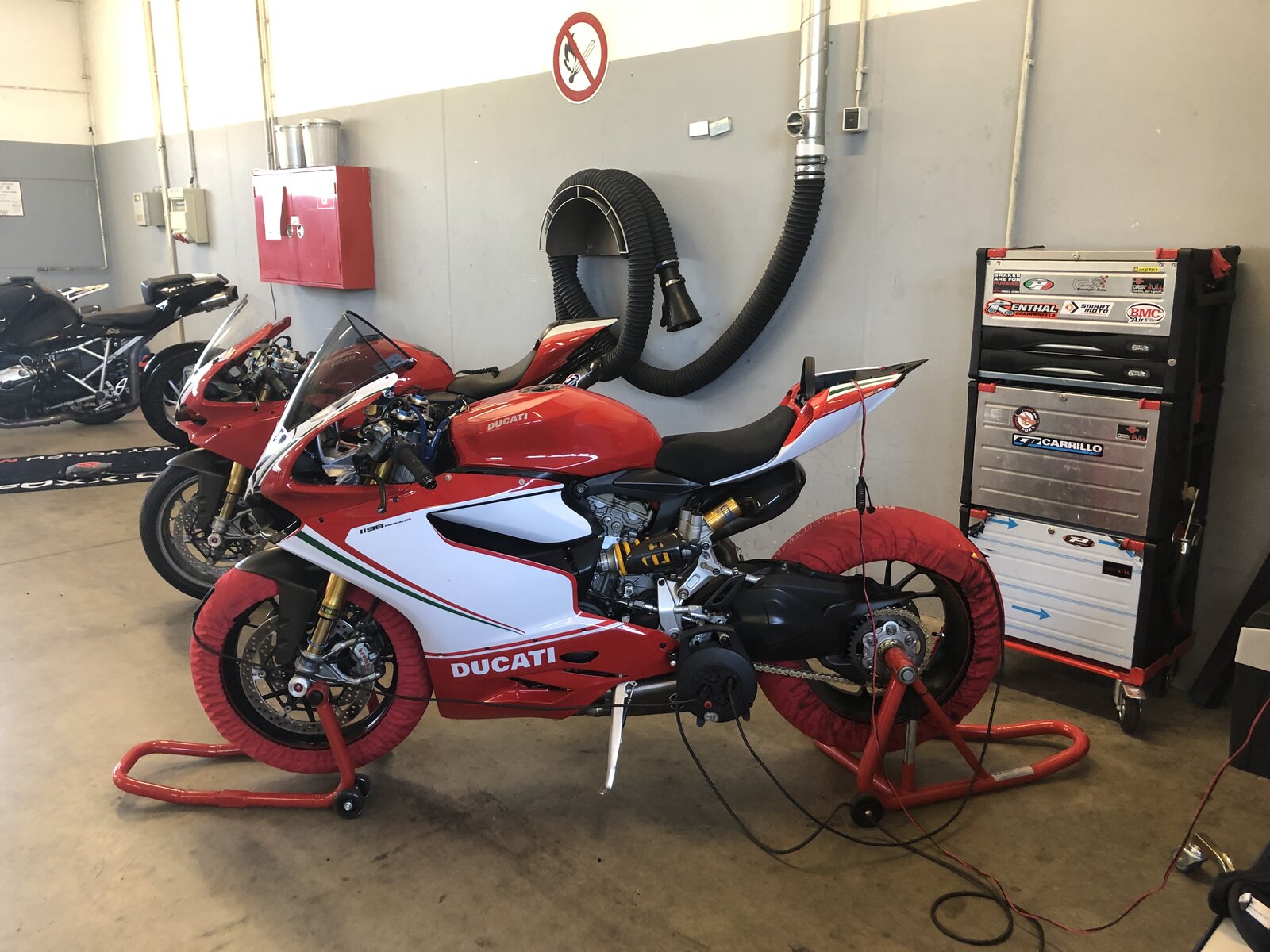

  1. So i thought id make a quick update,
    i got the wiring Loom back from UK after a having it checked over and some small repairs to the Run Stop connector and headlight cables, and the bodge job wiring for an external fan switch.
    on the rebuild i found a lot of corrosion on the Earth cable, cleaned and all fitted, and all the error codes are now cleared.. result, bike runs and i managed to get a short test run on the dyno to check it over.

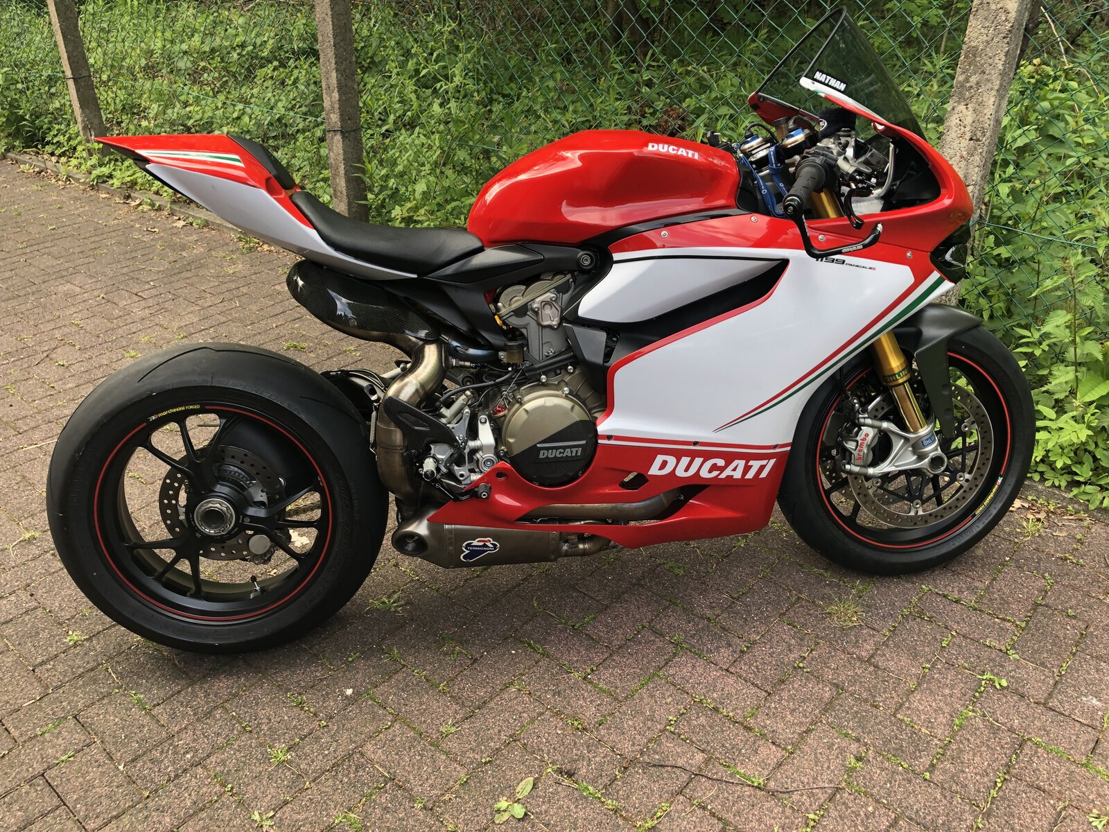

  3. So back together and ready for it’s first run out on Wednesday
    • Like Like x 10
  4. Well it looks the part, so far so good :)
    • Like Like x 14

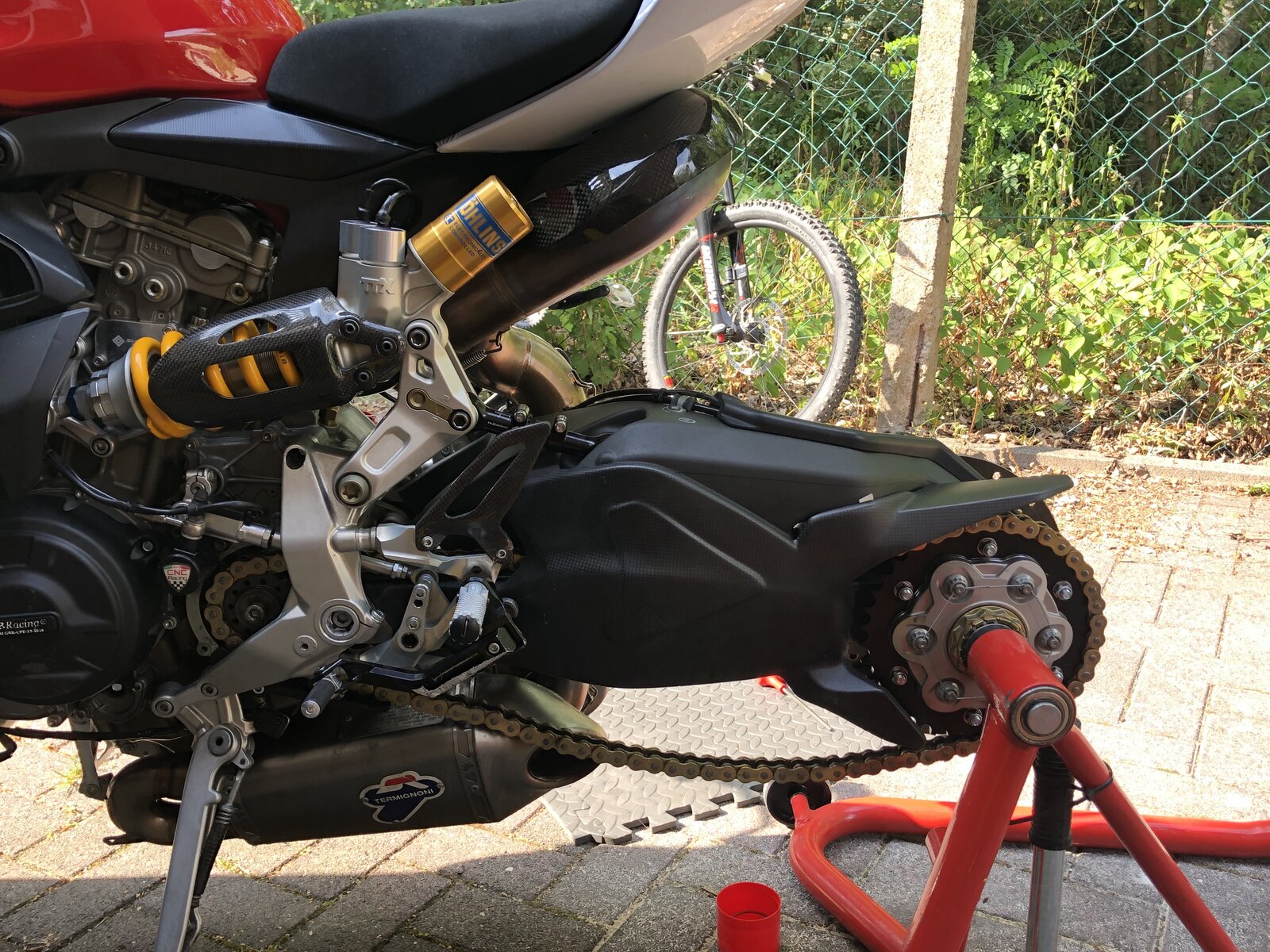

    with the bike back together I noticed a crack in the rear hub clamping area, so managed to get a second hand swingarm ( like new) from my dealer for small change and I did the 1199r adjustable pivot modification before refitting it.
    With the spark plugs changed for new and 9-J rated rather than 10-J the bike ran and started better immediately.

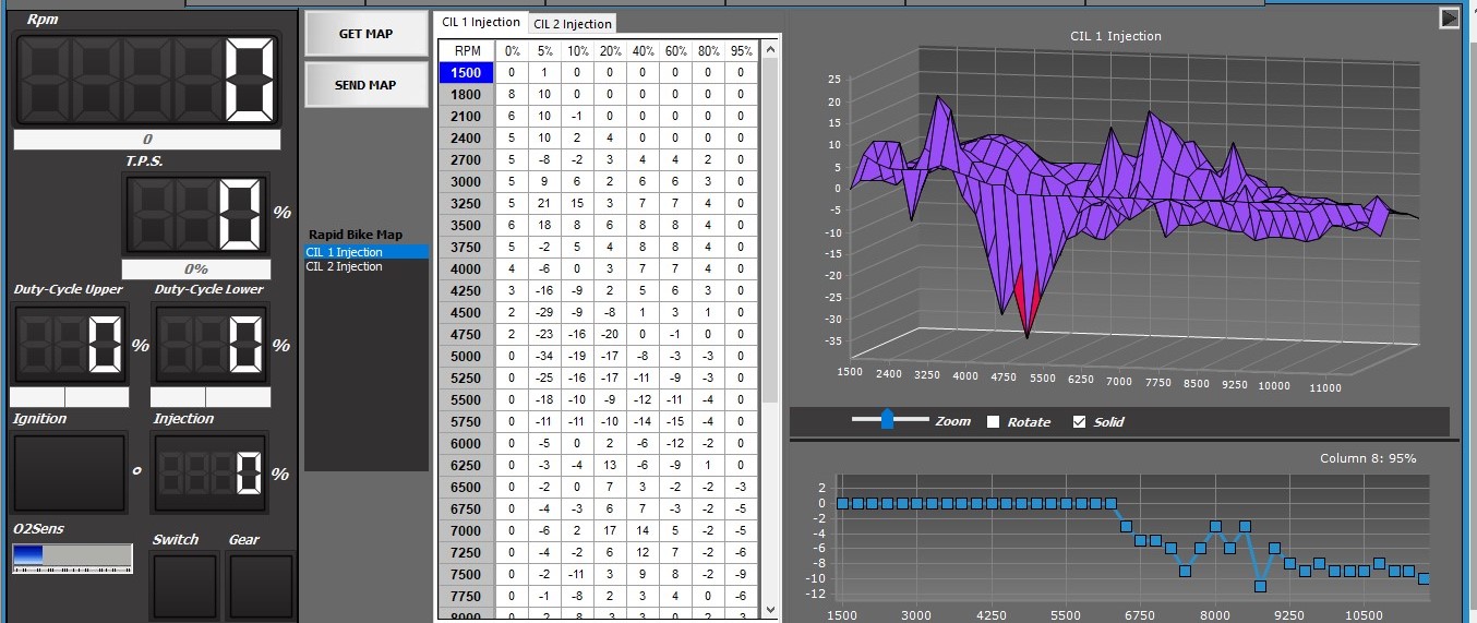

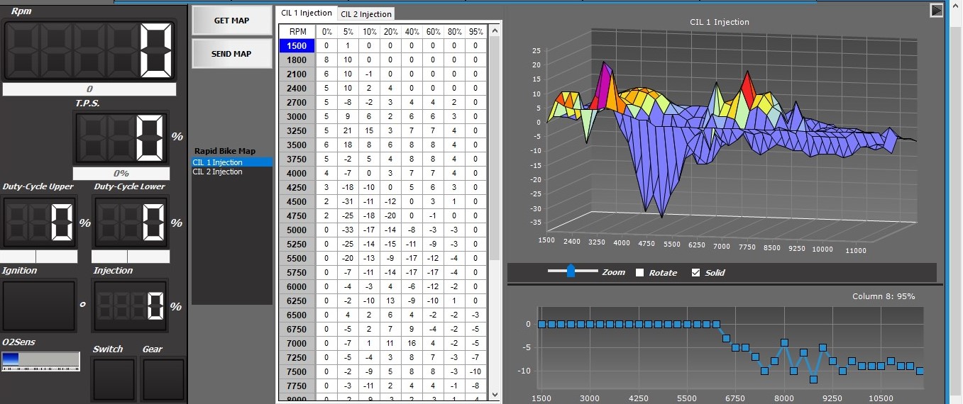

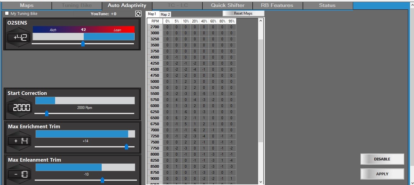

    What was good to see was the changes to the fuel mapping that the Rapid bike Evo was correcting on the auto Adaptive function,
    I have done a before and after screen shot and I can now see that the correction table values do change the master table, as I was under the impression that this would not be the case.
    Ill try and attach the pictures below.

    before changes
    Adaptive table
    Master table after corrections added

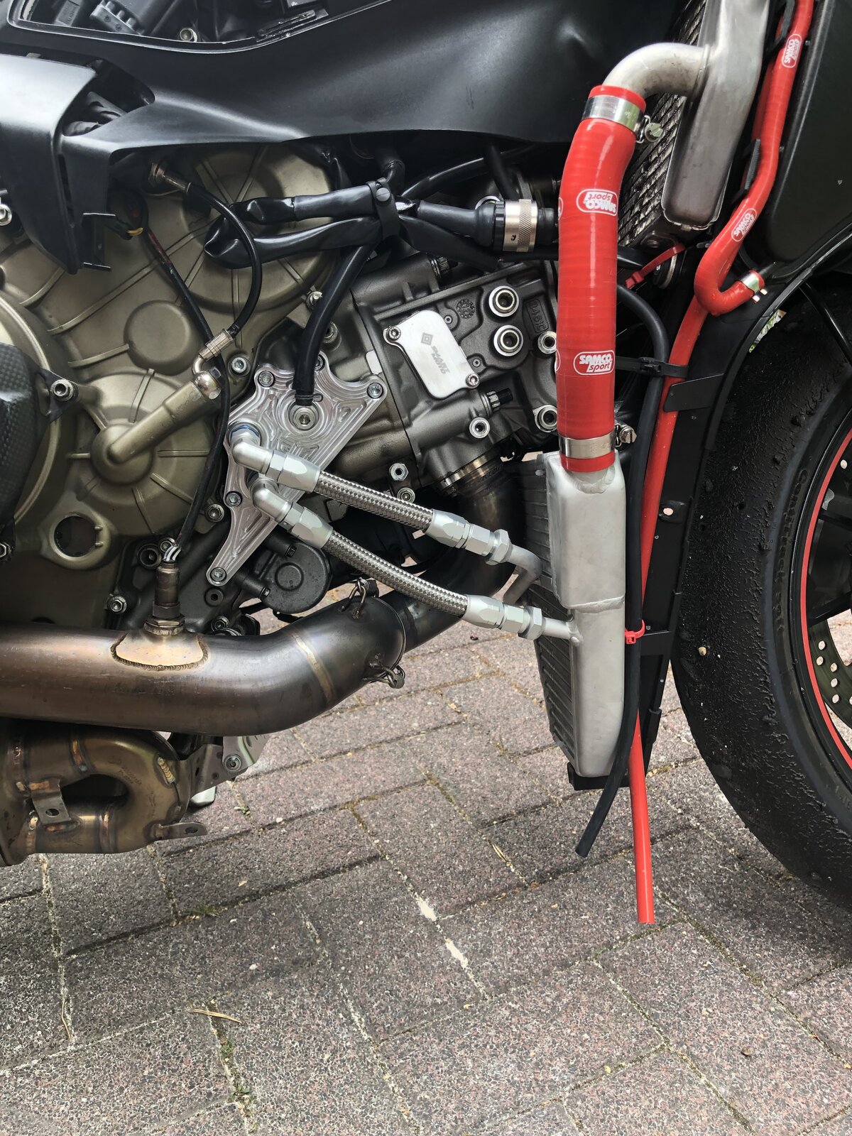

    big change will be a new oil/water lower radiator, from JM radiators so that will go on over the weekend.
  17. Last few bits for the summer
    JM radiator to try and lower the running temp from 100+
  18. So an update after 2 days in Zandvoort (NL) last week, most importantly i didn't get black flagged for Noise which was an issue with the 1299 and Akra system previously..
    the issues of overheating seem to have been addressed with the use of the JMR radiator package, and i was under 100C all the time and it was a very hot few days ( over 30c) so i am very happy with the upgrade to an external oil cooler.

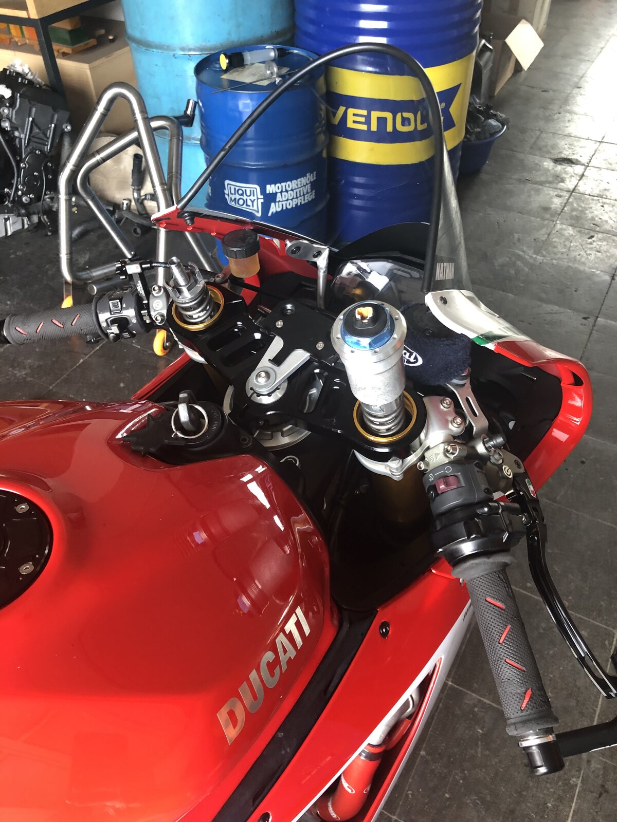

  19. So after having a look at the fork internals to check on spring rates..
    No oil in the forks..! Ffs the previous owner had renewed the fork seals but forgotten / didn’t bother to refill the fork oil.. so all is now good and I hope I have some damping on the front again :)
