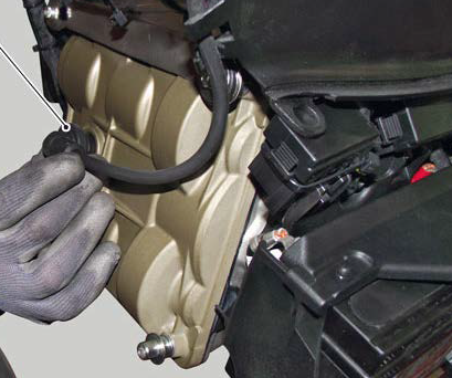

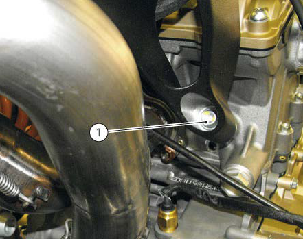

    Stock image from the workshop manual - I basically get a light sheen of oil down the right-hand side of the rear cylinder. It mostly gathers around the large bolt on the lower right corner and often reaches the sensor seen at the bottom centre of this stock image. I clean it off after every ride but surprisingly it even seems to gather oil when the bikes been stood for weeks?
    Front cylinder (stock image again)- Along the lower half of the cylinder head, right along the gasket line, I can see oil and dirt mix that has formed a line of muck from the lower left to lower right cylinder head bolts.

  5. sounds like the rockcover gaskets are leaking

  8. The golden covers are the rocker covers, with 5 bolts each to secure them. The Cylinder heads are sometime bigger than you think , and they are attached with Nuts, right at the bottom of the 'head' where it attatches to the Main Engine halves.
