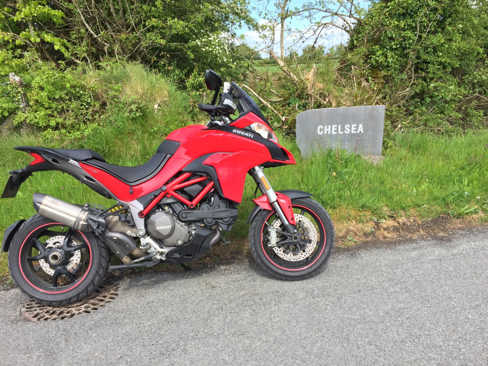

Akrapovic make a decat header pipe that can be bought separately. Details here. It comes with an adapter that stops the engine management light from coming on when the exhaust valve is disconnected. The silencer (I think this is the right one) that goes with it looks very nice to.
I like the akra, any idea what it costs? I contacted Austin Racing, they don't make anything and don't have capacity to make to order either.
That sounds about right, I think it's around £1800 for the header pipe and silencer. I think it looks nicer than the Termi but I must confess I opted for the Termi as I didn't want any warranty complications.
Arrow Decat pipe now on eBay as an individual item, separate without end can, but only listed for the 2016 1200 enduro. http://www.ebay.co.uk/itm/ARROW-MID...786936?hash=item2a8445b3b8:g:elkAAOSwq1JZNVA7 Anyone know if that will fit a 2015 dvt 1200? I've emailed the seller but waiting to hear back. It's half the price of tha akra decat
Yeah I agree, but just can't find any decat solutions for the dvt. The akra headers are probably better value as getting a bit more for your money, but that's nearly a grand!
I got this set up http://www.ebay.co.uk/itm/DUCATI-MU...485895&hash=item543ff114ba:g:~wwAAOSwImRYStx5 From these peeps http://moto.gb.com/ It was nowhere as near as the Italian mob. About 540ish I think. They can get you what you want, sound people.
I contacted the uk distributor for arrow, they advise that the link pipe I posted previously will fit a 2015 dvt and allow removal of the cat. Looks like I'll be saving some pennies!!
