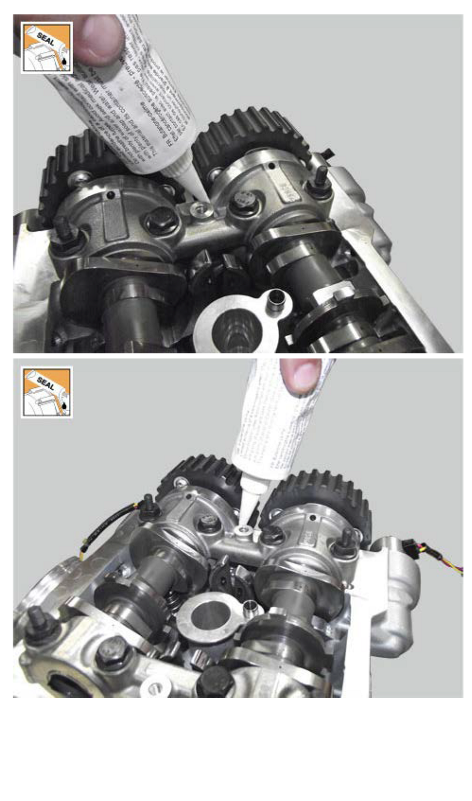

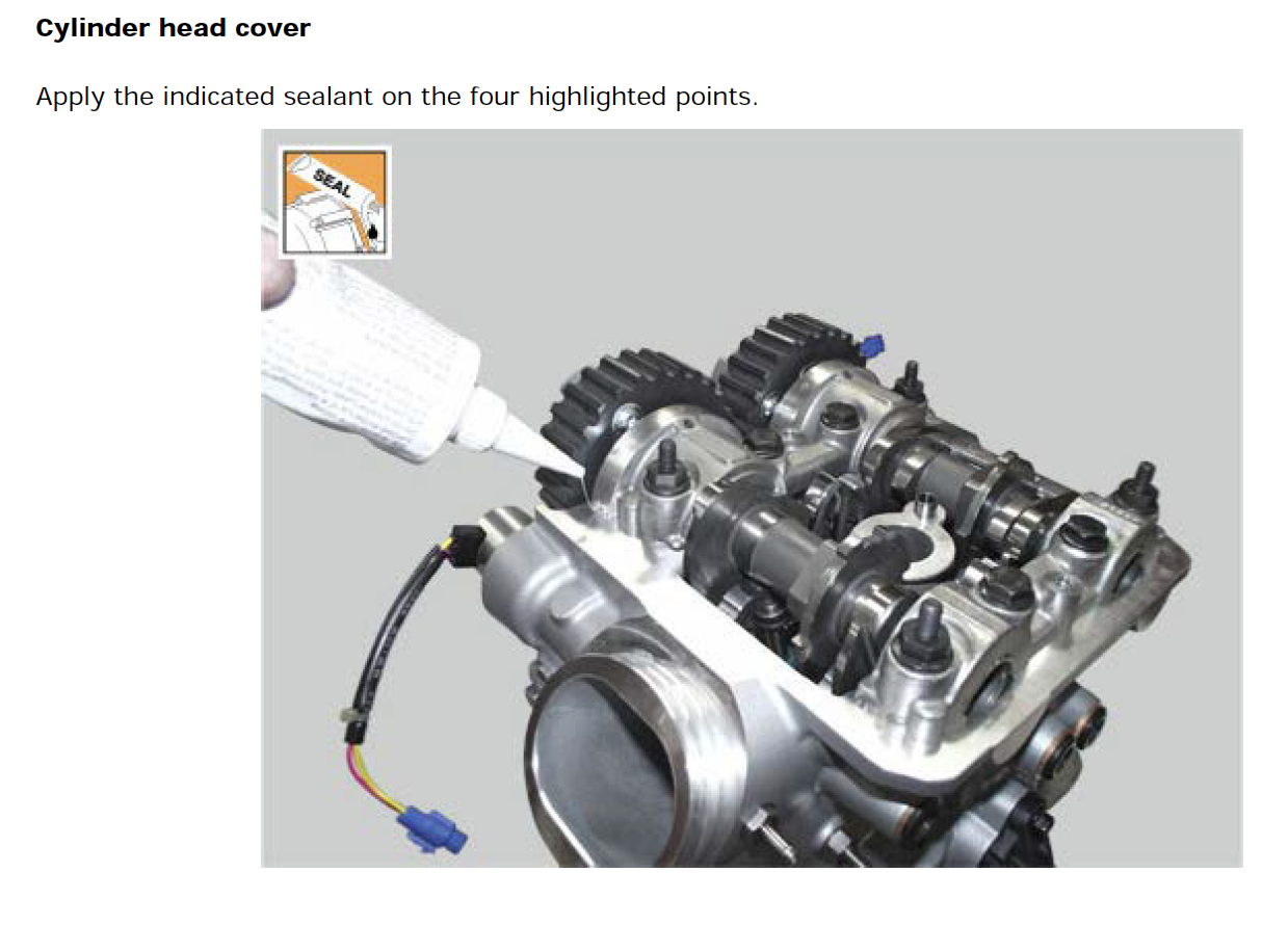

  6. There is a rubber gasket plus ThreeBond 1215 should be applied on the face between each lobe and at each corner at the lobe outers. Screenshot 2021-05-03 at 10.39.20.png Screenshot 2021-05-03 at 10.39.39.png

  7. Thanks for the reply’s, I’m going to be stripping the bike down this week to give it a thorough going over. I have ordered the sealant. If I need the gaskets then I’ll order some after I have got them off.

  9. Sorry, my mistake. It should be TB1215. I have edited the post to reflect this.
  10. luckily that’s what I ordered! thanks again

    the cover gasket I have now reused for the third time and is tight together with the 4 spots three Bond
