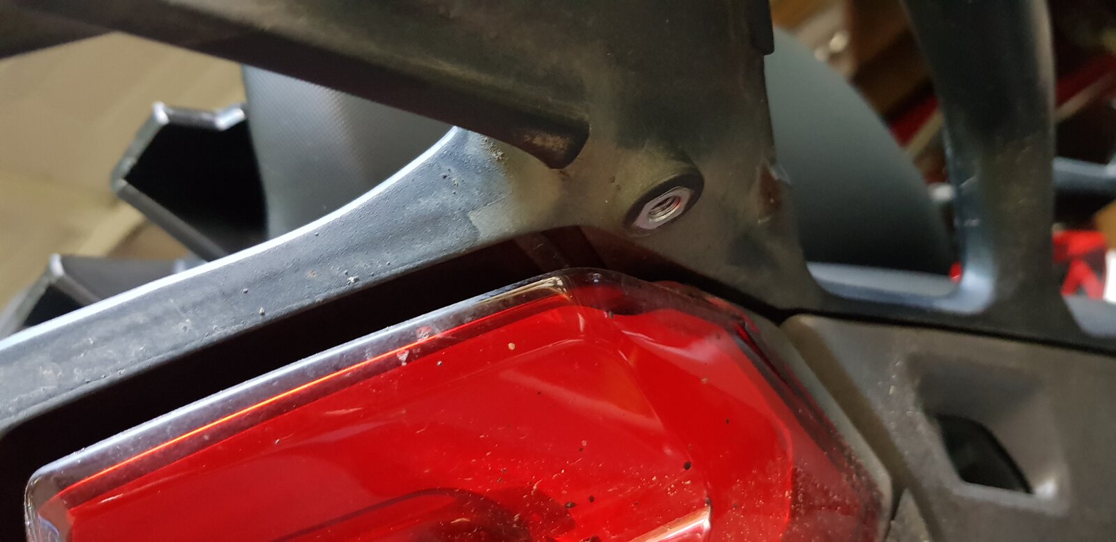

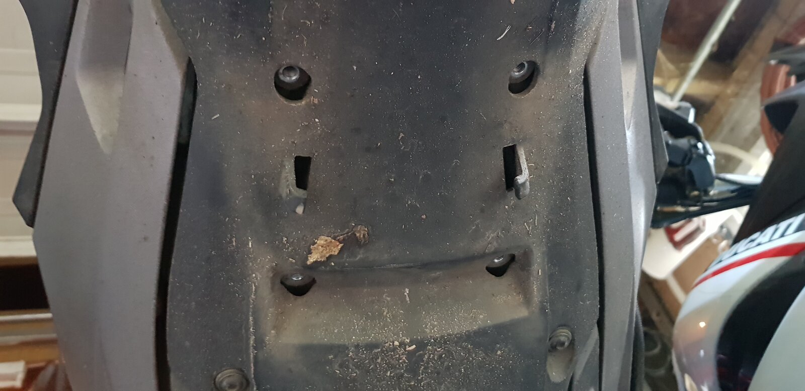

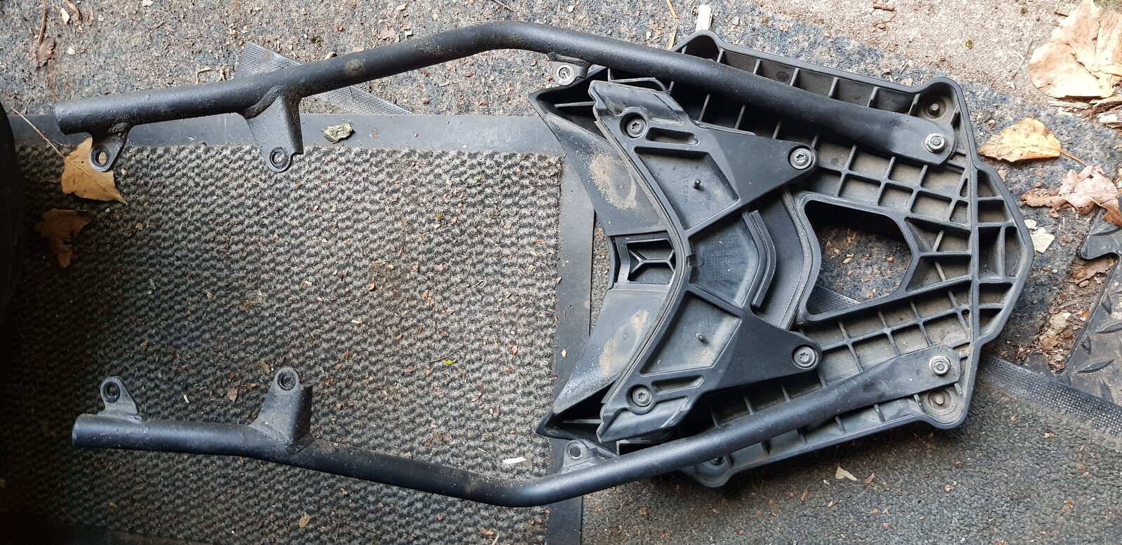

  5. It is already removed, but here are some pictures of where it bolts to.
    Hope that helps.
  6. Hi John
    That looks like a givi style case fitting, I have the touratech one, has a different fitting at the plate, but you have confirmed that the fittings under the rear of the bike are the same as the dvt...many thanks
  7. Hi John,
    Just an update got it all fitted today with a bit of scratching and swearing, thanks for the photos they made a difference and it was obvious once I got the first arm in place.....now all I need box :p
