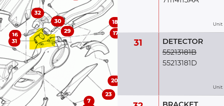

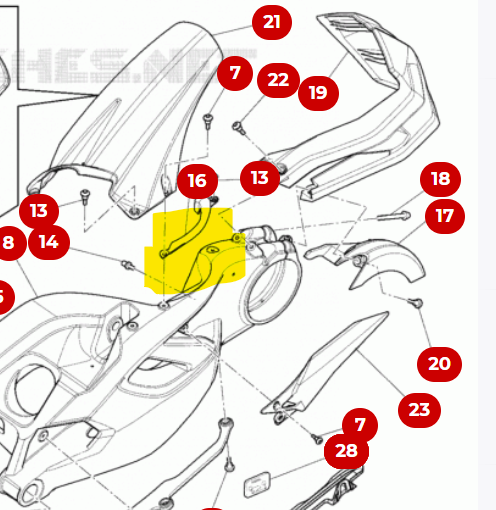

  1. Dont think so... according to parts catalogue, "independent" speed sensor only shows up models from 2013 up...
    this is the diagram for 2010-2012 model , there is no speed sensor/detector
    And this is the 2013-2014 model diagram, where there is a speed detector
  2. 2010-2012 first generation Multistrada 1200 only had 2 sensors to operate the ABS, Traction control and speed. If I remember correctly, speed is taken from the rear sensor. Andy
