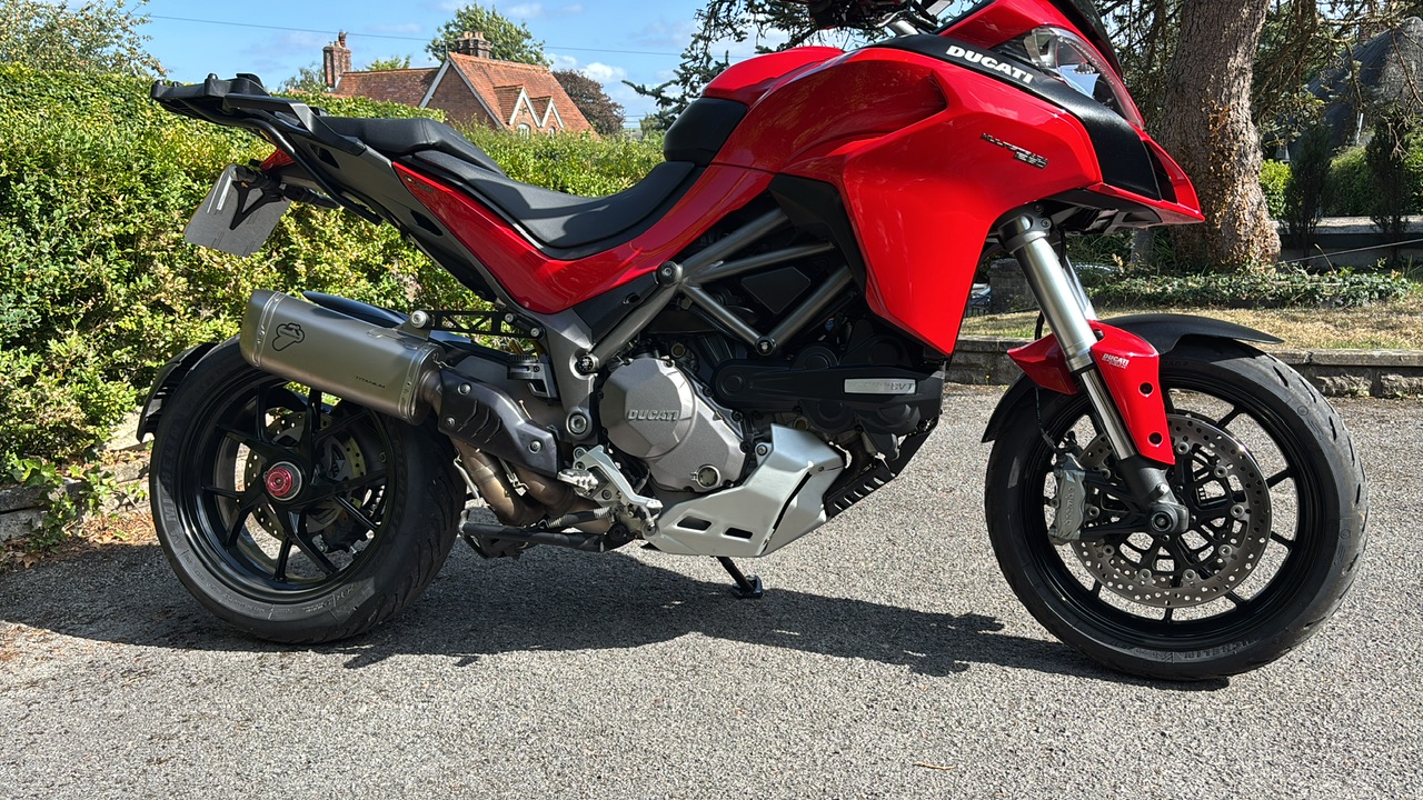

    the clutch on my recently purchased 2019 1260 is a bit grabby when I’ve not used it for a few days when first pulling away, after that it’s fine. Bike has done just under 12k miles, full Ducati service history and clearly very well maintained, it’s mint.
    any thoughts on cause?
    Ta!
    pic for the sake of it!
