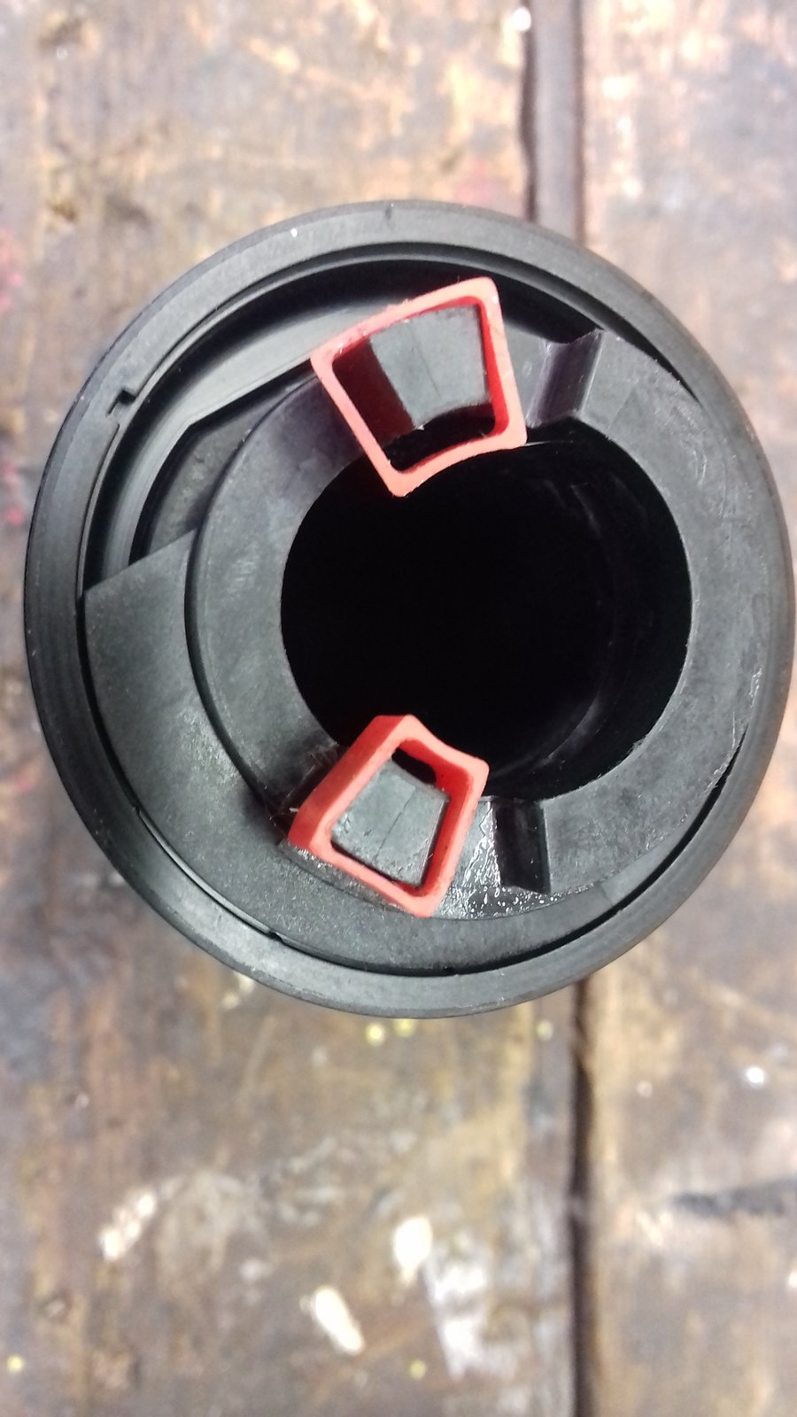

  6. I emailed the guy on your link recently and got the same answer that he was sorting out spacers to fit the 1260. Following that I found them on ebay, listed as compatible with the 1260. I had doubts though I thought it may be the same source. I thought I would take a chance considering the low cost. It turns out the smaller of the spacers fits one lug of the 1260, but the other is too large. As far as I can see two of the small spacers will do the job as the lugs are the same size. So I'm going to ask them to send me a second small spacer. Incidentally one spacer only fitted eliminates the majority of the free play on it's own.

  7. Do these fit the 1200DVT?
  8. As far as I can tell what I said above applies to the 1200 and 1260.
  9. I message him yesterday and he said that they were currently making the tooling for the 1260 spacers and would be available in approx 3 weeks.
  10. This is what I bought on ebay as advertised for the 1260. As you can see they don't fit. I was going to ask them to send me a second small spacer as you could get away with two of them....sort of! But having looked at them again, and bearing in mind it's the throttle we are talking about, I have decided I will wait for the new correct one's due in three weeks. Incidentally it seems the ebay seller gets them from the bloke on Espen's link and seems genuinely unaware they didn't fit the 1260.
  11. That looks like something that could easily be knocked up with a plastic printer.
  12. I imagine so. If anyone has a 3D printer and wants to make some and needs a throttle to get the dimensions, the one in my picture is a spare as I have now got heated grips, so I'm happy to lend it.
  13. I could do this, it looks super easy. I'm just not sure how they're supposed to improve things on a throttle-by-wire bike, but I'm probably missing something?
    PM me to discuss, although the heat in my workshop at the moment is making accurate 3D printing a bit tricky at the moment. I've got a couple of projects on hold until things cool down a bit. I've got nothing so urgent that I need to install AC in my workshop so if you're not in any hurry I'd take a look on behalf of the community.
  14. Rainman I'm not sure how to PM you? To answer your question - the spacers are designed to take up the free play in the throttle housing, purely the forward/back free play as you apply and back off the throttle. So it's nothing to do with the ride by wire as such. From reviews I have seen it seems to help quite a bit with applying a smoother throttle transition on and off, which I think should make the bike smoother to ride. I always find on the Multi that due to the free play there is always a slight delay from twisting the throttle to the bike responding, making it a bit snatchy. It may not be for everyone, some people like some free play, personally I don't. Thanks for your offer to have a look at doing it. If you want my spare throttle to work from let me know. I'm presuming you know how to PM me :grinning:
