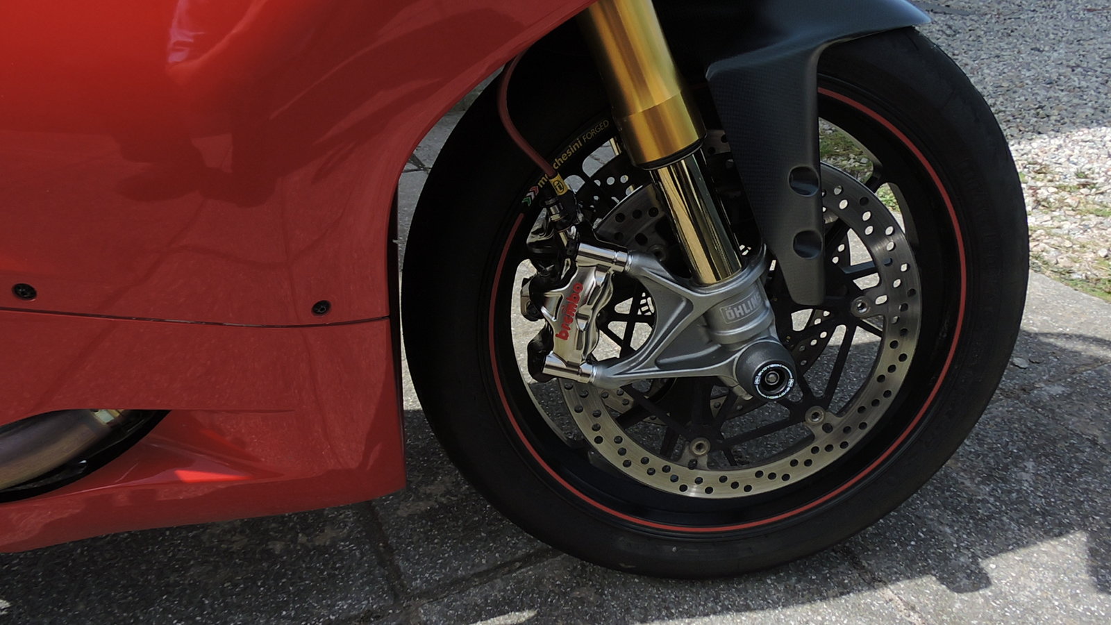

  2. Are you running your abs with them?
    If so how did you order the brake lines as i'm having a problem with fitting them GP4RXs to my 1299s as oem banjos just don't work.
  3. Can I buy you standard slave cylinder?
  4. Hi Addiction, Yes still running the ABS. I decided to lose the over the fender set up of the OEM lines and the top guys at HEL performance made me a custom
  5. Hi Addiction
    Yes still running the ABS. I had a custom line made at HEL performance from the ABS pump that has a tee as it pops through the fairing above the front wheel. I live in Devon so I mocked the line up and went up for them to make it.
