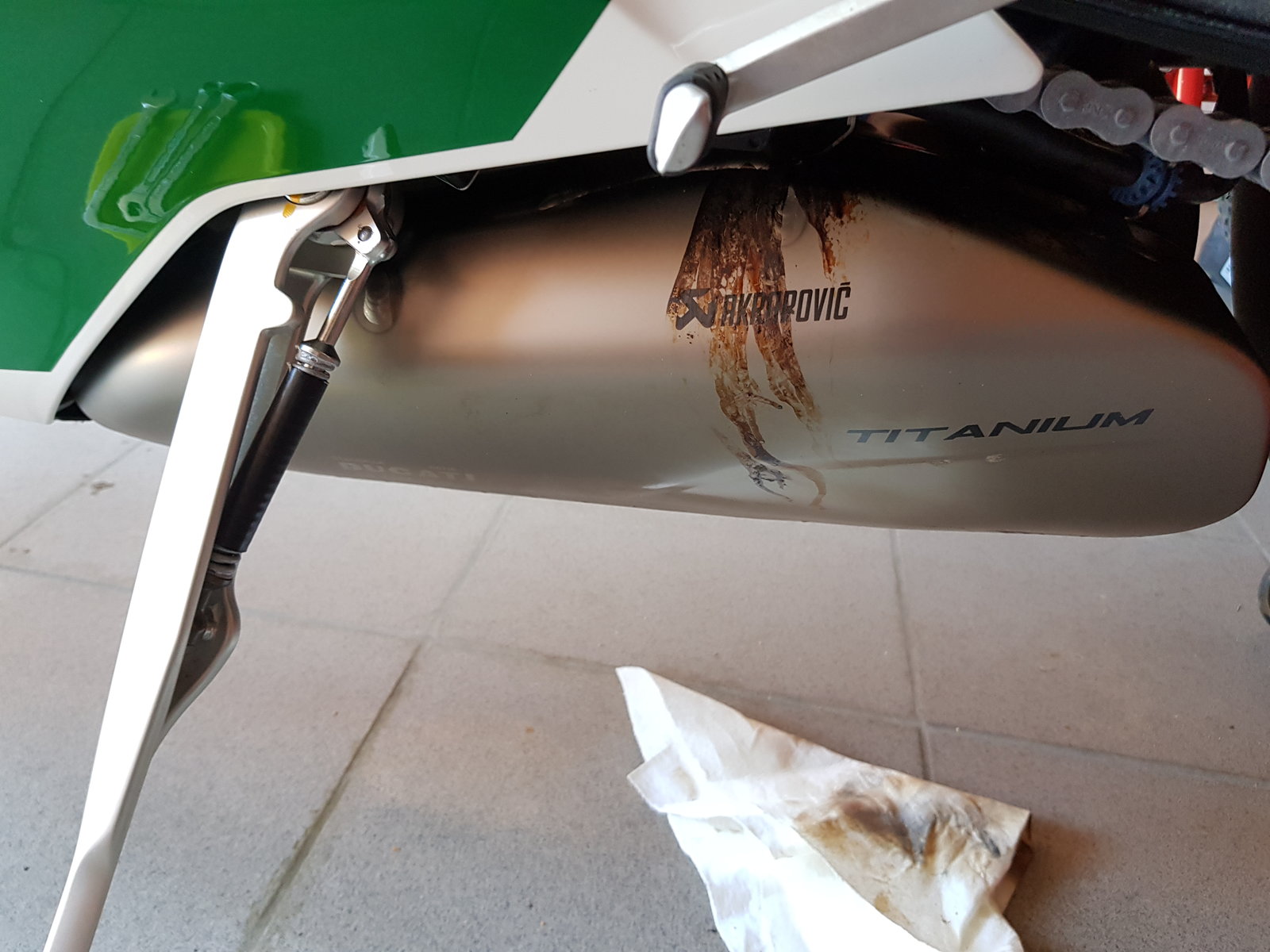

    Then there is the chain grease on the exhaust. Is that normal?

  9. No, the grease isn't normal. :(

  10. Stock chain is pants so I’ve changed to Wurth dry lube. Not found the need for throttle spacers as the play doesn’t bother me and is engineered into the action so if that’s the way Duc intended I’ll leave it be.
  11. Never mind the grease, look at the state of that chain!!

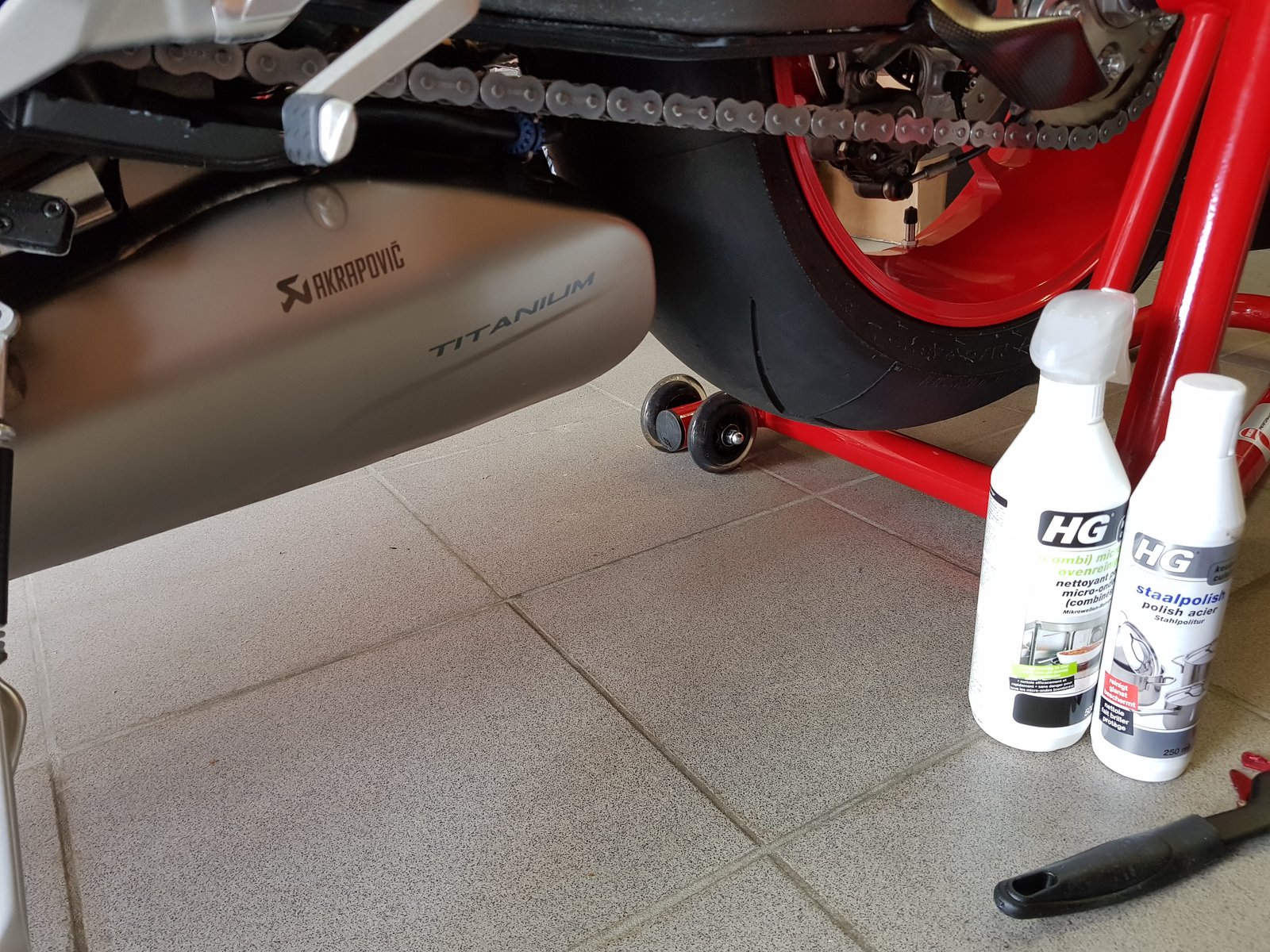

  15. 20180717_165909.jpg Managed to clean in it of.
    Under the chain near the engine there is a cup to catch the grease. Becouse excessive grease it filled up... so this has to be cleaned regularly.

  18. I would complety clean the chain of the original chain wax as is can permanently discolour the stock Ti exhaust box.
  19. I fitted the throttle spacer , found it much better
  20. too much oil running down where your picture is, was a indication that my 1199 inner clutch rod seal was damaged.
    worth keeping an eye on
