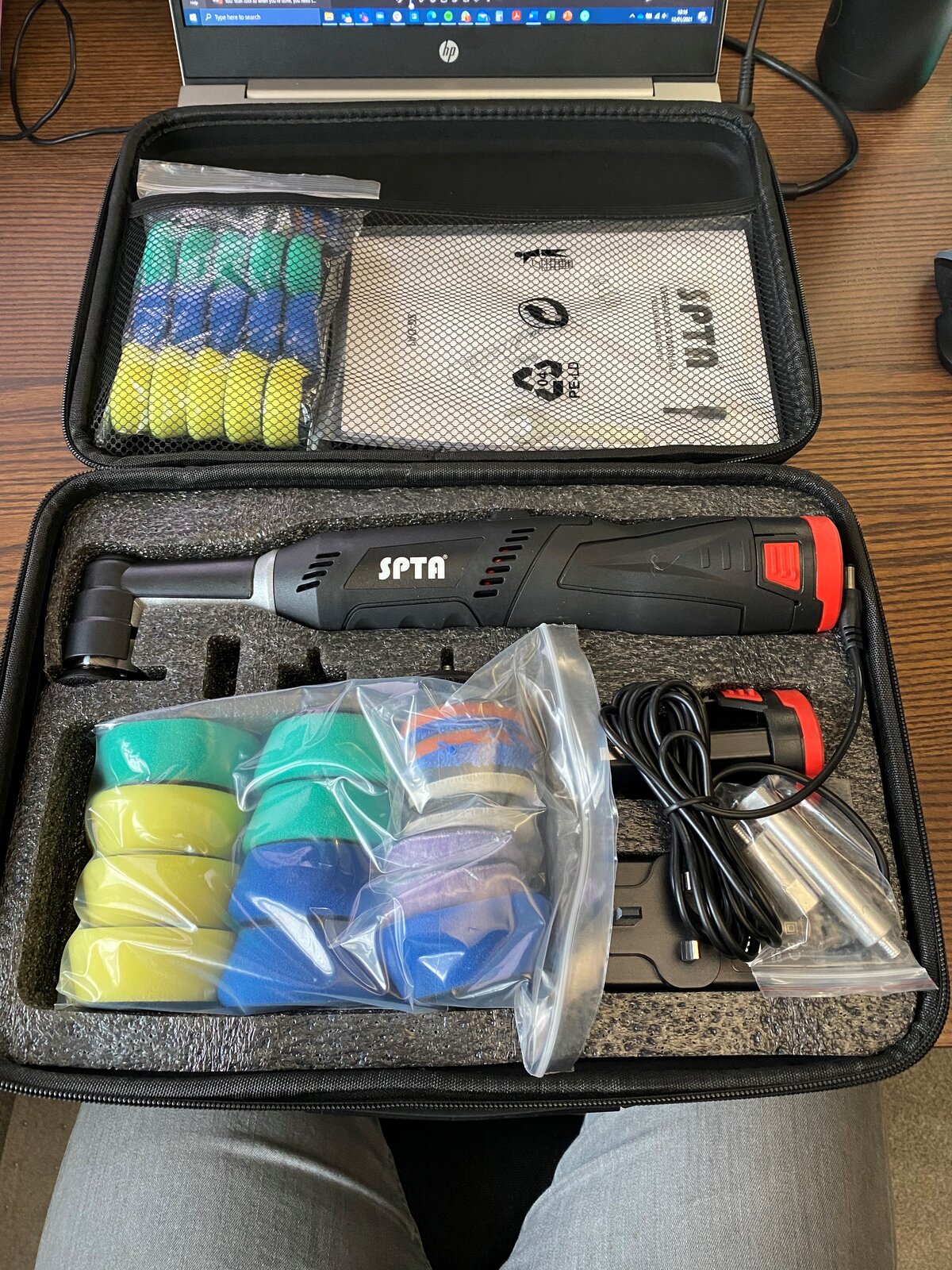

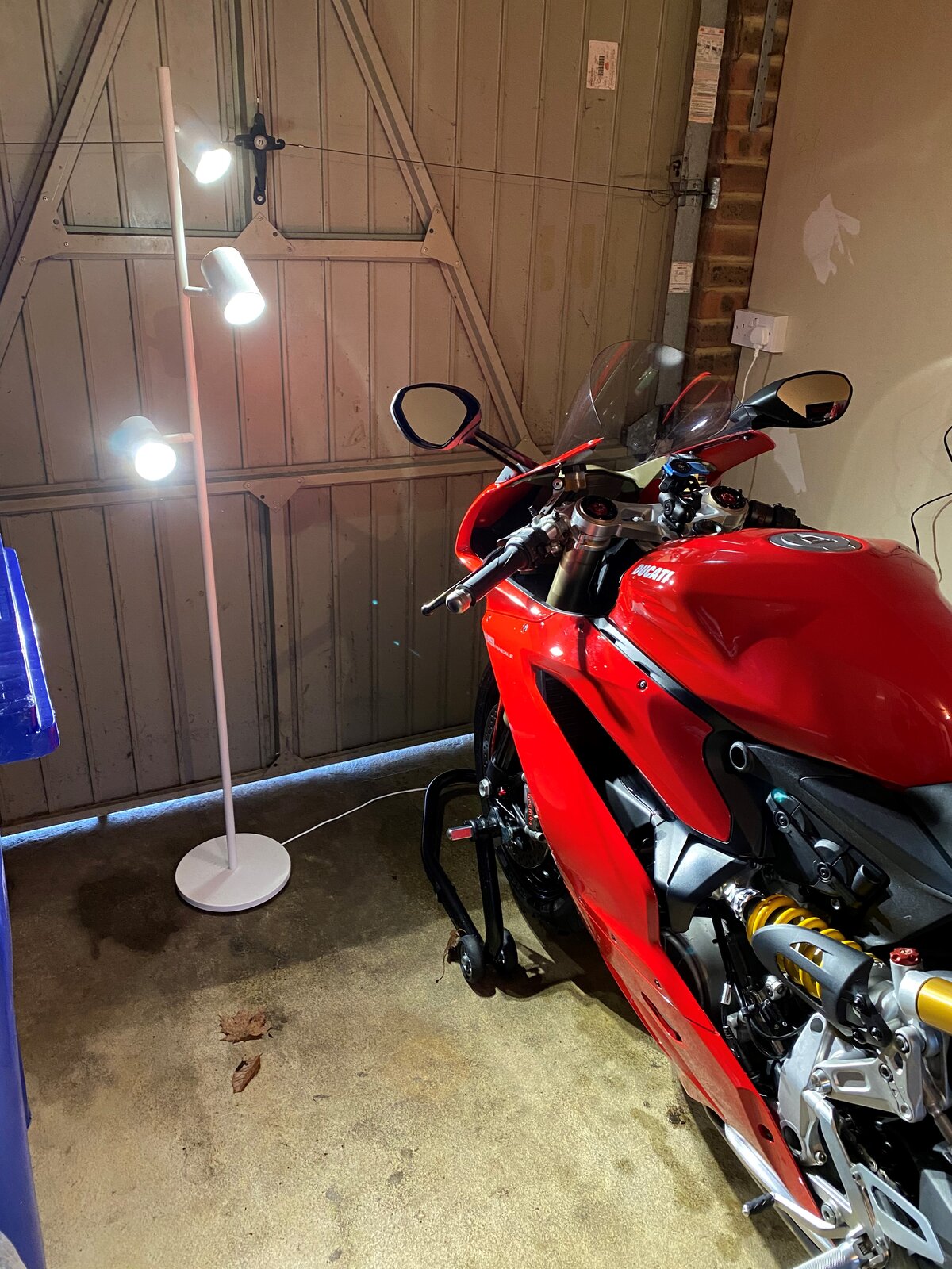

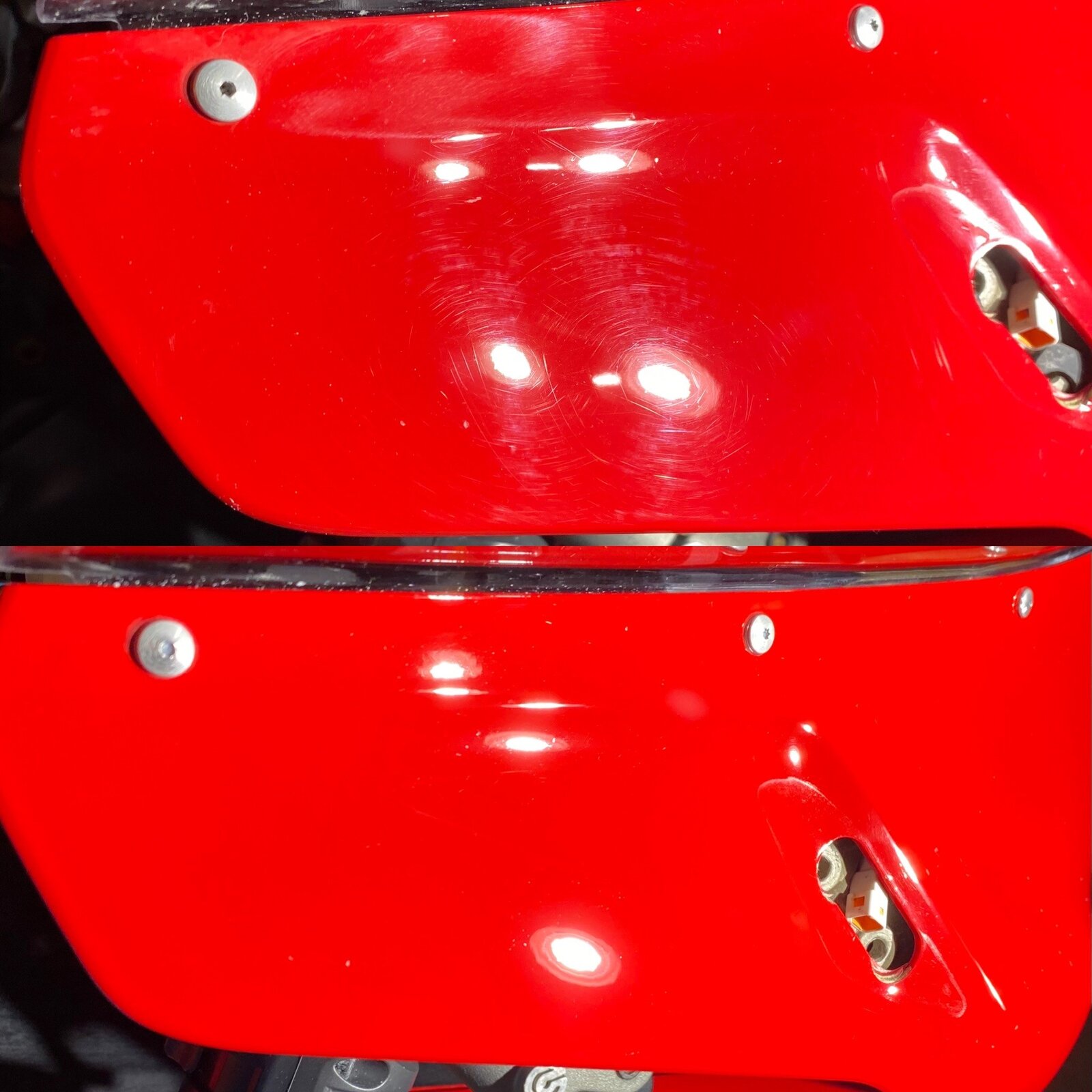

    After a deep clean and decontamination, I set the bike up in the garage, stealing my office lighting to highlight the defects and removed seat, mirrors and a couple of sections of trim to allow the best access that I could get to the tank etc. I also removed the disgusting tank pad that was on and removed the tank grips to fit a new set after correcting the tank. I knew that my usual 5" and 3" DA's just wouldn't get to where I needed to so had my eye on a few nano DA machines. As I was about to buy this HEX Nano Machine Polisher - Dual Action Battery Polisher Kit | Carbon Collective | Ceramic Coatings & Detailing Products I found the same non branded machine on Amazon for considerably less SPTA Cordless Mini Car Polisher, 12V Micro Cordless Scratches Killer Car Polisher RO/DA Mini Car Polisher for polishing, Sanding and Cleaning: Amazon.co.uk: Car & Motorbike. With a 1" and 2" backing plates and a selection of pads, I knew it would give me everything needed to correct and refine every section of the bike.

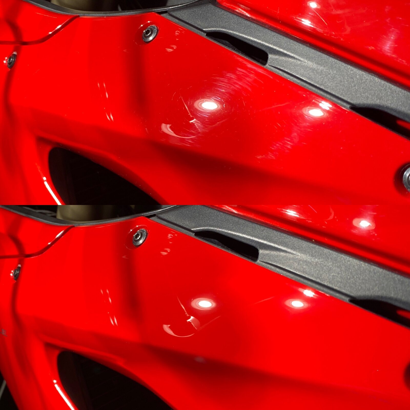

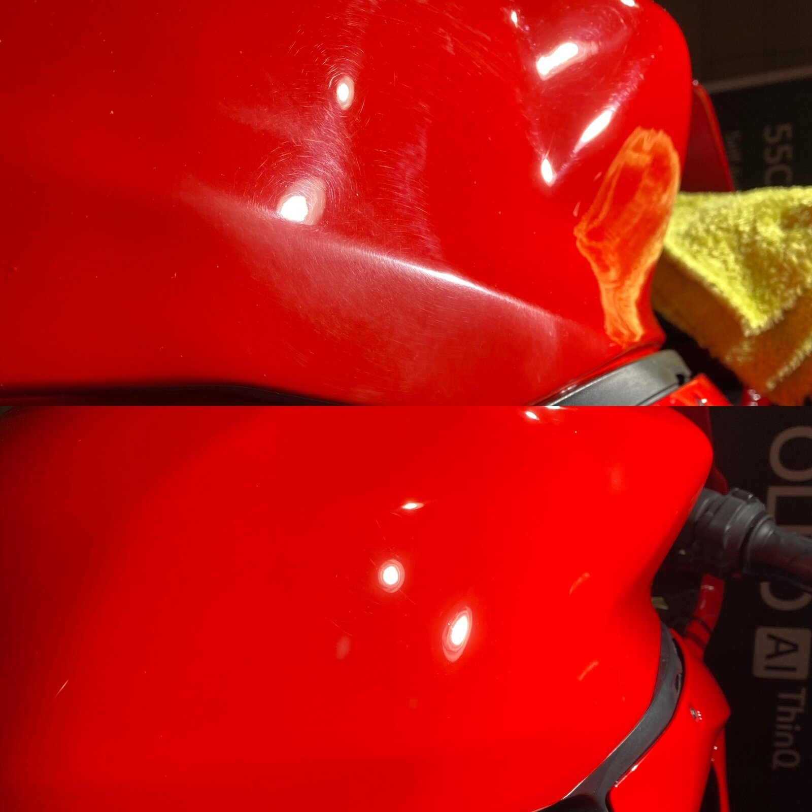

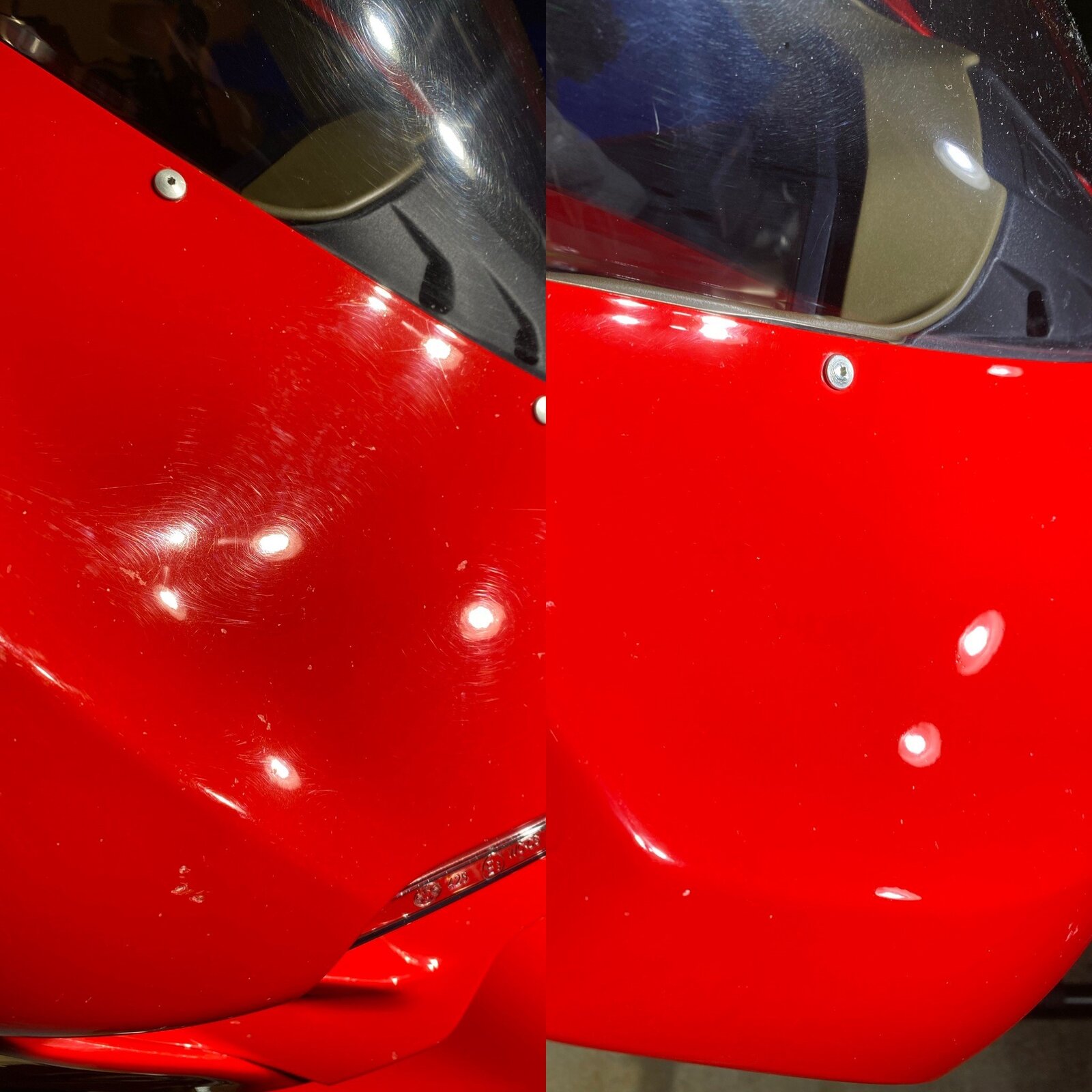

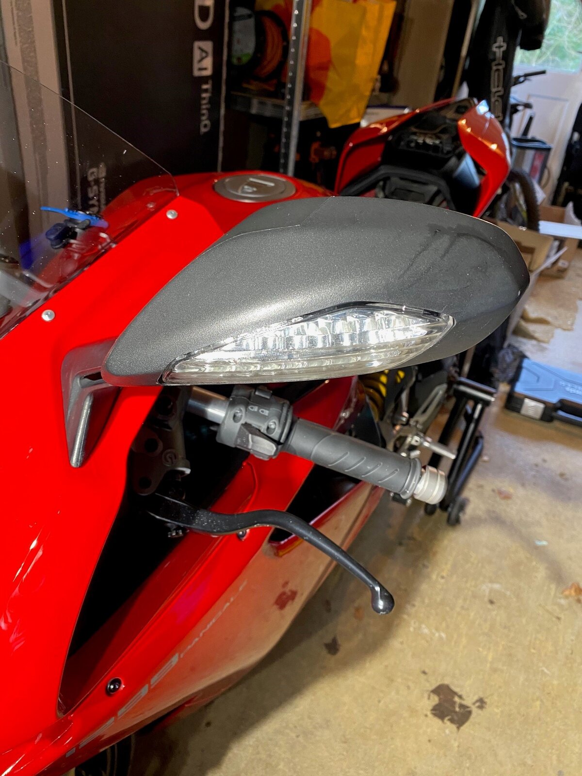

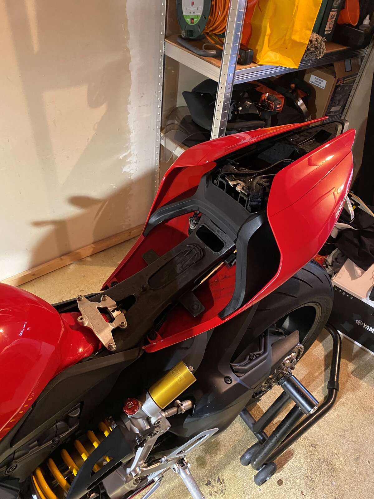

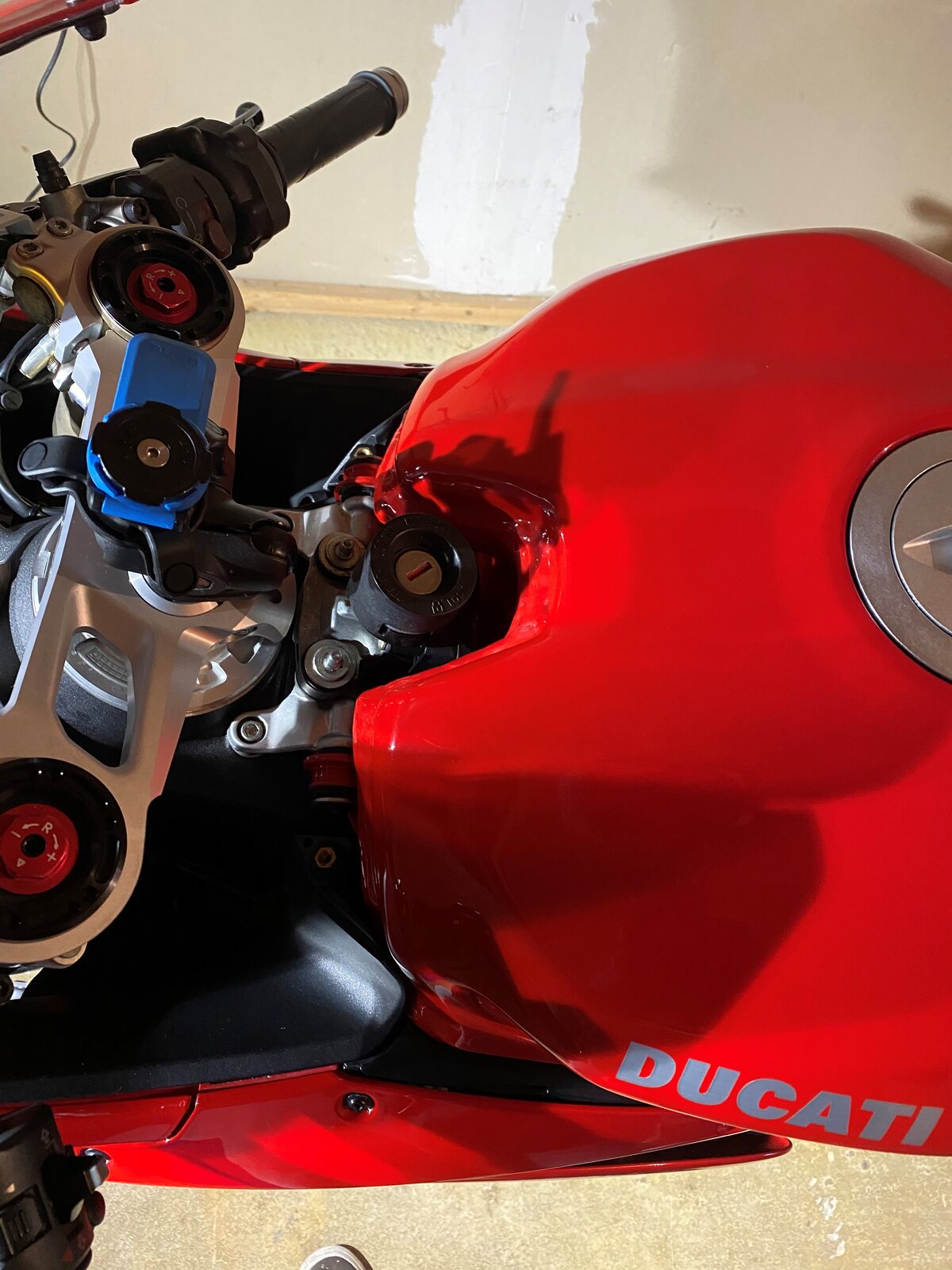

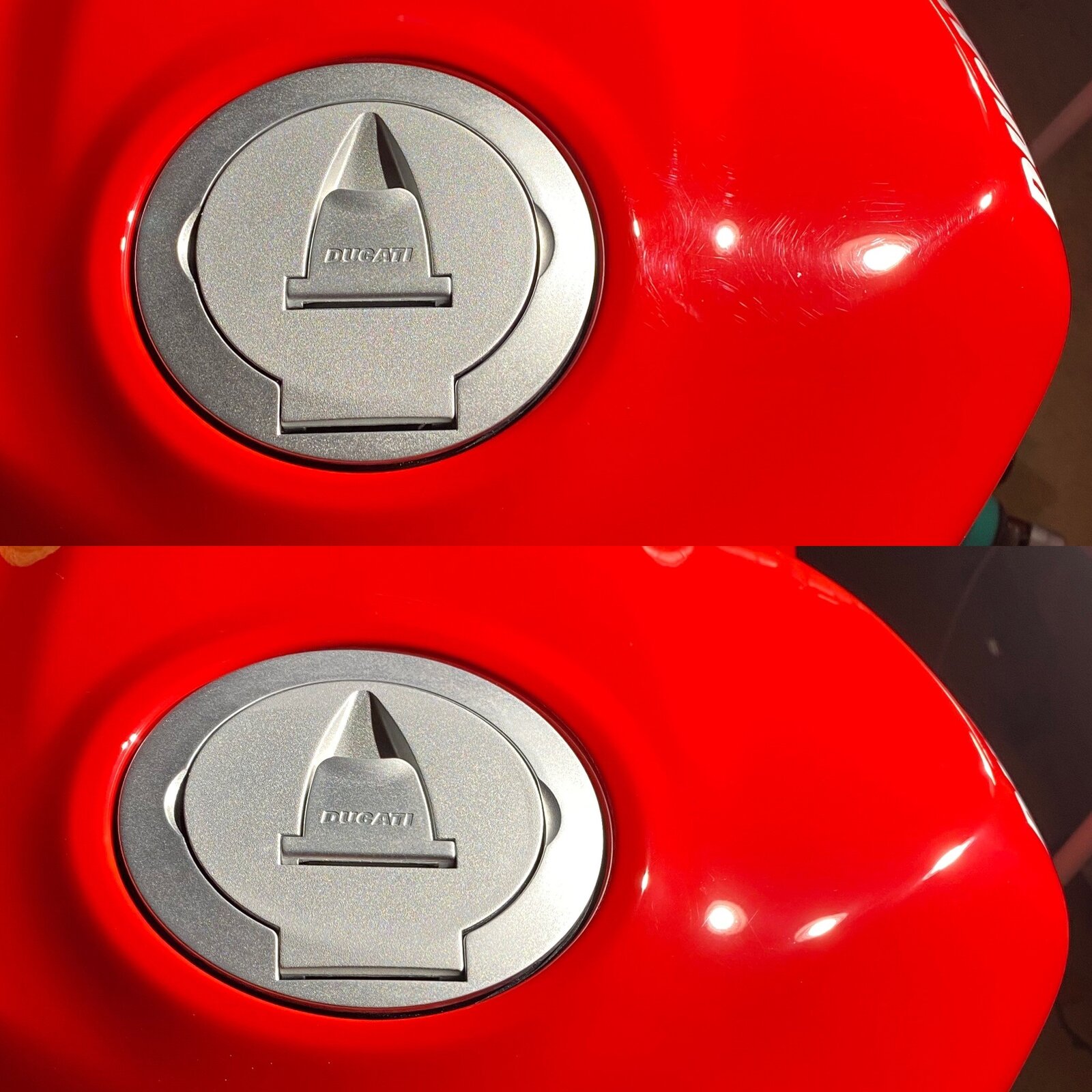

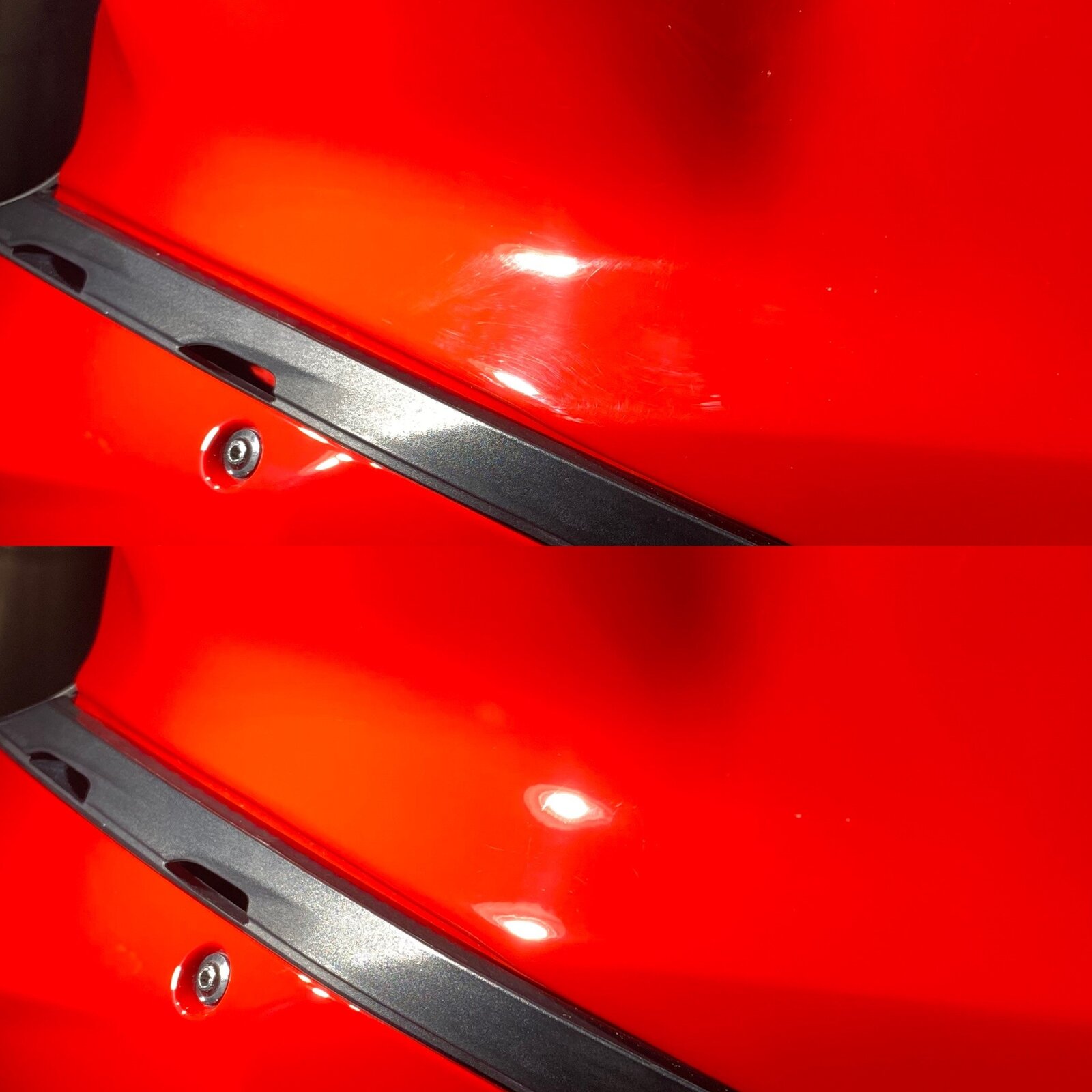

    Being mindful of the soft clear coat, I ran a couple of test passes with the softest pads and Scholl S20 Black to see what defects could be removed. Whilst S20 Black can be used as a single-stage polish, I wanted to remove as many defects as I could so after testing with the microfibre pad, decided to complete a two stage correction sticking with S20 and MF for the cut and the refine with S20 and softest foam pad. It took time to get used to the machine and also working on such small sections but the results were great.

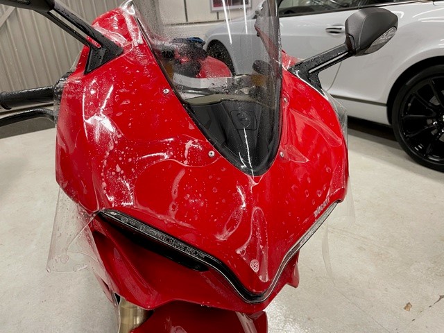

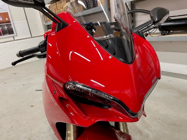

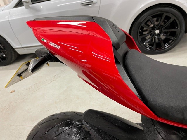

    I wanted to have the bike protected as best as I could so knew I wanted to have PPF applied to the bike. After a recommendation on here a while back, I reach out to Auto Curators - Professional Vehicle Detailing & Paint Protection Services as they have experience with bikes, a V4 Speciale (owner on here) in their portfolio and are close to me in Hook. Paul recommended a full bike PPF but after discussion, we decided to leave the tank be as it would be such a small section of PPF after the pad and grips were back on, and I have the DP screen which at the point it's in now wasn't worth the PPF, I'll likely replace at some point. So apart from those two sections the entire bike was fitted with Xpel Ultimate Plus PPF which is a self healing PPF. Really great service and job from Paul, would highly recommend.
    The strange thing is that as Paul explained to me, the vehicle never looks its best once the PPF has just been fitted as it needs time to settle and any remaining lubricant to evaporate. So after leaving it for a week, I washed the bike and then moved on to protection.

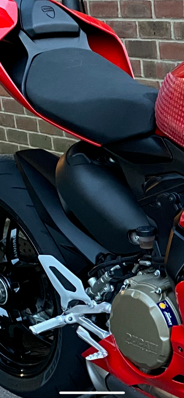

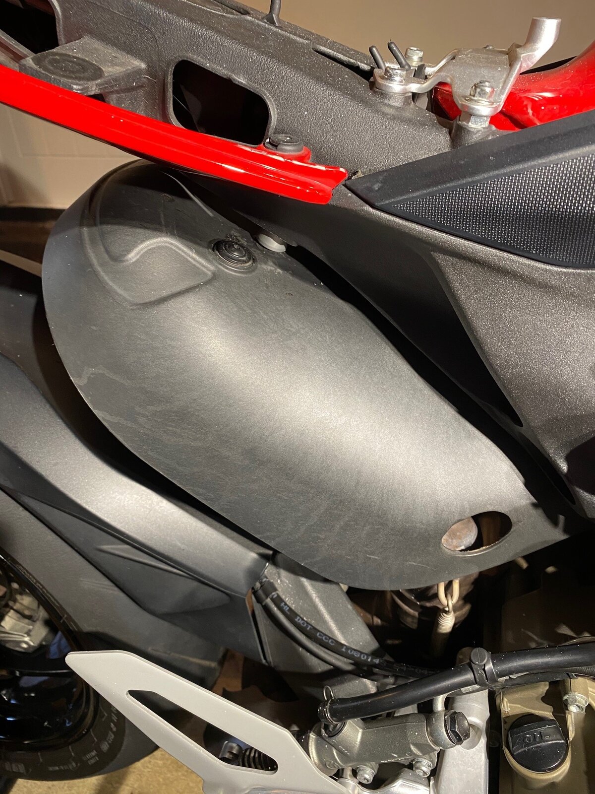

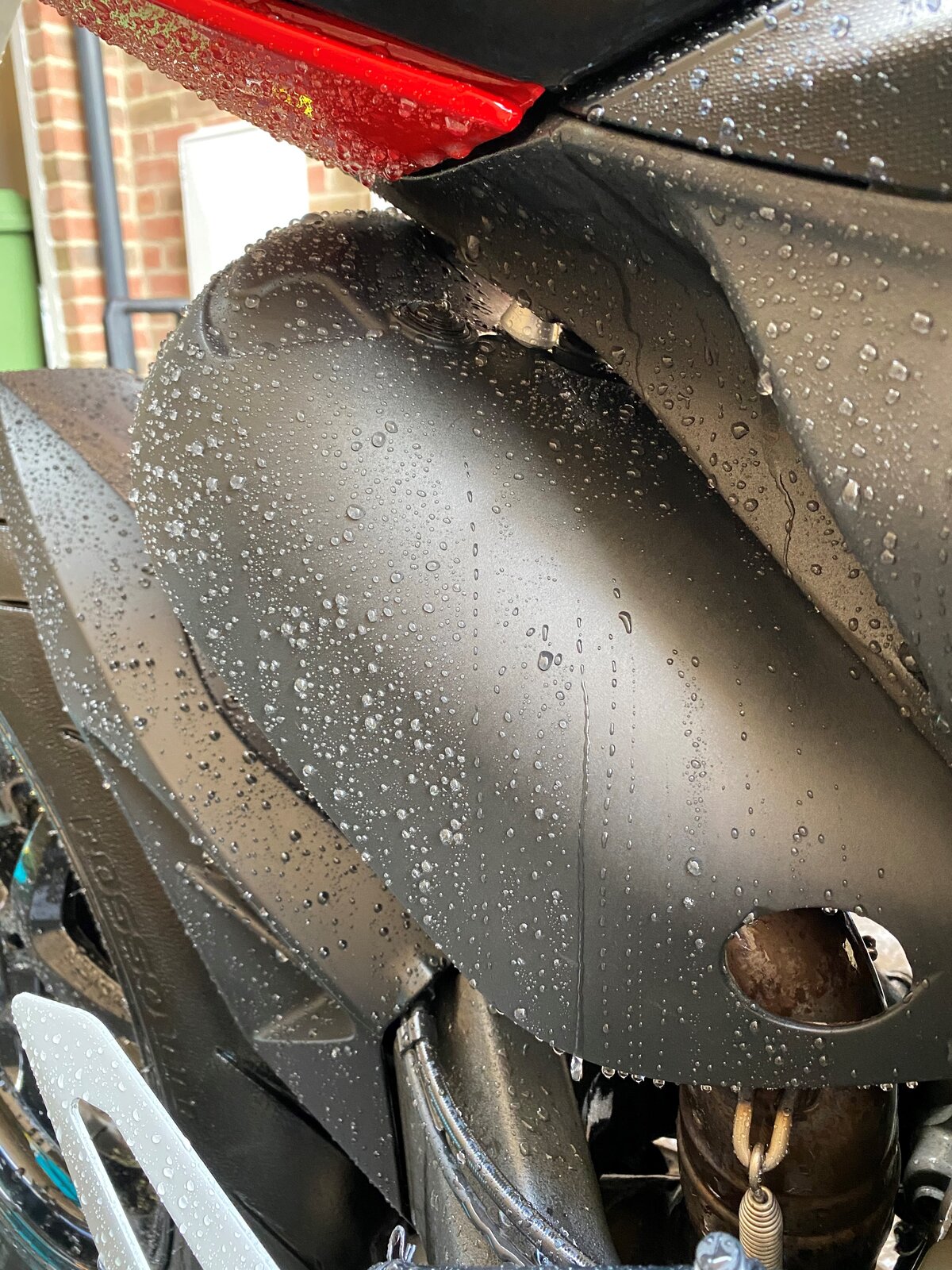

    The black plastics were fairly faded and the heat shield was in a pretty bad state after the rear brake fluid reservoir leaking on track last year causing some staining. I used Carbon Collective | Platinum Trim Ceramic Coating to restore the trim to a factory finish and protect for two years. It's a ceramic coating with 3H hardness and two year protection after two applications and the effect was incredible and so easy to use. Not the best before and afters:

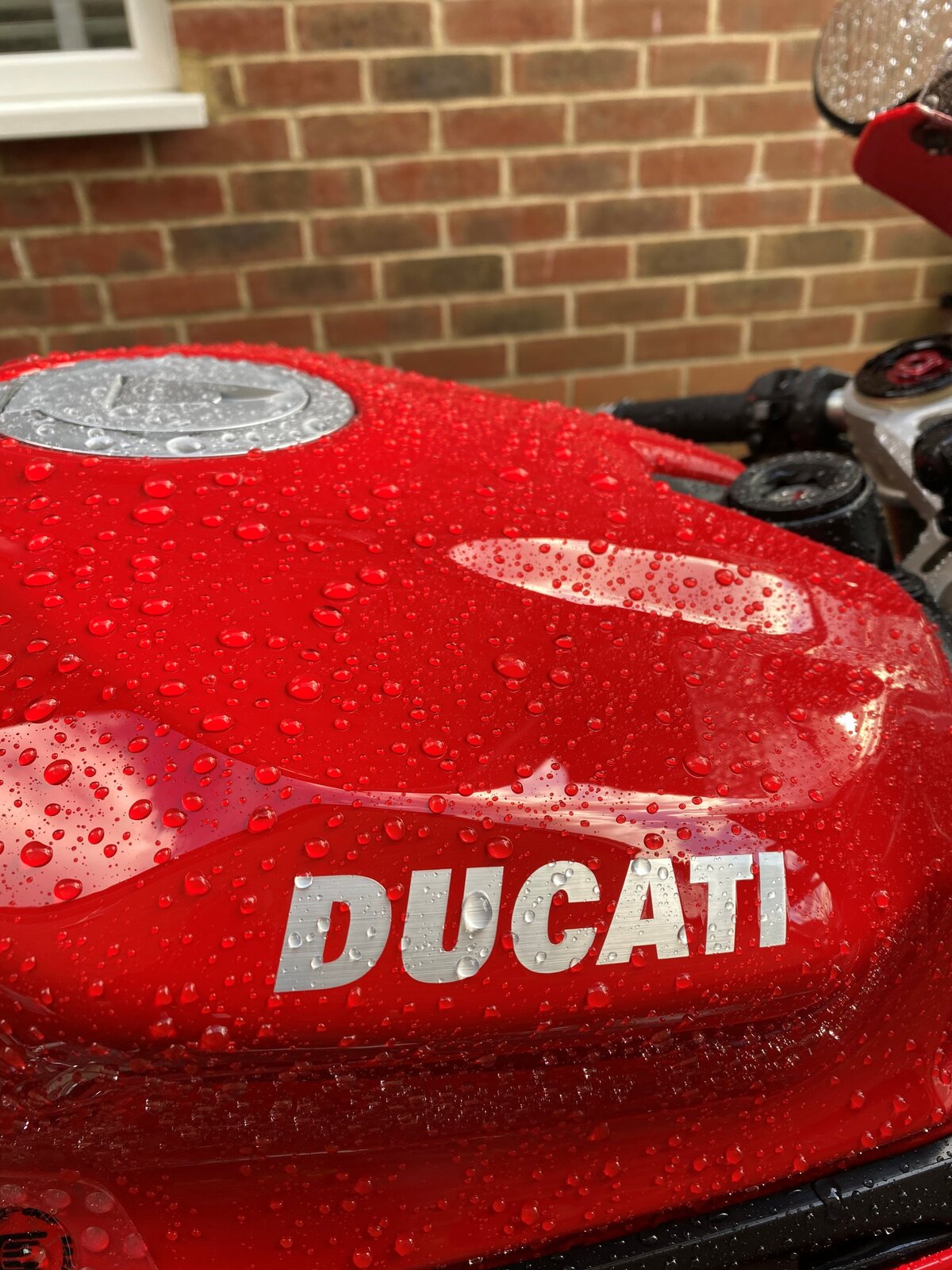

    I'm still looking into what long term ceramic I want to go for to apply over the PPF so for now protected the entire bike with my usual Hybrid Coating 2.0 | Carbon Collective | Ceramic Coatings & Detailing Products which is a 3 month liquid ceramic protection that is incredibly hydrophobic, makes cleaning much easier and will offer some additional protection on top of the PPF. The water beading and behaviour is great.

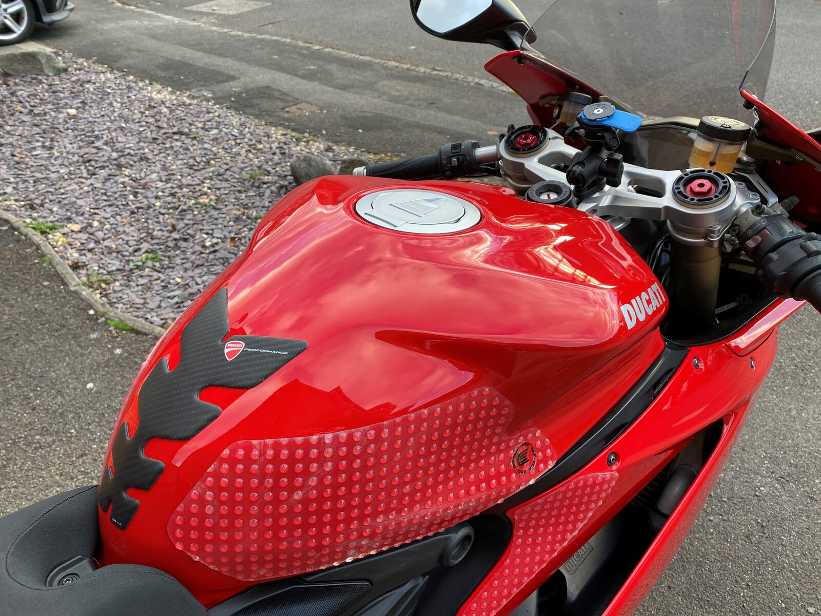

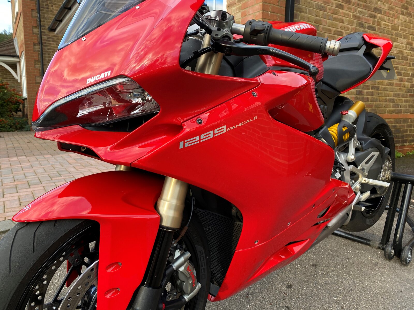

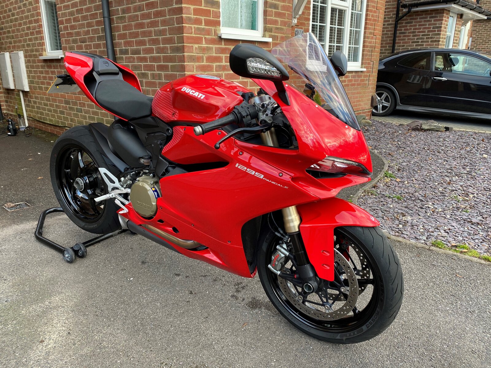

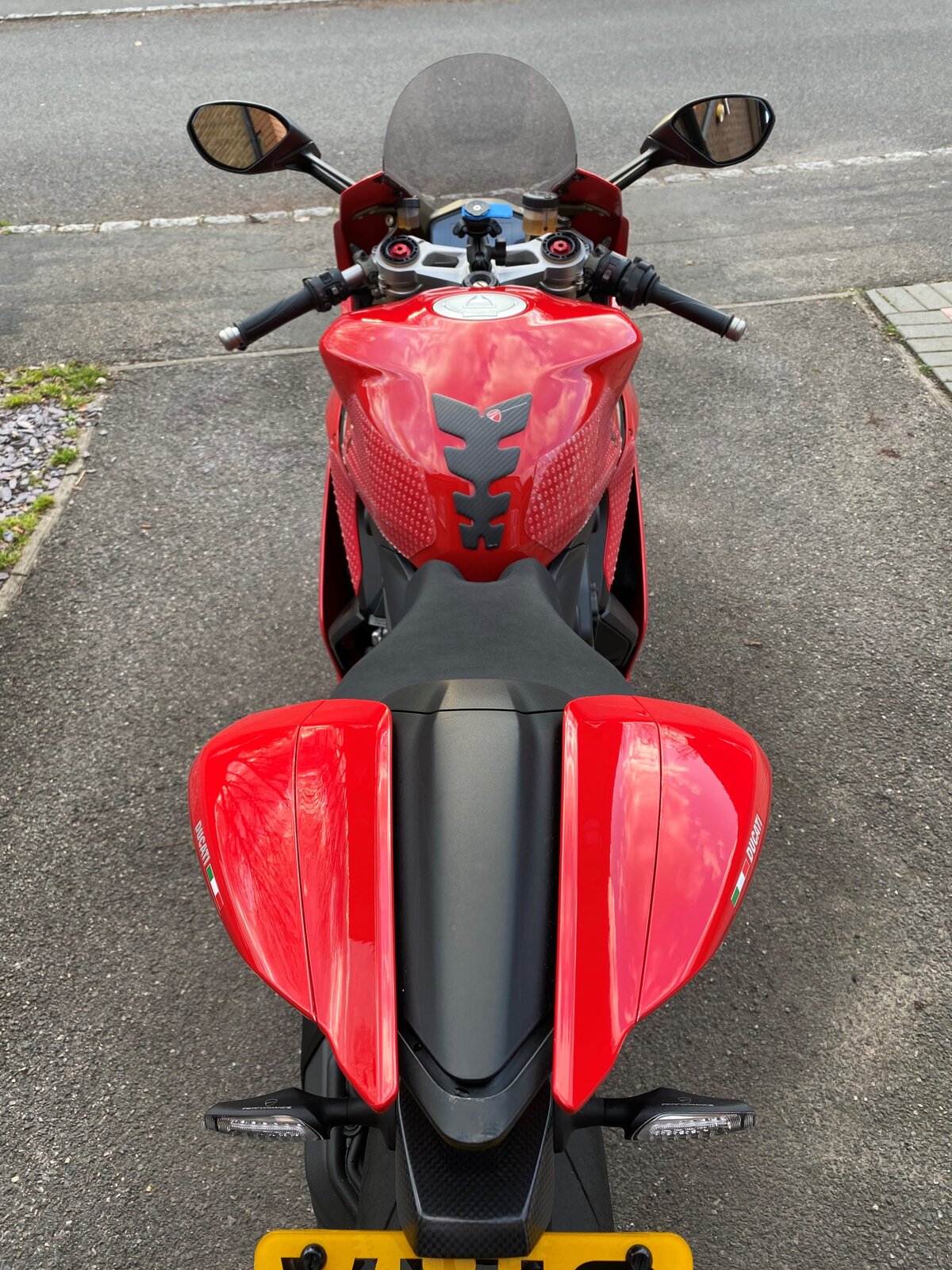

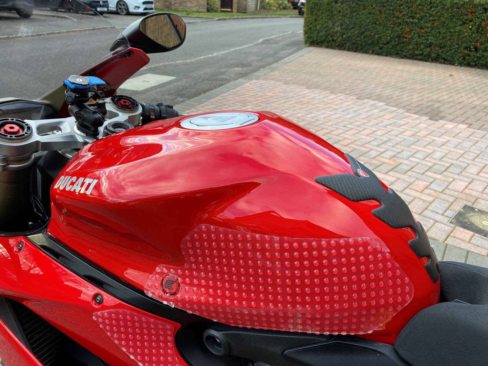

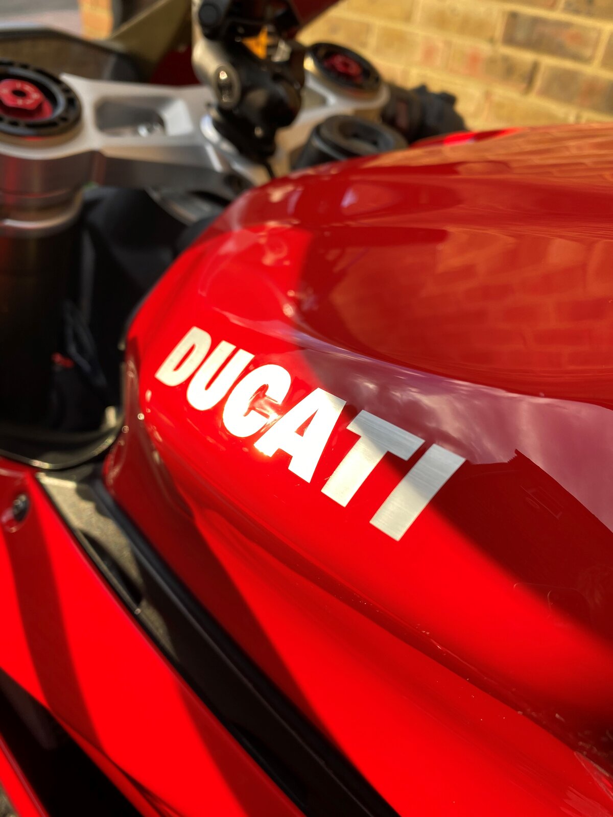

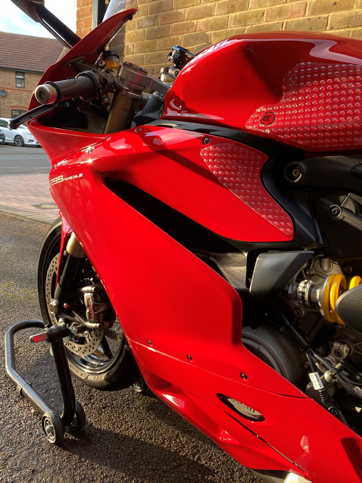

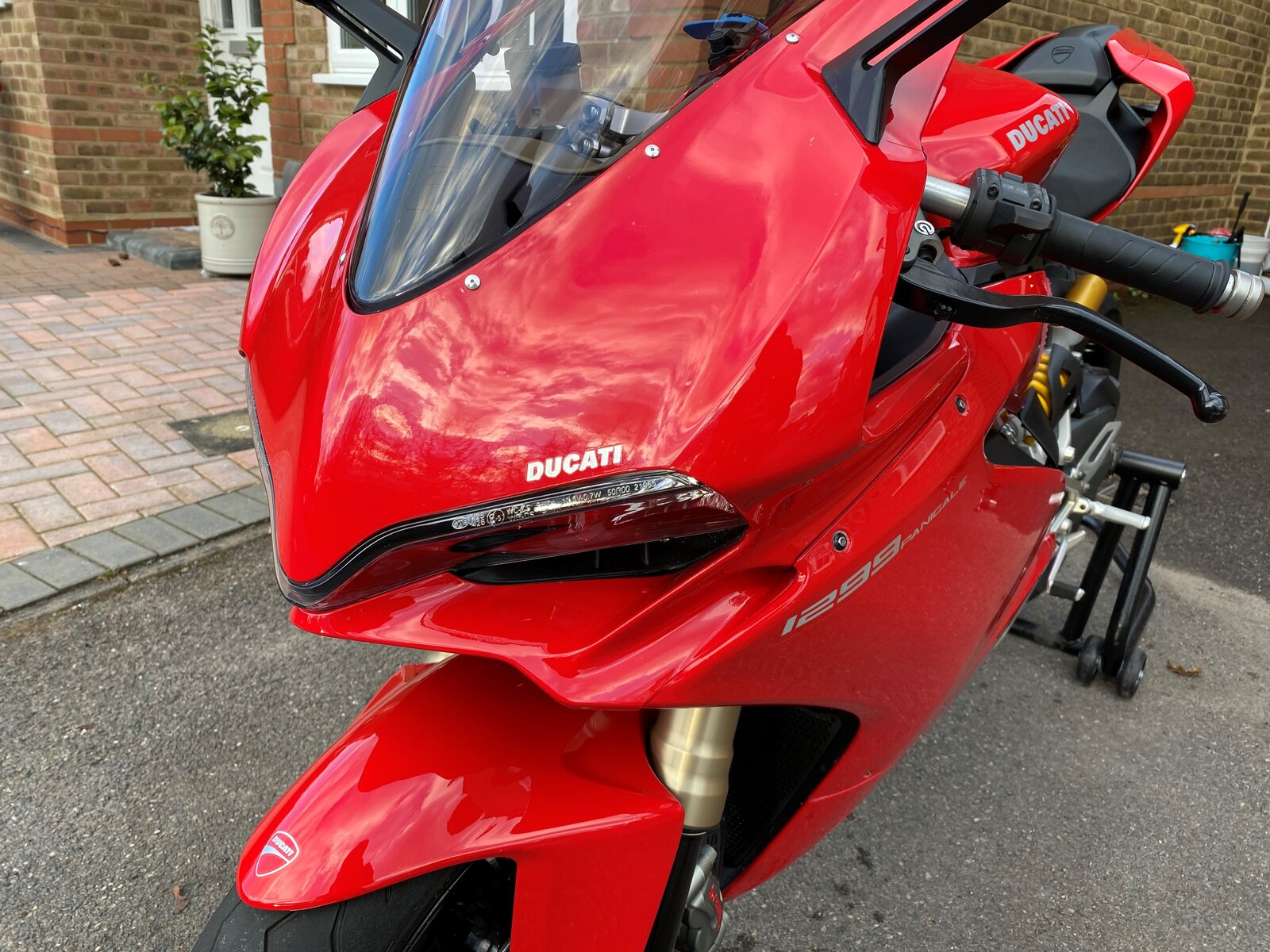

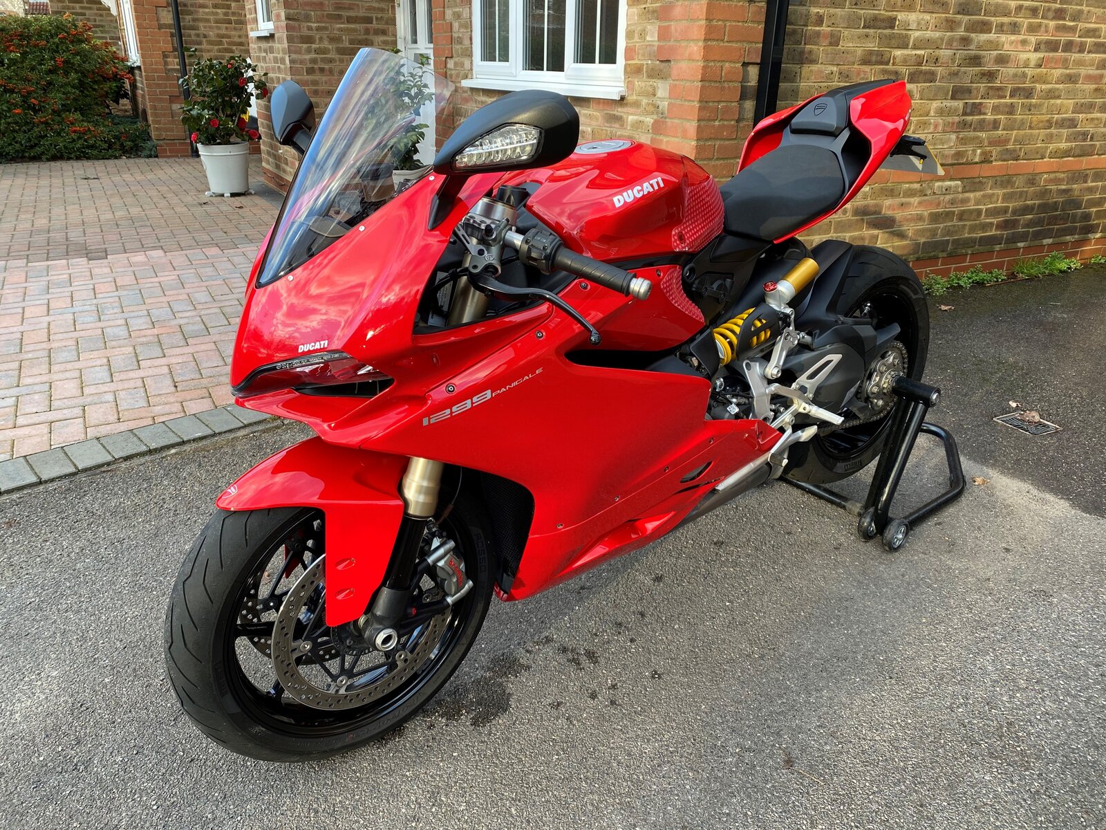

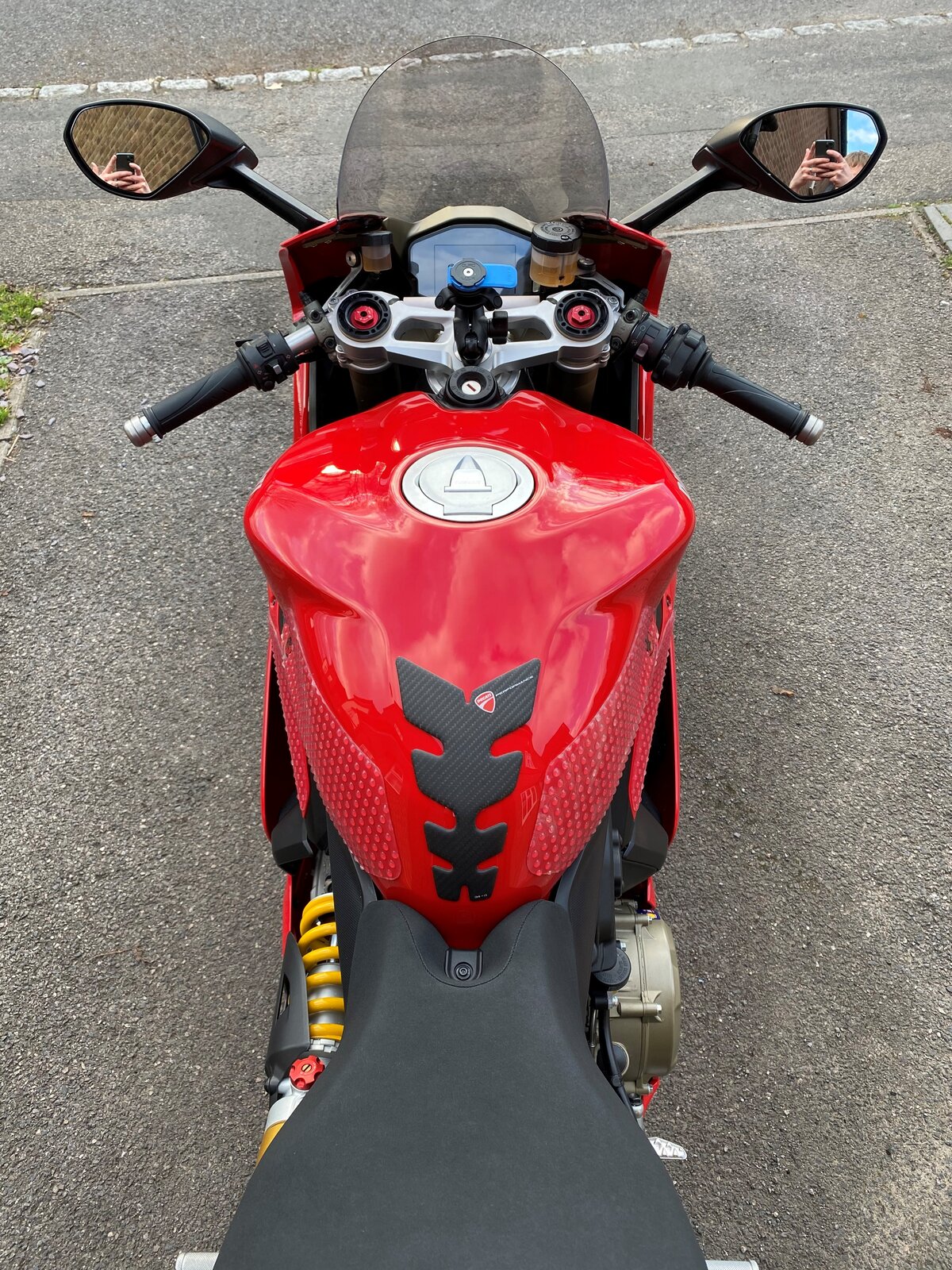

    So then all finally done and I couldn't be happier. A really huge transformation for me, the depth of the Rosso Red has really changed, the gloss level hugely improved and for me the bike now looks nothing like it's done the mileage that it has. I don't know how many hours I spent in total, but it must be 20+ but completely worth it and I loved every second of it. Here's some final after shots for you.

    I take it you would recommend the polisher you purchased.
  4. Thanks, and yes definitely recommend the polisher. More than powerful enough with seven speed settings, but you don't need higher the five really, huge selection of pads, 1" and 2" backing plates mean you can get anywhere within reason, can swap between DA and rotary (although I left as DA), extenders for better access, protector for the head so the plates won't accidentally hit something.
    Only downside is the batteries but kind of pros and cons. You get two so can swap between but you will notice a speed drop as the battery wears down so I was opting to have one on charge, at all times and swapping after around 30mins which seemed to keep it manageable. The softer pads can stall easily, but it forces you to use the right technique managing pressure, angle and speed and they stall for a reason to protect you from damaging and areas where the pad isn't flat. I have no doubt that the Rupes iBrid Nano is a better unit, but for the difference between spending £170 and £500, I'm good with this for now. Have also now used on the cars on glass black pillars, interior and then the intricate sections that were difficult to get to properly with a 3"
